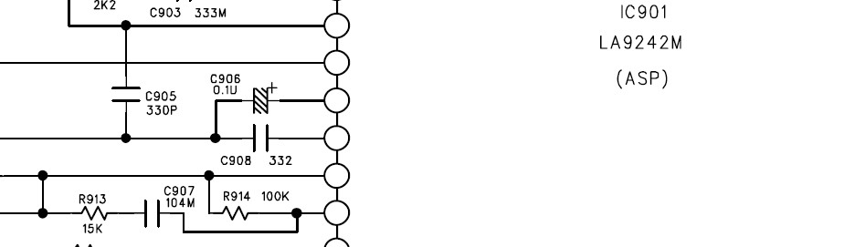

1. What does C916, C906 and C952 decouple?
2. Why is C952 removed and not replaced?

So C906 is the magic cap in the shigaclone. Has anyone tried to replace or remove its bypass, C908?
Also, is there any sound benefit in fitteing a seperate 5V regulator in additiopn to the 8V supply (i.e. seperate the supplies)?
906 is not a bypass for 906; it's a cap connected to a different pin for a different purpose.

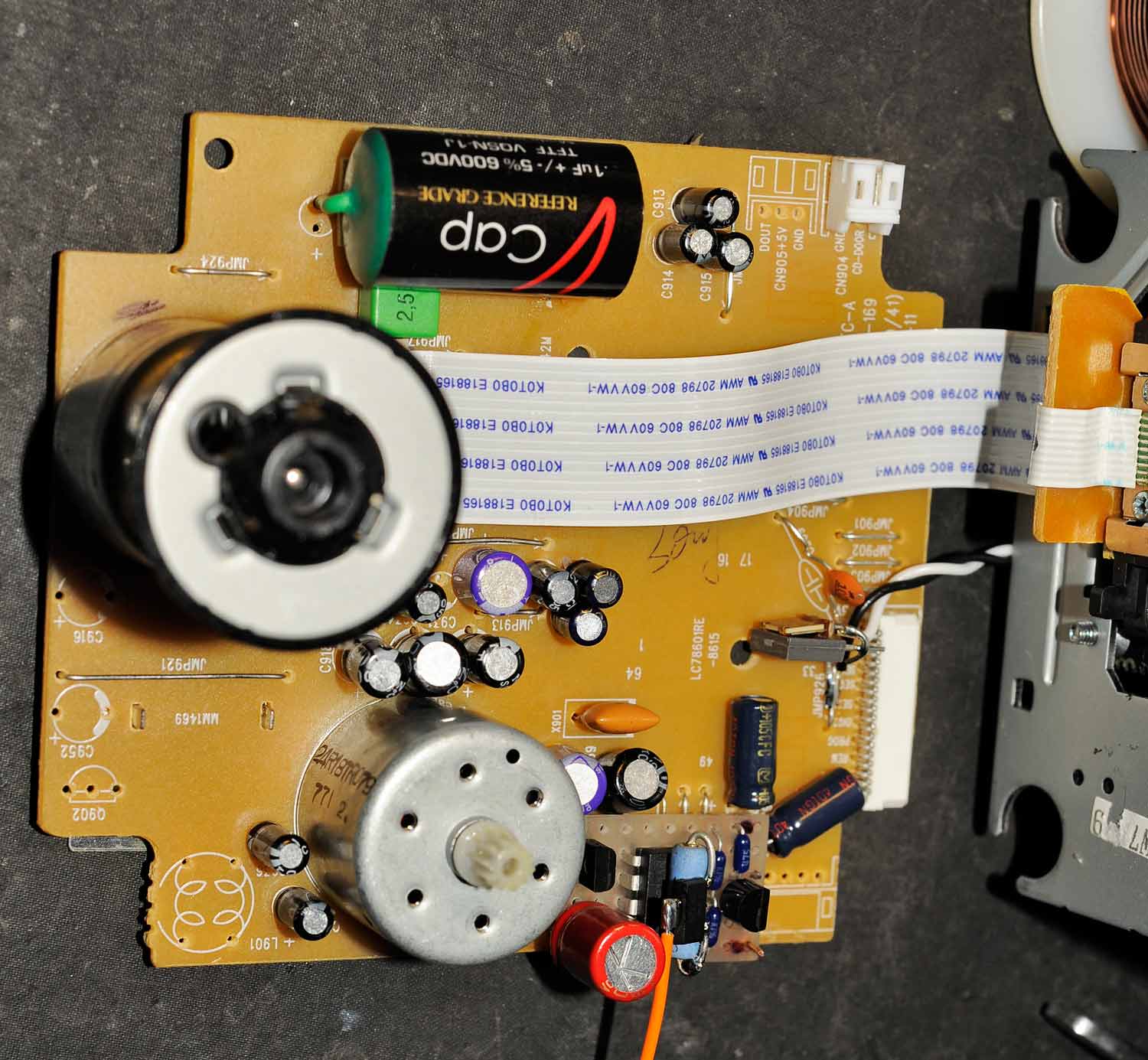

There is certainly possibility of a gain with separate 5V regulator, although LM317 I tried wasn't an improvement.
I'm presently working on a different set of mods, including discreet 5V regulator. I should be able to test it soon.
