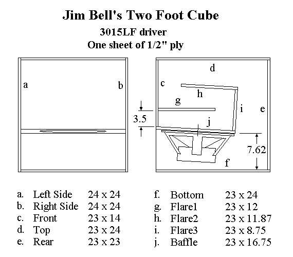

Hi JBell,
How can we use the 2 ft cube? Will 4 units be enough? The dual 10" tops look interesting. Give me some more info, and I'll try to come up with
a plan. Are you going to use the 3k piezos for tweeters?

Hi JBell,

Thanks again Jim for all the information. 4 cubes it is then. Would much rather idle 4 subs then push 2 to the limit. I like that one sheet of ply per cube. Gotcha on the high pass...How bout the hard limiting? Does the 60 volts still apply to the 3015lf's?

Ok Jim. 4 cubes it is. I like to run my subs 40 hz - 100 hz. I think I will hard limit to 60 volts with the dcx 2496 to be safe. Is the 1st layout that Don posted ok to use? It's in post #327 on page 33 of this thread.

http://www.diyaudio.com/forums/subwoofers/127908-jbells-set-four-tapped-horns-34.html#post2229599
yes, this should work. I lay things out a little different on the laps than don did, but this works very well. The only part where what I built and don's plans don't match is were I didn't quite have the baffle 'long' enough. Aka, I brought i,c panels down past the end of the baffle board j, because it is easier to construct that way. My baffle was 15", so total length was 16". Don shows it 16.75 total length -- which is correct. What I built was about .75 short, meaning the back vertical horn path was slightly larger than it should have been. In this area of the horn, I don't think fractions of an inch matter. Close to the driver they matter ALOT.
If you have a table saw, the cube cuts out REAL quick, a 24" rip, and 23" rip length wise, then cross cut side,side,top,bottom from the 24", and all the rest of the parts from the 23" You should end up with about a 12x23 left over, that I used to make braces with. A note, I lost a db at 40hz by putting in the braces -- you may want to hole saw the braces some if you want that db back. btw -- scott found the same thing -- a solid brace reduces the amount of down low you get, he had to open up his brace on the vertical back horn path, to get some 40hz back.

Don or Jim, I have another question before I make sawdust. Maybe I am missing something but won't I need more measurements on the layout? On the#327 post it had all the horn layout measured . But post #331 only has 2 measurements for the layout. It has 7.62 and 3.5.

Hi Mike,
The pieces labeled h, i and j are at right angles (square) to each other, but angled (3.2 degrees) to the box. So the 7.62 dimension
is all that is required to uniquely locate them.
