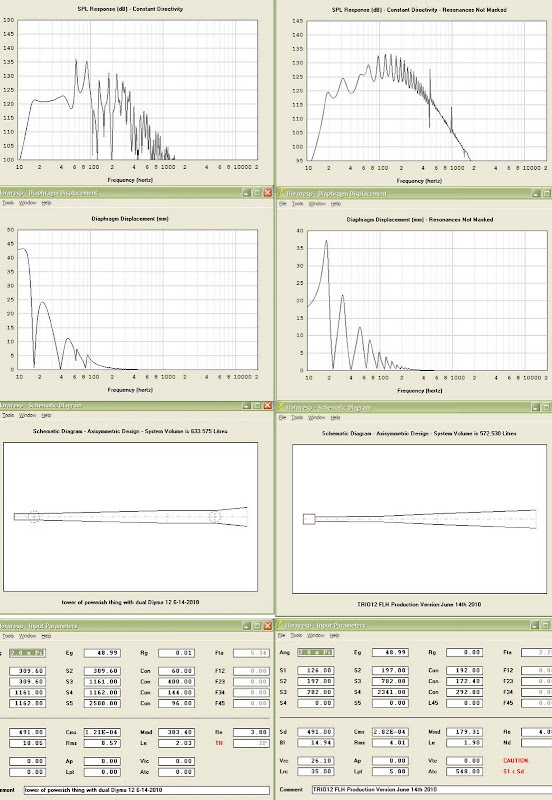

I tweeked the FLH I built in Hornresp. I added another driver and slighly changed the box in the reactance anulling chamber size and the throat about half way down.
This is getting scary. Keep in mind this is with two pcs TRIO12 and three hundred watts.
Again 1Pi loading. 2 Pi still meets the specs by the way. 120db at 17 hz.

Sorry Mark, close but no cigar 🙂
With an equal amount of power*, the Trio12 is blowing through it's physical excursion limits at 17hz. According to the sims, it's up to 35mm of xmax. That's why I had to use two woofers with a TON of xmax. A pair of Diymas has over twice as much displacement as a single Trio12. (two woofers with 23mm of xmax vs one woofer with 20mm)
Admittedly, the front loaded horn is more efficient above 30hz.
Here are the sims, using the exact same power, in 2pi loading. Note the excursion on the front-loaded horn 🙁
* 300 watts at 8ohms, or 48.99 volts

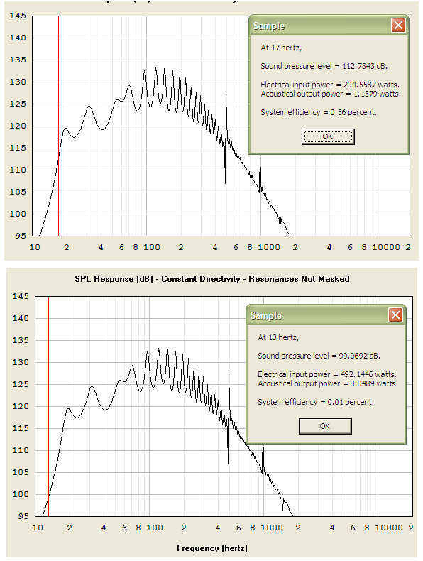

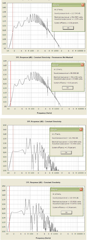

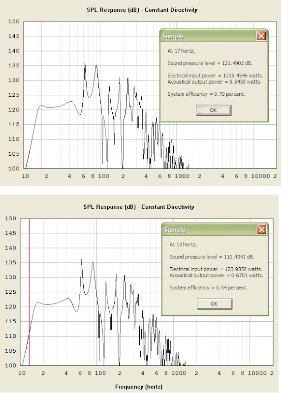

Here's a quick example of the efficiency advantages which I spoke of. I didn't believe this kind of efficiency was possible, until I built two enclosures using the exact same woofer and volume, and found that a tapped horn offered as much as 9-12dB more output on the low end.
Tapped horn at 13 and 17hz
Front loaded horn at 13 and 17hz
Again, I'm not saying the tapped horn is a "magic bullet." I'm saying that at very low frequencies it's hard to beat.
