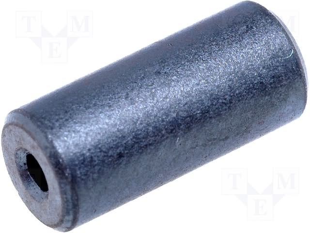

on the amplifier outputs are EMC chokes, amplifier produces any RF interference ?
What is the value of the coil ?

Output choke, much simpler and smaller, much less work.

As always, great explanation.Output choke, much simpler and smaller, much less work.
Add to the above easy solutions for input / output chokes:
3DotAudio Lug Kit for digital [or analog] data cables RF Ferrite Bead / Lug Filters
Federmann... I am intrigued... the ferrite component in post #1393.
Am I understanding correctly that you used these in place of a conventional output inductor.
I ask because I experimented with ferrite beads slipped over a 0.22 ohm resistor in series with the output from an amp and as the ferrite saturated at higher outputs distortion even on a 'scope was very obvious at HF. Something an air cored coil doesn't so.
