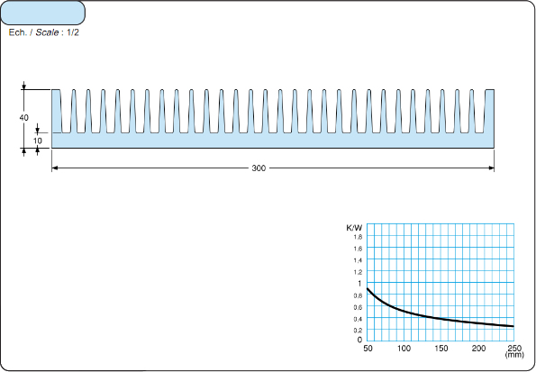

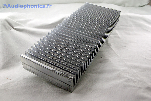

I have several heatsink in stock (all came out of industriel rubish). I have to choose between 11.81"x1.57"x4.72" with 0.39" base and 10.23"x3"x5.51" with 0.6" base. Surely the second one will have higher dissipation power, but it's less than impossible to mount three unit (heatsink+amp) of this in one conventionnel case. So would the first one be enough with 35VAC and 4 ohm load?
Here are un picture of the same as i have and specification (length is 4.72"=12cm)
Best regards Marc

Idefixes,
Your first heatsink is more than enough (~0.54C/W). I am using a smaller heatsink (~0.82C/W) and the output transistors only got to 61C (ambient was 25C) when I run the torture test for one hour (25Hz sine wave at 80V peak to peak at output driving a subwoofer). The MUR1520 diodes got very hot (80C) during the test.
- Stanley
- Stanley
Thanks staley for advice. This solution will be more comfortable to put the three chanels in one standart dimension case.
Marc
