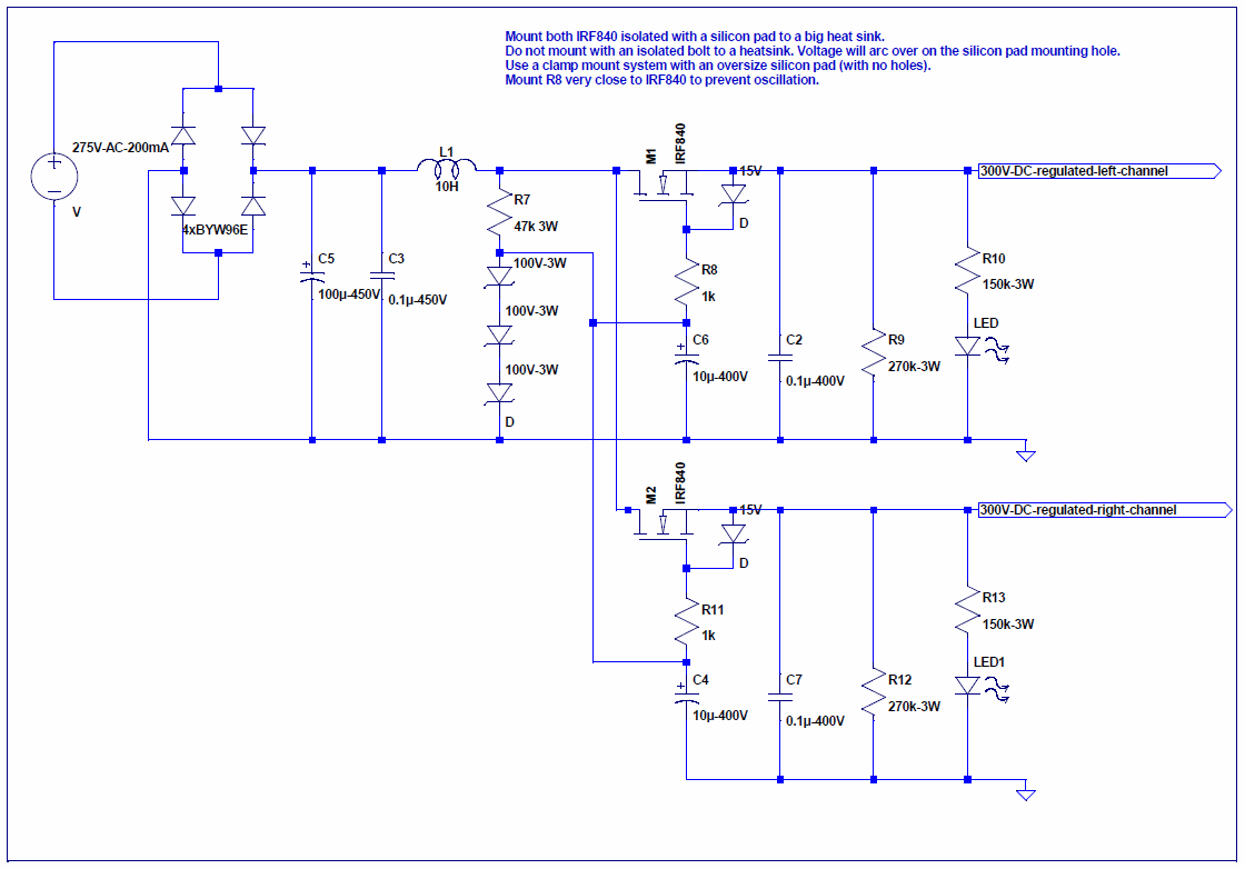

Yves has a regulated PSU amongst other things...so that may account for the heatsinks.anyone know what the enormous heatsinks are for?
