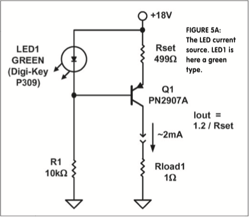

How does this floating shield work?
On this well regarded schematic the shield is connected by a resistor to the output. How is this better than tying the shield to the ground? Regarding its working mechanism the only guess i can make is that the output current saturates the shield and pushes out the emf. Also the shield now modulates with the signal so maybe thats a good thing too if we're after eliminating non signal related influences?
Also if my guess is correct then couldnt a similar method be duplicated with an amplifier pcb by using ground pour for the output trace which would flood a whole layer of pcb?

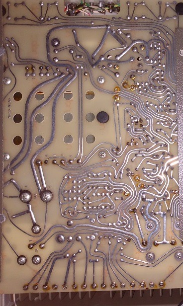

Sony CDP-XA50ES problems
its doing some things that i have not come across before, it needs to warm up a little before the logics work,once working it plays for any where from a min to hrs and it will stop and say there is no disc,
i have an idea that the servo pcb and the logics are one and the same,i will be changing out the 6 caps on this pcb, i have not worked with smd caps before so i will leave them alone for now ,so ill only do the elec type , i have not tested them off pcb but one 100uf is reading 600uf in place ,i hope this is the problem but doubt it,
what i would like to know is has any one worked on or had a similar set of problems that has been repaired in the past,
thanks
mike

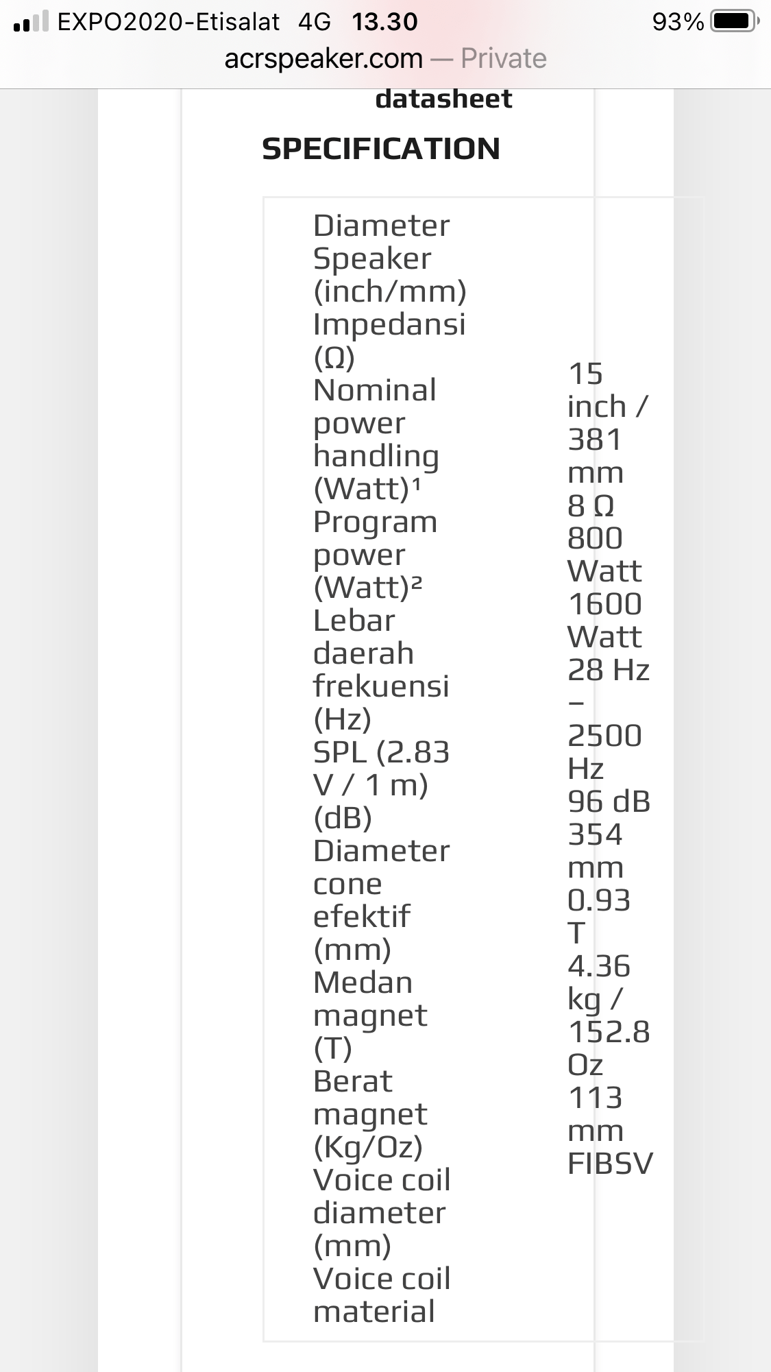

Help with weird T/S parameters.
Hello everyone, I recently bought a Kruger Matz 15" km380t11 subwoofer I found its datasheet but things are strange at first I thought it was because everything is in Polish but soon I realize that some units are completely wrong or i think so.

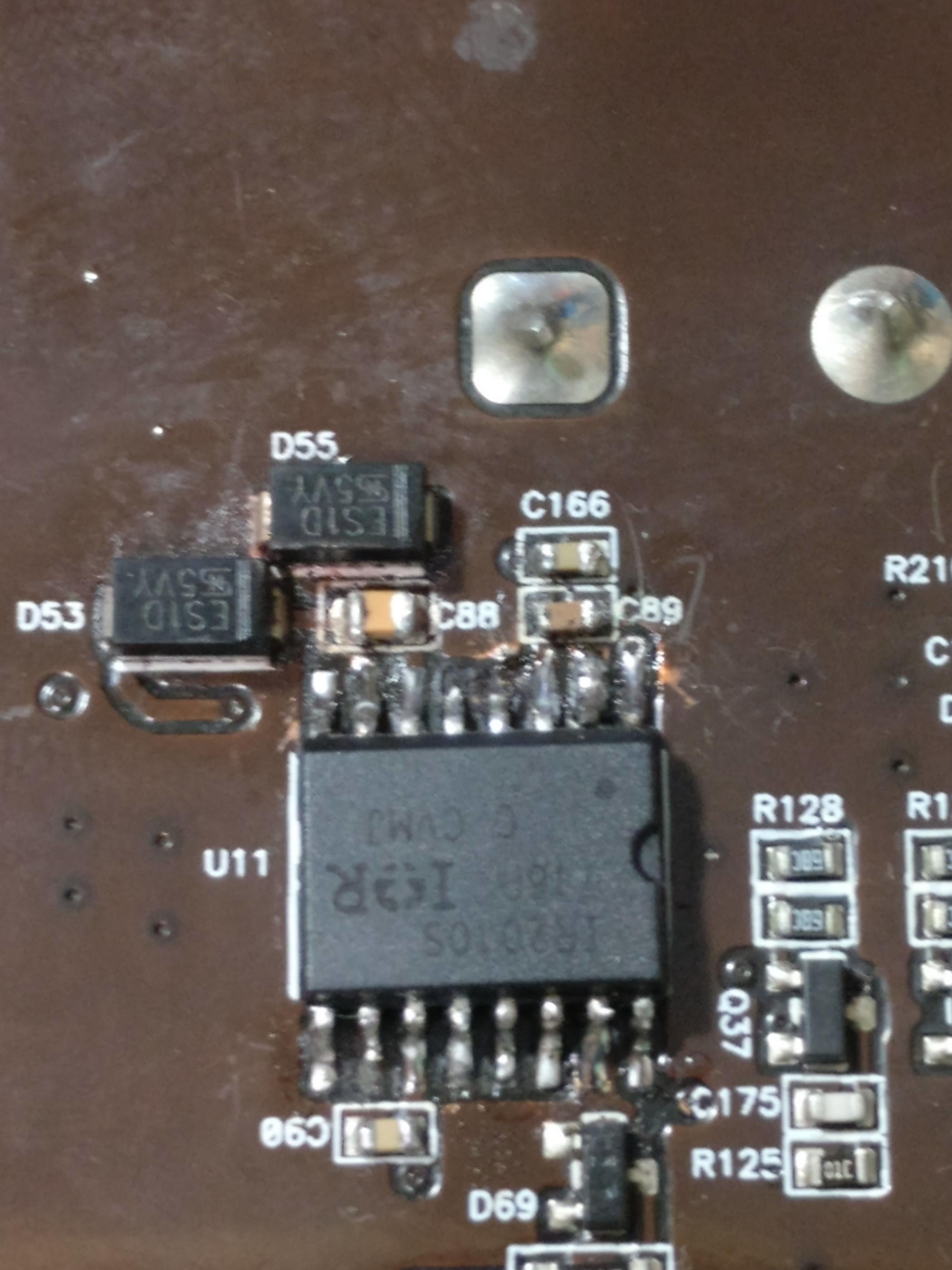

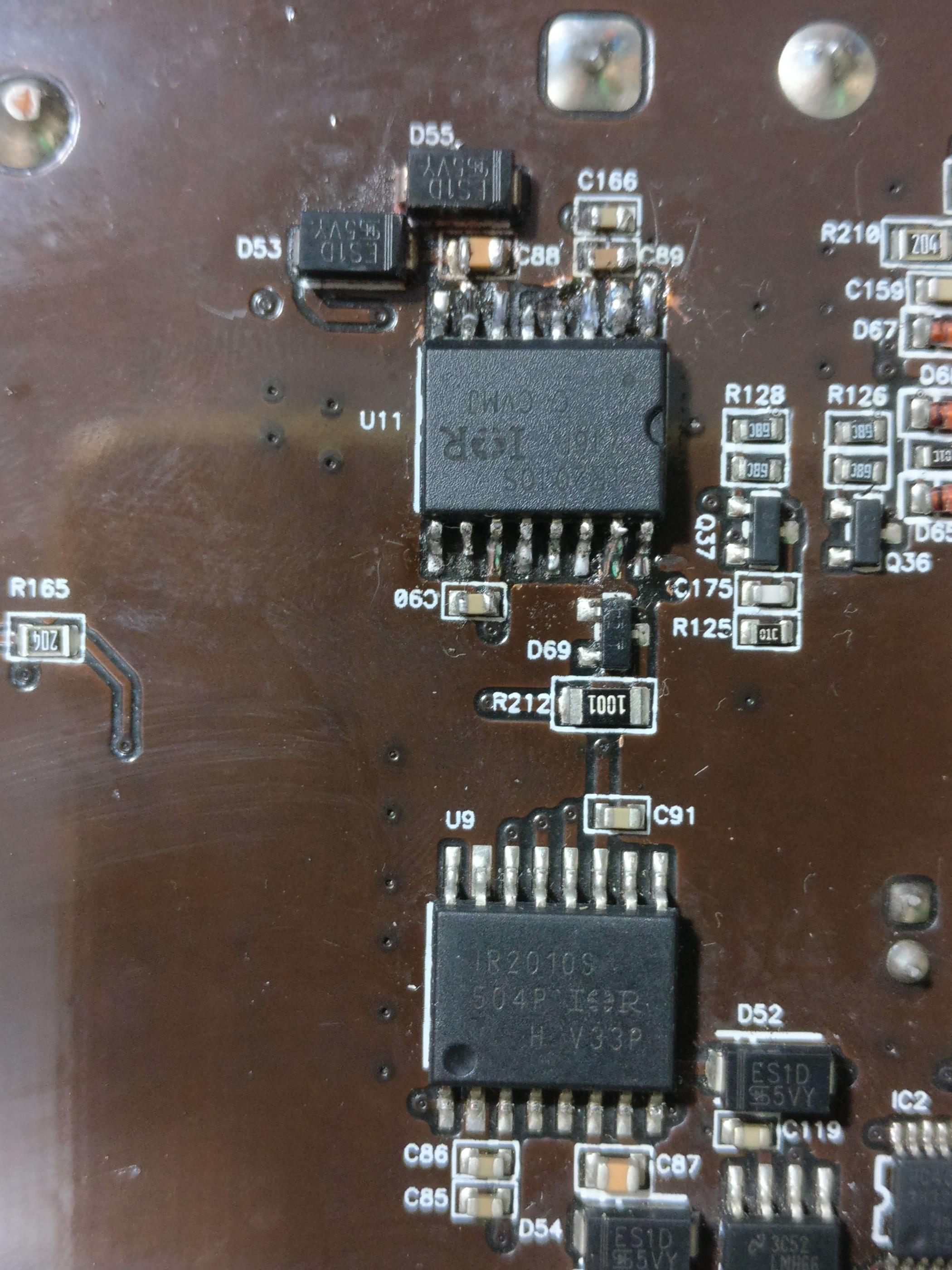

Diamond Audio D9 800.4
Amp powers but has +35v on CH2 (Which is actually labeled CH4 on the front of the amp, but CH2 on the PCB).
CH2 output transistors are measuring OK but were driven to +35vDC on base and emitters. The PNP outputs have -35v on collectors. Removed outputs.
Used process of elimination to determine Q62 (2sc1845) had an open junction from E-B off the PCB. I replaced this part with MPSA42 installed with legs 2&3 flipped to match B-C-E on the board.
I then powered the amp up and the MPSA42 overheated within seconds and same E-B off the PCB opened. Voltage on Base of outputs went to -35vDC. Also Q70 which is a 2sC2682 shorted legs 1-3.
Im not sure if the MPSA42 was the cause or if there may be something else going on with this amp. All diodes, resistors, and caps are measuring OK.

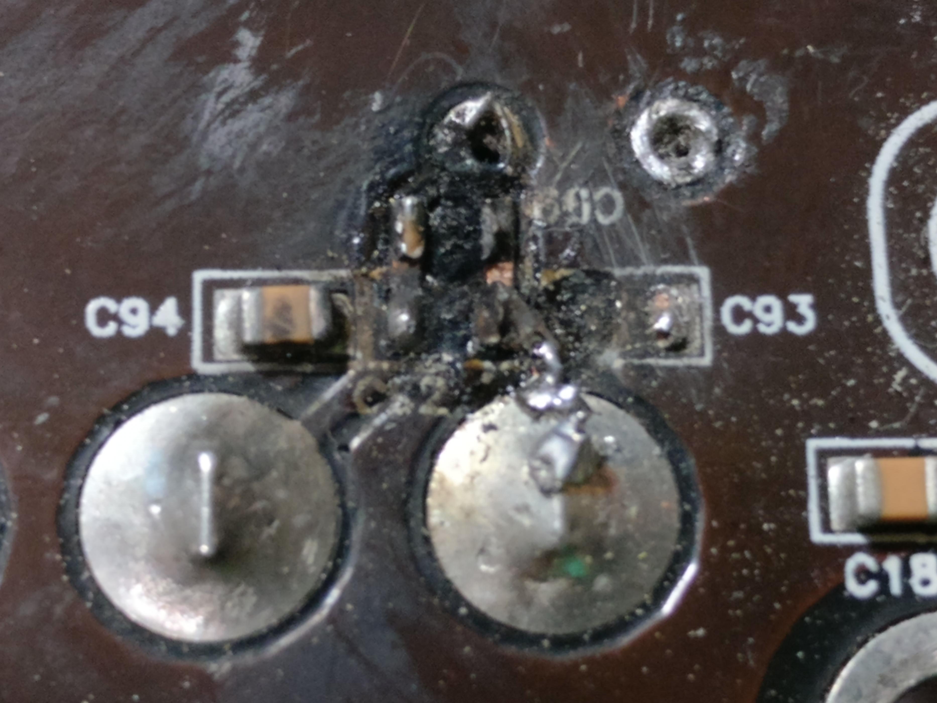

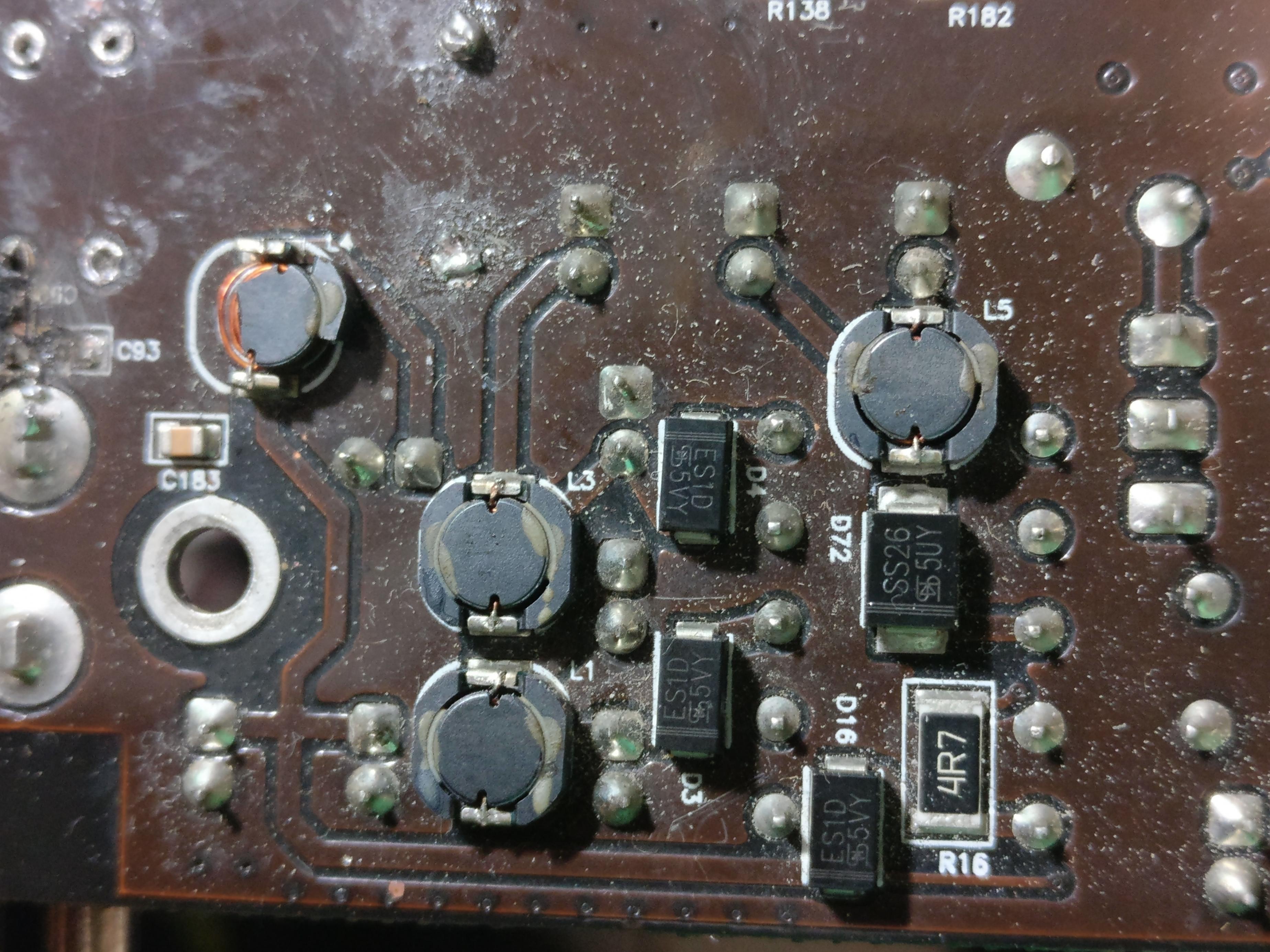

Sound Magus DK 1800 SMD transistor blown
hi,
Need help. Can anyone help me find the SMD part number of Q32 and Q33, as shown encircled red in the image of Sound MAgus DK1800 amp, They are blown as it is impossible for me to see the part number. Thanks a lot brothers in advance.

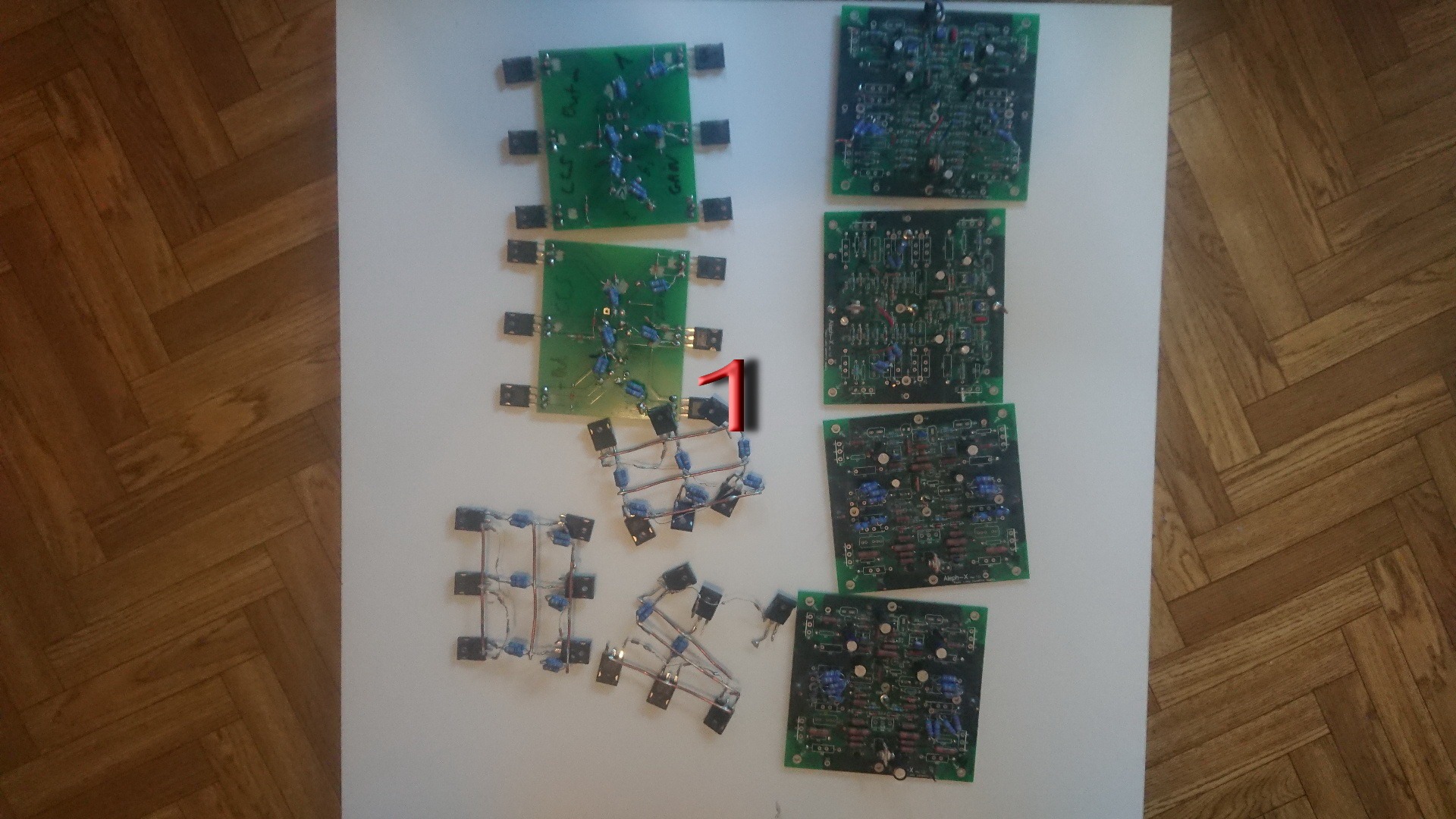

Aleph 2 Monoblocks
I went for a walk on the web and a pair of DIY Aleph 2 monoblocks followed me home. It was like I fell into a mid ‘90’s time machine.
They were originally built by a builder we all seem to know, using the Brian GT boards. Of course, one mono worked and the other did not. I tried the one that worked and it played music without much enthusiasm or substance.
I got a new pair of the Brian GT boards from a generous diyaudio member but they seemed a bit kludgy and I felt there might be better options. I also found PCBs on various sites but they all seemed a bit suspect.
With a bit of luck and a touch of persuading, I convinced rhthatcher (longtime leader of having a certain type of amp follow him home for repairs and updates) to create 2 sets of Aleph 2 Front end boards and daughter boards. Randy also provided me with the matched mosfets, matched 313s and answered many of my texts and emails as I figured things out and worked through the usual start up issues. A true Diyaudio member and gentleman.
I disassembled the non-working amp down to the chassis. I think I only kept the donut, switch and jacks, (for the moment). I got proficient at drilling and tapping 3mm threaded holes for the 24 mosfets that the two chassis use. I made a rookie builder mistake when I could not get my dimbulb tester to dim when I fired up the first amp. It turned out that my 150 watt bulb was not going to dim when your amp sucks down 300 watts. Once #1 was finished, #2 went much quicker except for that cold solder joint on the power supply.
My goal was to build a pair of amps for my vintage ADS 910 speakers. 6 ohm and not Maggies but not the easiest, either. I figured the Aleph 2 would pair nicely with the 910s. Plus, it would be nice to give a bit of love to the Aleph line and get these orphans working and set up properly.
How do they sound? First weekend impressions- they are authoritative. Neutral in color, not sweet or dry with my B1R2. Bass and pace are strong. They wake up the speakers in a way I haven’t heard them before. I’m guessing this is what the speakers must have sounded like to the ADS crew during the Design process.
Many thanks to Papa for his skill, support and generosity! And of course thanks to Randy for his skill, knowledge and patience supporting my windmill tilting Aleph 2 quest!
