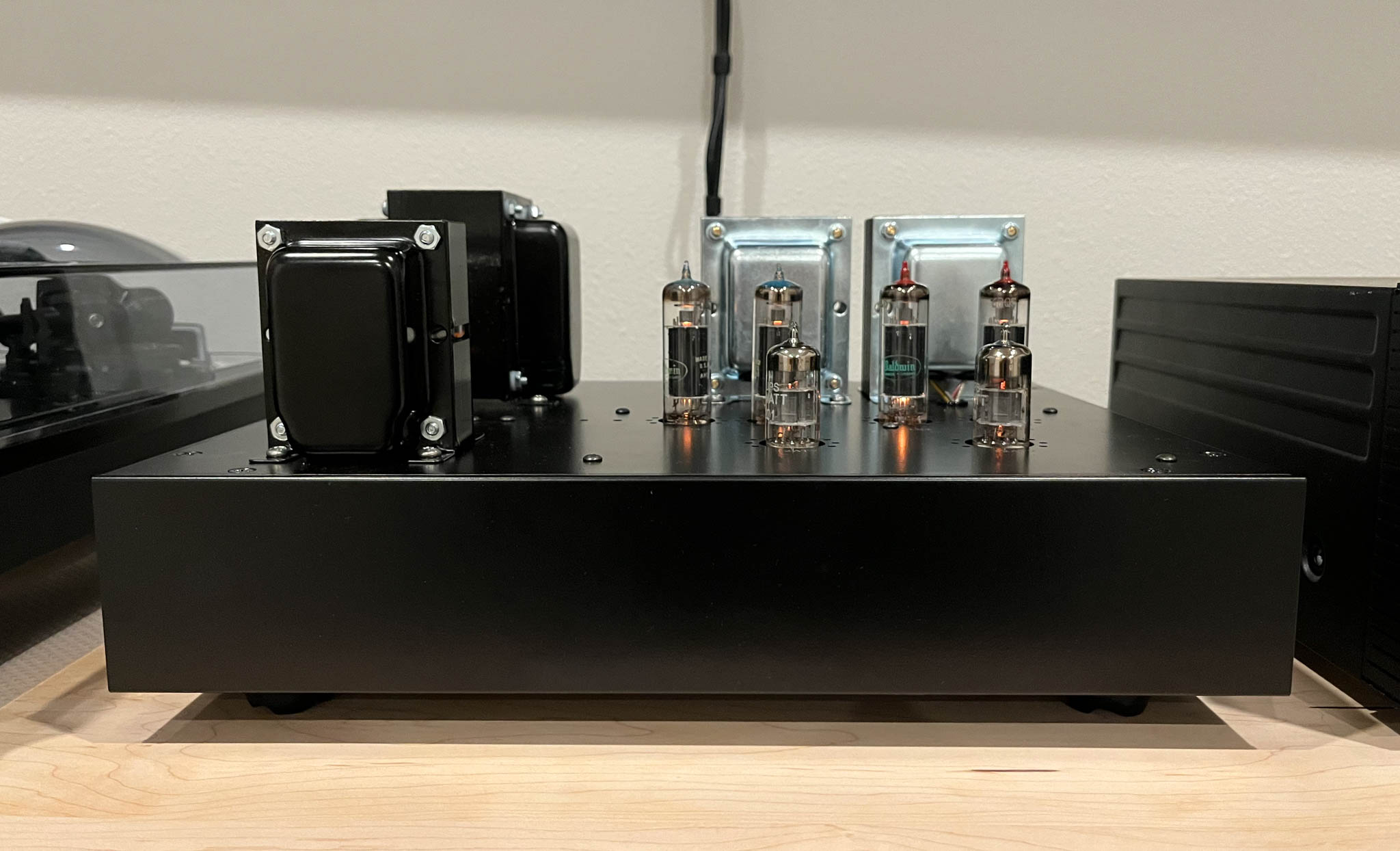

Line magnetic 211ia tube integrated amp (upgraded) - UK only
Selling my upgraded LM-211ia :
  • Purchased in January 2021, upgrades done in March 2021.
  • Point to point wiring
  • Tubes have around 800 hours
  • Miflex KPCU-01 coupling caps, KFPM-01 on the input, Mundorf Mlytic.
  • entire new rectifier with better diodes and larger caps plus some resistors changed along the way (the pictures show the upgrades probably better)
It’s equipped with Gold Lion KT-77 on the power stage and Gold Lion 12AU7/12AX7 on the input stage (over 300£ of upgrades).
Comes with original box, manual and remote control, pristine condition.
Selling as I've upgraded to a more powerful amp better suited for my speakers.
A listening session is recommended to appreciate the sound quality over the original setup (location: Sheffield, UK).
I want to avoid shipping if possible because of the weight (around 22kg) is a bit of a problem; shipping price is not included (estimated 20-30£ in UK).
Of course if you do need it shipped please contact me.
Review > http://www.acoustic-dimension.com/L...Magnetic-Audio-211IA-integrated-amplifier.htm
Full details here > https://www.line-magnetic.eu/en/pro...ificateur-intégré-push-pull-el34-2x32w-detail
The Line Magnetic integrated amplifier LM-211IA is a push pull amplifier with 4x EL34 tubes in Class AB amplification and delivers 2x15W in triode mode and 2 x 32W in ultra-linear mode.
Input stage: 2x 12AX7 and 2x 12AU7
Power stage: 4x EL34 (can be swapped with KT77 or 6CA7)
Specifications
Class AB amplifier
2x15W RMS Triode 2x32W RMS Ultra-linear
Tubes: 2x 12AX7, 2x 12AU7, 4x EL34
THD: 1% (1kHz)
Signal/Noise ratio: 88dB (Weighted A)
Frequency response: 10 à 50.000 Hz (-1.5 dB)
Sensitivity: 200 mV (Built-in Mode)
Input Impedance: 100kΩ
Asking price 900£

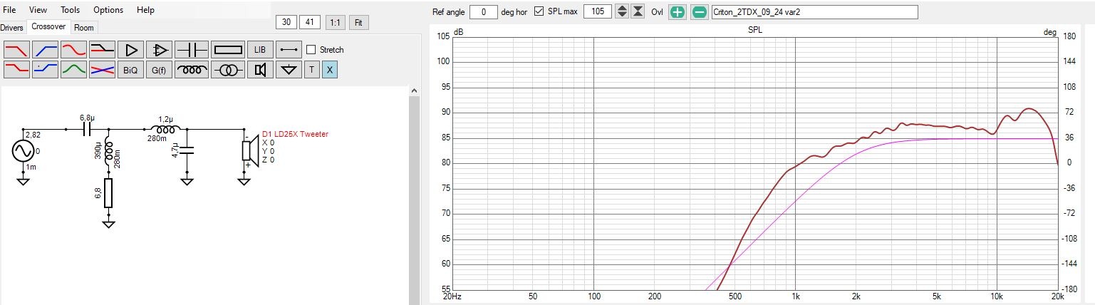

Can you help me to modify crossover points on a Balanced LXMini Crossover?
Hello all. I have scanned 10 pages of LXMini Crossover posts but I did not see any relating to my need, if I missed it I do apologize. Up until this afternoon I have been SO excited about a new build I am pulling together. The centerpiece is an active crossover that will drive 6 Purifi amps powering my beloved Spendor S100 3-way speakers. After much research, I decided that Nelson's LXMini crossover is just what I need, with an online calculator to allow me to change some resistors and caps to modify crossover points to mate with my speakers.
Then I thought "if only it could do single ended to balanced it would be perfect!" Perhaps unfortunately I found just that on the Linkwitz store website. It's called the Balanced LXMini - Sub R2, which I thought must be much the same as the LXMini +2 and the LXMini. All designed by Nelson Pass and all called LXMini. What could go wrong.
Well, today I reached the point of crossover assembly and soon realized that the crossover I have, although called LXMini, looks to be quite a different crossover. Not at all sure the LXMini online calculator will work with it to modify R and C values to work with my speakers. And if I can't adapt it to work with my speakers, it's useless. I contacted Frank at the Linkwitz store and he will not take it in return. He did say the crossover should be able to adapt for use on a 3-way speaker, but that he cannot help me.
Can anyone here help me to adapt this crossover for use? If it is like the LXMini, I should be able to change the values of a few resistors and caps and that is all it takes to modify it for my speaker's crossover points. But the boards look different, so not sure the topology is the same so that the LXMini online calculator applies. Also the component numbering is different so not sure which Rs and Cs on my board correspond to the Rs and Cs referenced by the online calculator. Here is what it looks like:

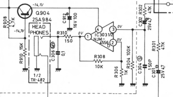

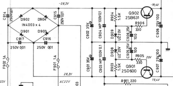

Help: Sharp SM1122 amplifier right channel has noise
This is a broken amp, it didn't work when I got it, the transformer was missing. After a period of repair and destruction (I connected the power supply wrong, fried two capacitors). I installed the correct transformer and replaced the new STK043 amplifier. Since the circuit diagram was not very understandable to me, I chose the AUX input which seemed to be the easiest to repair. Finally I got the output after the AUX input. But there was a popping sound on the right channel at first, and there was a bigger popping sound when turning the volume potentiometer. I cleaned the potentiometer and the resistance value was all right. When I turned the potentiometer, the popping sound decreased, and if I didn't turn it, it almost didn't pop, but it still appeared occasionally, and I found that there was a significant bass background noise, which was not there on the other channel. I have a signal generator and an oscilloscope, just now I input a 3V sin wave, it seems that the voltage is too high? The heat sink of the chip became very hot and there was no output signal anymore. I thought I burned it, but after cooling it down, it seemed to be fine. It was a false alarm. What can I do now?
Schematic diagram in the attachment。

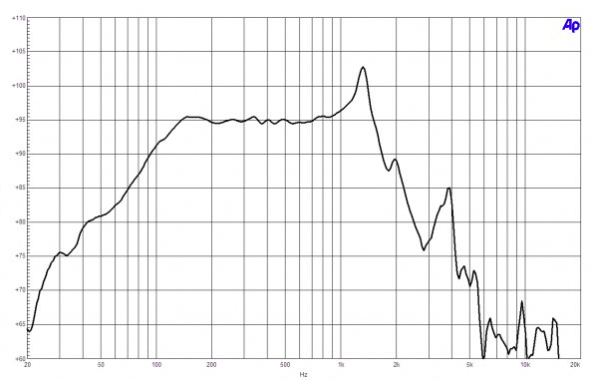

From LF Monopole to HF Dipole --> the Multi-Pattern Woofer System
I finally got around to a refresh of the pre-build modeling that was needed for a system that I hope to create this winter. The motivation follows these lines:
  • A woofer system that can operate up to ~300Hz
  • At 300Hz the response pattern should be a dipole, so it can be crossed over to a dipole midrange
  • At low frequencies, the output should be a monopole that can pressurize the room
This is achieved with two independently operated drivers located along the front-back axis of the speaker setup, and having a separation of around 30-40cm. A filter network causes phase/delay changes that result in a gradual pattern change as a function of frequency.
The attached plot shows how the pattern changes from a dipole at HF through hypercardiod and cardioid before reaching monopole at LF. I have seen this also done another way using two drivers: one is a monopole (for LF) and the other a dipole positioned directly above it. There is some overlap to their passbands in wihch a cardioid pattern is generated, but of course I want to do something different, right? Actually, the solution I am proposing has the advantage that you do not need to have a stack of two drivers, one on top of each other, to achieve the effect. Instead the system can be created using a low-slung box with both drivers firing upwards or front and back, as long as the separation between them remains at the correct distance. Also, both drivers can be used to generate LF output in my setup.
The only quirk is that, at frequencies below 100Hz, the outputs are in relative phase, but offset by one cycle. It will be interesting to see how that sounds. Based on what I know about group delay, I am skeptical that this will sound any different than a single source of the same SPL but hearing is believing...

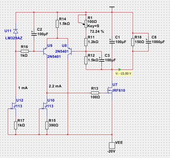

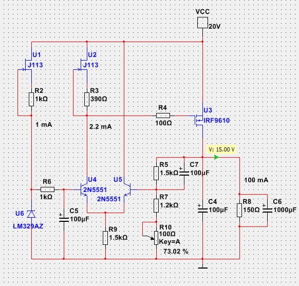

Firstwatt circuit simulation
I am trying to use a simple online circuit simulator to help me understand the inner workings of the various FW designs. Figured I’d start with a simple design so starting with the F5 and specifically the simplified schematic of the F5 from Nelson’s intro to the design on page 10 here.
Something isn’t quite working right, would appreciate if anyone could help me out. I believe the schematic is editable by others.
https://everycircuit.com/circuit/6136255276122112

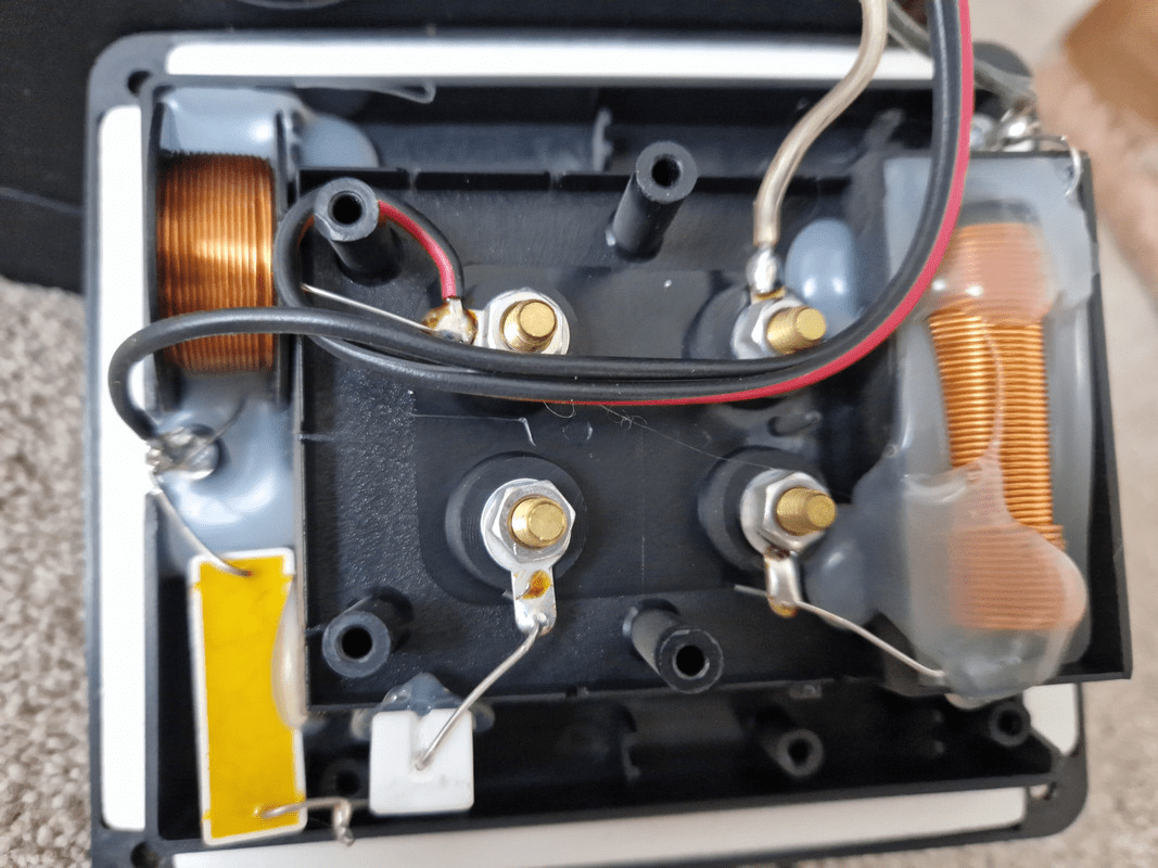

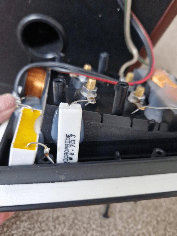

Onkyo speaker question
I got a pair of Onkyo SKF-550F speakers for just under $20 today.
They work, however I wanted to install a proper 12 dB/octave two way crossover int hem to improve the sound.
The cap in series with the tweeter is 1.5uF and just as I suspected either the crossover is much higher than the 4kHz the manual lists or they used the cap value to lower the tweeter output by crossing it over real high either to better match it with the woofers or to reduce the increase in output near the crossover frequency caused by no inductor in series with the woofer.
I also found using a sinewave that the speaker seemed to play lower if the port was covered.
The specs of the speakers are as follows:
Impedance 8 ohms
Maximum input power 130 watts, but the individual woofers have 25 watts stamped on them so max power I'd feed them is 50 watts.
SPL 87.5dB 1W/m
Frequency response 60Hz-50kHz. There's no way these are only 3dB down at 60Hz unless mounting on the wall helps or the port is closed off.
Here's the woofers in series not in the cabinet.
Here's one woofer not int he cabinet
Here's the tweeter by itself.
What is the impedance of the woofers and tweeter?
The DATS V3 provides Re, minimum impedance and maximum impedance, but not nominal impedance.
In the past I've used Re for crossovers when the impedance was not known and that seemed to work ok.
The plan is to build a quick and dirty 6dB/octave crossover at 4.5kHz just to see if the tweeter is too loud. If it is not then I'll order or build a proper 12 dB/octave crossover.

Diy Speaker SB16PFCR and SB26ADC 2 way floorstanding, Help with Crossover and Measurements ...
Hello..
My name is Ryan from Indonesia.
First of all, i have soooo little experience about diy loudspeaker, i'm not a professional and i have limited tools and resources.. and my english is not good either
I'm Currently building floorstanding speaker with the woofer SB16PFCR25-08 And tweeter SB26ADC-C0004
The drivers are chosen because it is affordable and produced in my country indonesia, so it is an advantage for me..
I built the cabinet with MDF
The cabinet front baffle width is 20cm, with 35cm depth and 85cm tall.
The baffle thickness is 36mm (Double 18mm MDF)

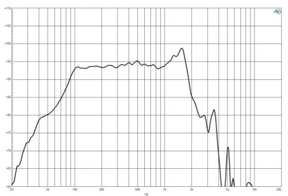

I have measure the raw frequency response of the drivers, measurements done with omni mic (not calibrated) i'm aware that it is not 100% accurate, but i think i may get the idea with it.
The measurements are 4ms gated and is done in my living room, the speakers was on top of a chair
The pink one is the woofer
The green one is the tweeter
Without any crossover
The issue is 3khz dip on the tweeter response..
What cause this?
Is this because of the tweeter diffraction? The tweeter is not flush mounted, but the side baffle are rounded..
Is the baffle thickness of the tweeter affect this? because it is 36mm i have no idea whether it is too thick or not.. and the tweeter cabinet is separated from the woofer.
Thank you for responding. I really need help because i don't have anyone near me to be ask this kind of questions...

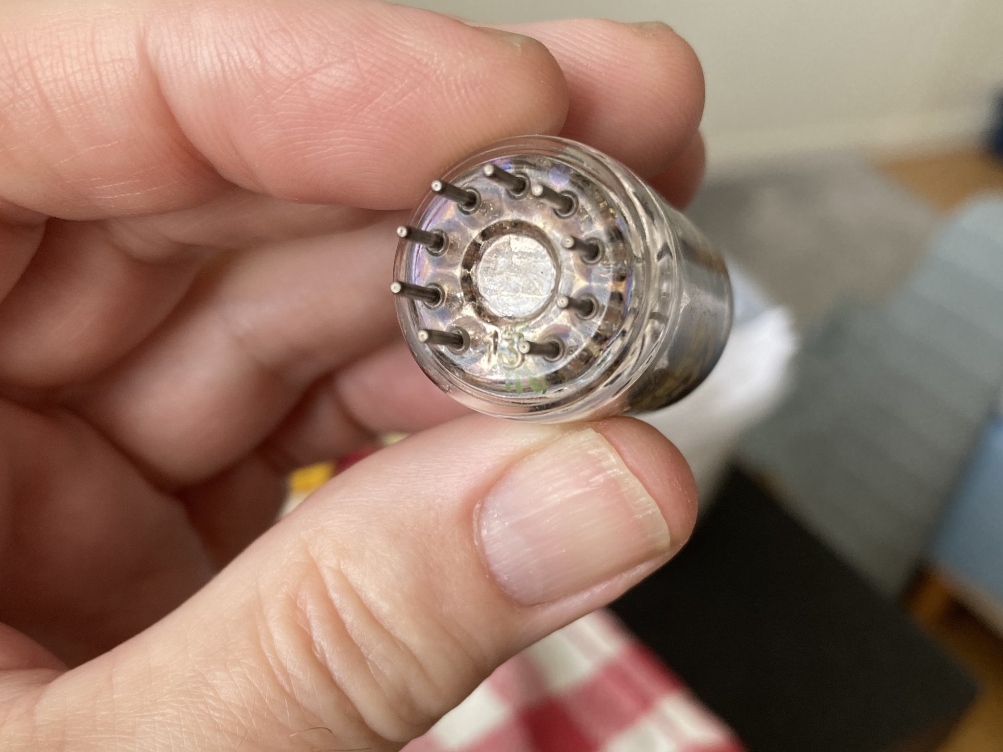

For Sale Valvo EL8 Beam Pentode tubes
A rare opportunity, 50pieces EL8 pentode tubes VALVO August 1951. Manufactured by Valvo in Hamburg-Lokstedt. These tubes are small pentode power tubes. Can be used very well as drivers for the AD1 or 300B. One of the best power pentode tubes that Valvo has ever produced. Asking 11€ / piece min Order 10 pieces
https://www.jogis-roehrenbude.de/Leserbriefe/Marcus Gedanitz-300B-Amp/300B-Beschreibung.htm
Prices are exclusive of PayPal and shipping costs. Shipping from Germany. PayPal is accepted, the additional 5% PayPal fee is borne by the buyer. Or payment via PayPal/friend and only the shipping costs apply. Outside the EU they vary depending on the country. If you are interested, send me a PM.

TDA1305 with USB/I2S input I need advice
Hi All
I want to try to make a DIY DAC on TDA1305 (I have the original desoldered from a damaged recorder)
I want to make a DAC with I2S input (I have two USB cards to I2S - one with a 12MHz PCM2706 clock, the other is a Chinese XMOS)
I have a question about the TDA1305 pin configuration
Tell me if I see it correctly (for simplicity - I treat all +5V supply voltages as one, GND the same)
PIN n° function dataseet connection
pin1 +V +V
pin2 gnd gnd
pin 3 test1 to gnd
pin4 bck to USB/i2S
pin5 ws to USB/i2S
pin6 data to USB/i2S
pin7 CLKS1 to gnd
pin8 CLKS2 to gnd
pin9 gnd to gnd
pin10 +V +V
pin11 test 2 to gnd
pin12 SYCCKLI to USB/i2S
pin13 NC NC( not connected)
pin14 NC NC
pin15 gnd to gnd
pin16 SYSCLKO NC
pin17 DEEM1 to gnd
pin18 DEEM2 to gnd
pin19 MUSB to +V
pin20 DSMB to +V
pin21 ATSB to +V
pin22 out see dataseet
pin23 out see dataseet
pin24 out see dataseet
pin25 out see dataseet
pin26 Vref via C to gnd see dataseet
pin27 gnd to gnd
pin28 +V +V
Is this configuration correct?
Which interface to use? 12MHz or 24Mhz (xmos)
Attached is the schematic and datasheet
Thanks for your help

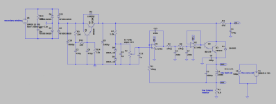

An UN-clipping indicator?
Weird title, but couldn't think of what else to call it. I want to build a clipping indicator that works in reverse of typical: instead of turning an LED on when clipping, it would turn the LED off. Don't even know if it's been done already.
I have a clipping circuit I've used a few times before, and hoping to modify it to work in this reverse function, I just don't know enough about electronics to do it.
I'm starting with the "Bilateral Clipping Indicator" circuit, published in The Audio Amateur 3/73 issue (article scan attached below):
I know this works for a single polarity:
But I don't know how (or if) that scheme can be applied to both polarities of the original circuit "bilateral" ness.
Can anyone help with tips and advice, steer me in the right direction, or even a better circuit than the one I'm working with?
Thanks!
