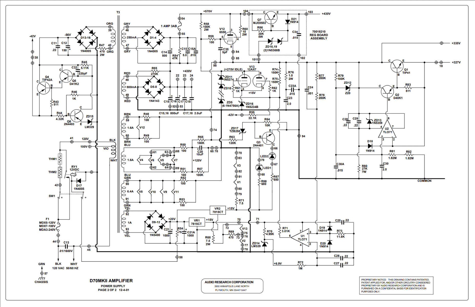

Some might call me a glutton for punishment, but I have taken on one of these that’s sickly and that has even had modification attempts! I’m nearly at the point of digging into the power supply. It’s great to have schematics available online, but I’m struggling with identifying ZD12. It‘s labelled as a ZD20, but I’m clueless at exactly what that specific Zener is. Would anyone know?
Update: I’m ploughing my way through the amp and thus far, have cleaned up a low level hum by simply replacing all the 40 year old electrolytics and as well, replacing some of the semiconductors in the screen regulator. Also, I replaced all the semiconductors on the 430V driver regulator board. All voltage measurements seem to be in line now and I can set all the adjustments to within the ARC instructions.

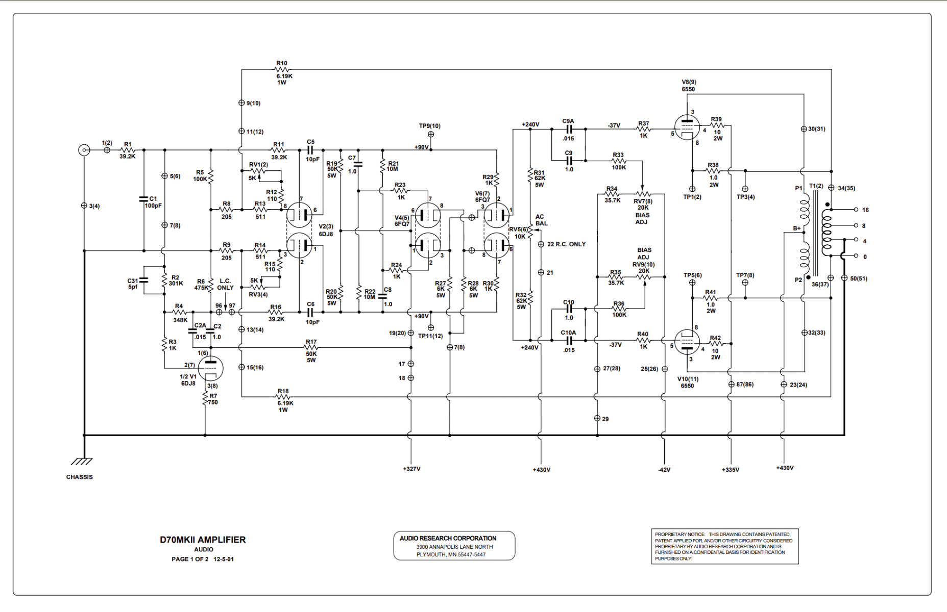

I’m still plagued with a substantial amount of noise that shows up as about 1.5 mV of HF hash on the outputs of both channels with the inputs shorted. Looking at the regulator outputs with a scope shows no major noise present.
If anyone has any thoughts or ideas, feel free to chime in.

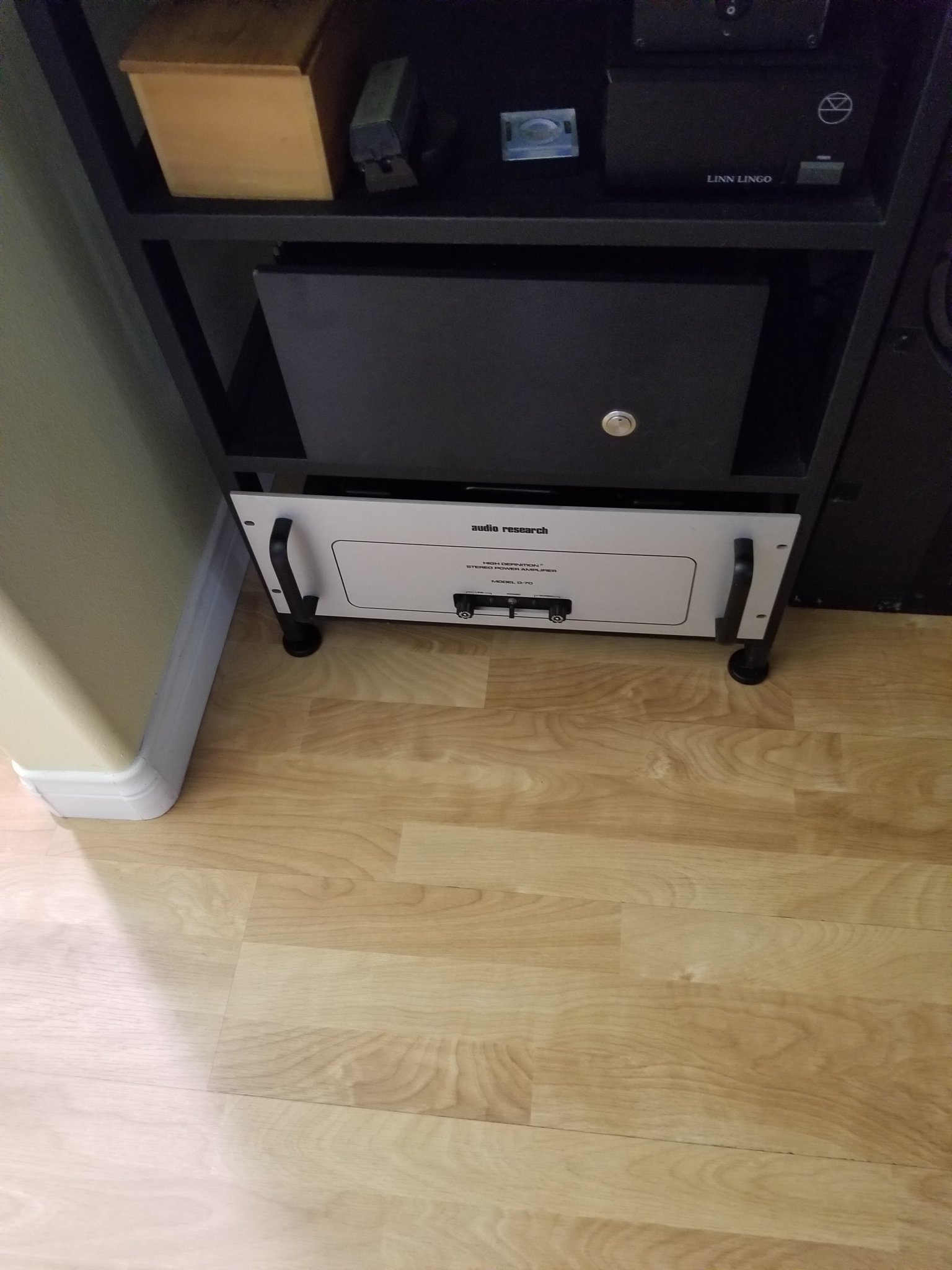

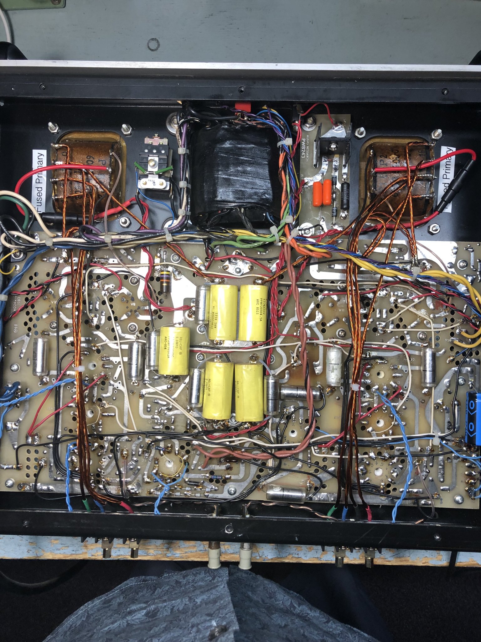

Besides the "improvements"... where did it live? Mine was indoors, in my living room, and before that in my friend's living room ( for four years )... it looks clean. The only thing we really had to do was replace the power cord because they disintegrate over time ( become really sticky )...
I should open it up and take some pictures one of these days.
