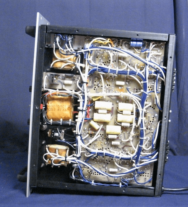

Good thing they put those labels on and taped up the power transformer. The underside of the PCB also seems to be missing some capacitors.

This is what the underside of an original D70 MKII looks like, care of the ARC Database. The wiring shown is identical to mine;
I have been servicing Audio Research Corporation products since the 1970's, so I remember them as they were originally built.

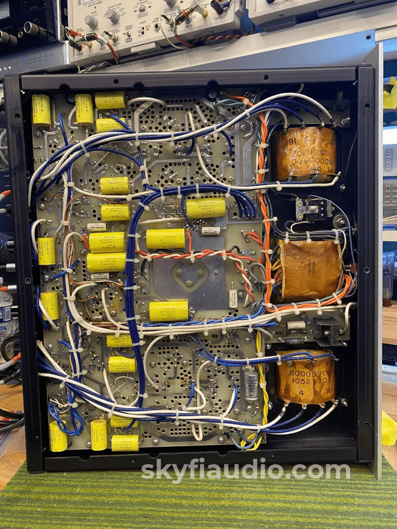

Here's a pic of a D115 MKII underside, also original, care of Ski Fi audio. Never measured it, but I gotta tell ya, that wire is heavy gauge, and they used the same stuff for the inputs as well;
EDIT; Note all of those lovely Rel-Caps. These were always my capacitor of choice.

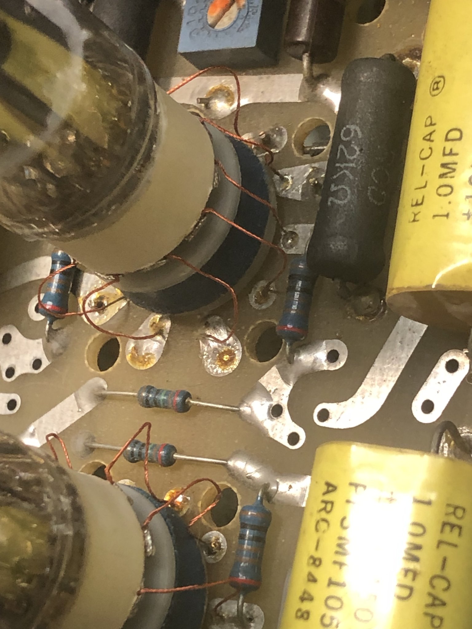

Today I replaced all semiconductors within the 327V regulator. It now measures spot-on at the correct voltage. Continue to see the noise at the output, however.
Okay now that all the DC voltages have been stabilized and measure correctly, I have been able to zero in on the remaining issue. It appears the source of the noise is an oscillating V13, the 12AX7. Audioking have you encountered this in your travels with these amps?
I note that mine has RF chokes in series with the cathodes that do not appear on the schematic. Also, I think there is an error on the schematic as the cathode voltage shows as 15 Volts, but there is in fact, a 6.2V zener tied to ground.
The Zener is correct. Don't forget, that portion of the circuit is fed from a stacked supply.
RF chokes from which cathodes to ground? Other than the transformers and the relay, there are no other coils used in this amplifier.
Unfortunately, your amp looks like it's been subjected to some serious mucking about. You're going to have to get some very good closeup pics of original units and start comparing what's what on your board.
There are a lot of low value capacitors throughout the power supplies, and they are all critical and necessary for proper operation. I'm guessing some will be missing.

Thanks, yes - it has been seriously mucked with. The chokes are connected in series with each of the cathodes of V13, the 12AX7.
Correction: My bad, the chokes are in series with the grids, not the cathodes!

I can't imagine that an extra inch of wire from the socket would induce instability.
At this point, I believe that you are going to have to invest a significant amount of time and effort analyzing this unit and putting everything back as designed. Trying to troubleshoot this amplifier "as is" will be nothing more than a very frustrating exercise in futility. You need to go over everything.

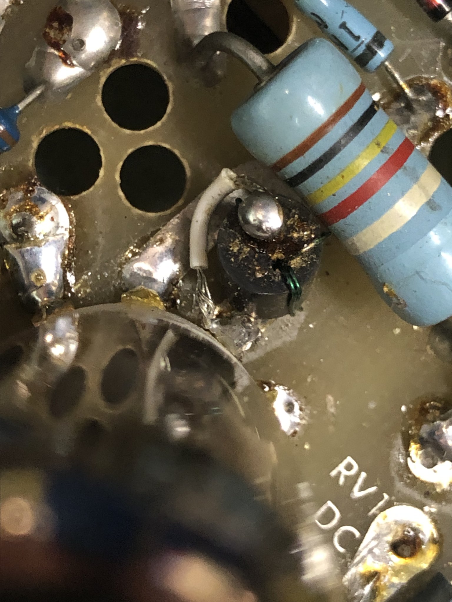

One of the areas that has proven to be problematic with this era of ARC power amps are the bias and balance trimmers. Like any control that doesn't see much action, they go noisy over time. The AC balance pots are usually the culprits due to the higher current flow.
I have occasionally been able to clean them (You can probe them with a signal tracer or scope to find the noisy one) but replacement is always my preferred course of action. Not everybody wants to open their wallet that far though...
