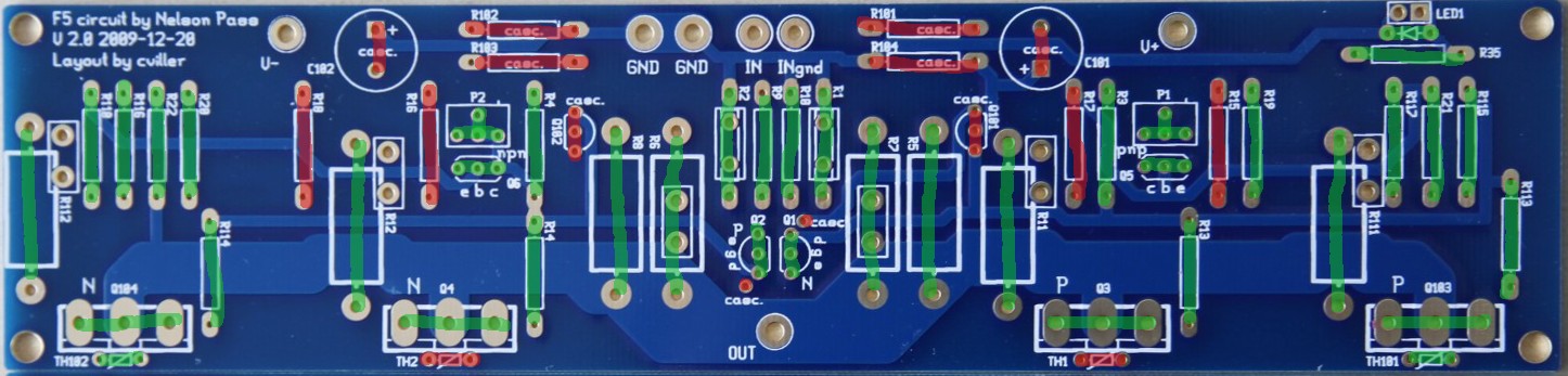

PCB
Here is a picture of the pcb.
Click image for larger version

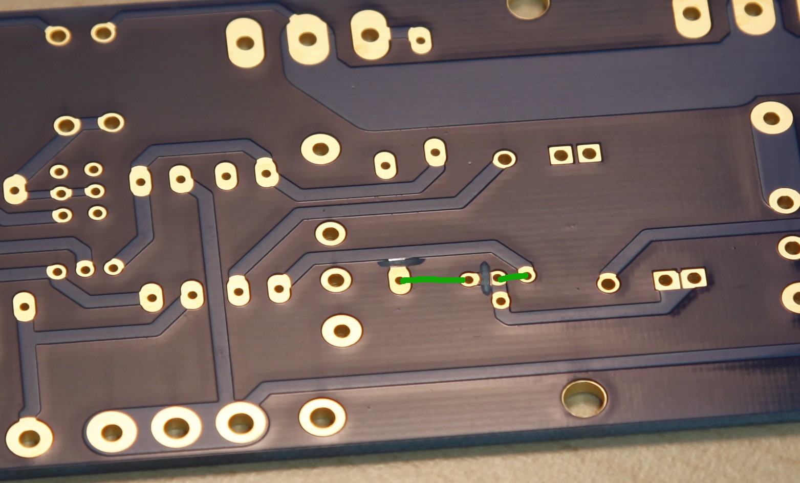

Errata
There is a trace error around R22. I have cut the traces on most of the boards I have sent - and the rest of the batch will be cut before I send them out.
These are the cuts which needs to be made:
And the green lines indicate where a connection must be made:
This can be done simply by having the leg of R22 go through the hole and to the side.

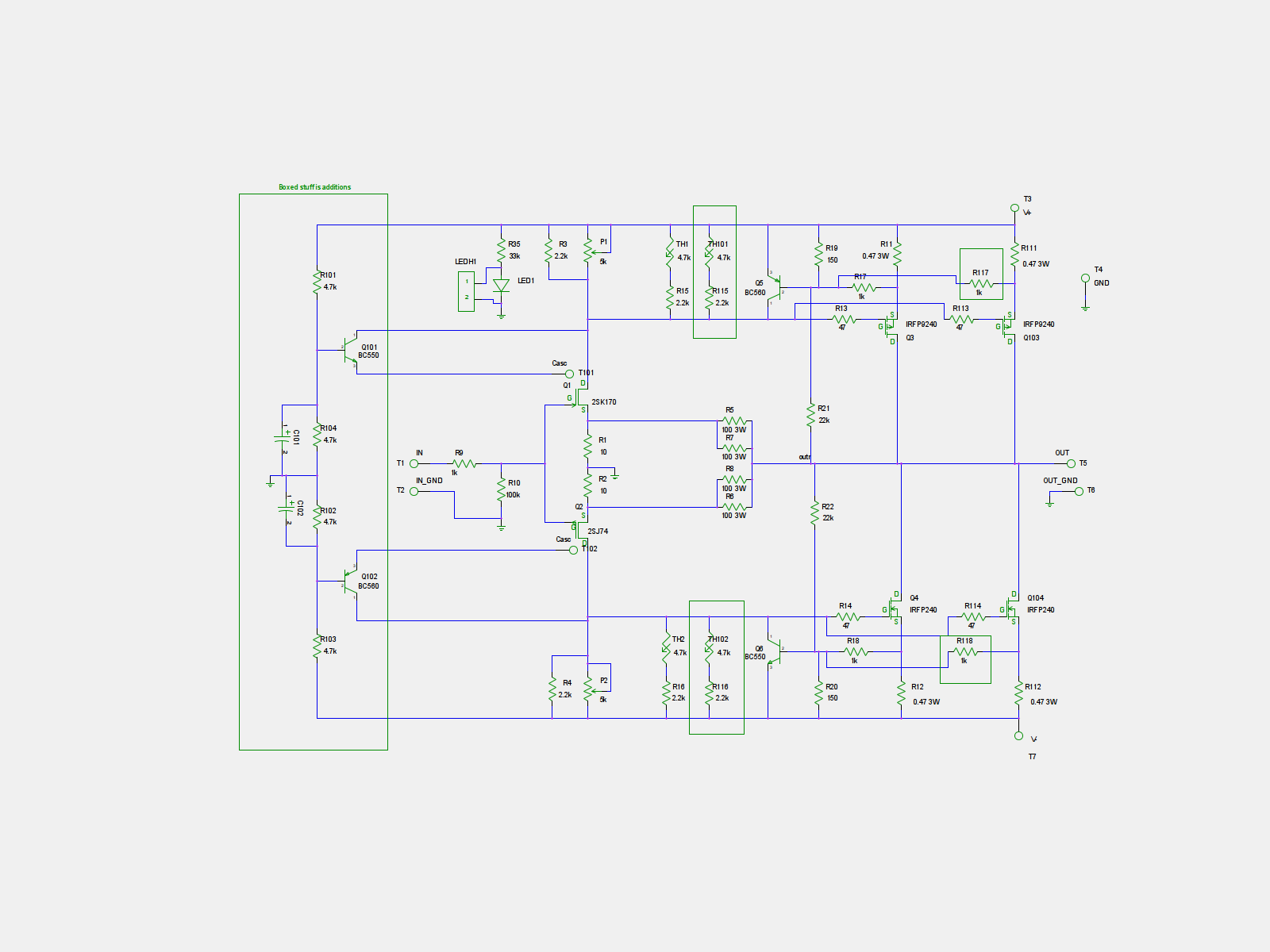

Schematics

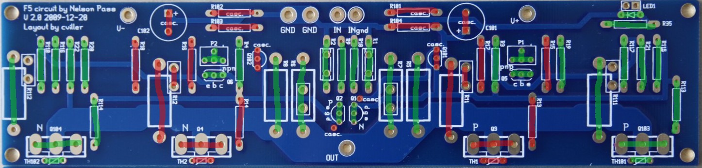

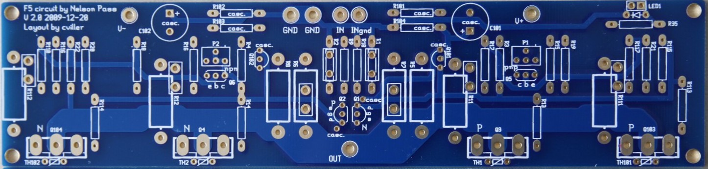

Optionality
With the addition of optional extra output mosfets and cascoding, there are...
ID:	102   Click image for larger version
ID:	103   Click image for larger version
