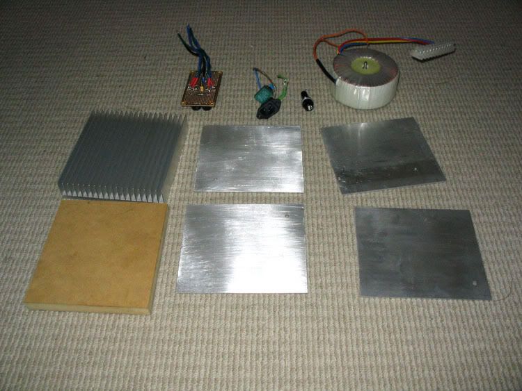

I'll now post some pictures of the construction of the chassis for the amplifier. I basically used stuff I had lying around. The heat sink was off a 48V regulated supply from a Fujitsu M380A Mainframe. The sides of the chassis were made from bits of aluminium which had previously formed the carrier cases for the CPU boards for the same mainframe, and the base was some left over MDF I had. So apart from Time the chassis really cost me nothing.
25.
26.
25. shows the pieces cut and the power supply components Since the plan was to use the heat sink as the top of the box everything was made to fit around that. 26. shows the less than perfect results that come from being to hasty! My nibbling tool bit the dust when doing the hole for the IEC power connector and I decided to use the piece of steel from the power supply I had taken it from as a template and cut it out with a tungsten carbide tip on the dremel... BAD idea!!
The later holes I chain drilled and filed with much better results! Even the holes for the rca and speaker jacks are very rough. mainly due to not having a drill press and inadequate clamping... Note that the extraneous holes were holes that were already present in the aluminum sheet before I started.
25.
