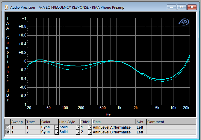

Overload margin, RIAA compliance.

Are those plots simulations or measurements?

DPH
diyAudio Member
I know they look deceptively like the LTSpice plots, but it does say "AP" in the corner so I'm pretty sure they're measurements.
