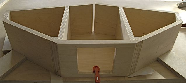

Build the center section first???
I'm not sure if this is the best way to procede but it seems to be working for me.
The idea of trying to build the center and glue it to the side at the same time was too scary. So I drew out the layout on some FLAT plywood and started.
The first to be done were the inside baffles that made up the CC. Those need to be spot on. Make sure that are square to each other and to the base. I let them dry over night.

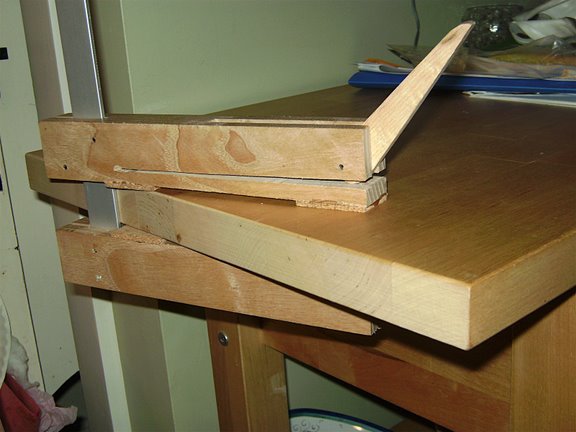

Home Made Tendon Jig
This jig is made from 3/4" plawood. You simply clap on your part that needs an angle (2 clamps) adjust the rip fence to the right distance and set the angle on the saw blade. Because it about 2 feet long you can cut large parts. Make sure the work piece is square to the table as you snug up the clamps. The cool thing is the cut is totally repeatable and perfect.

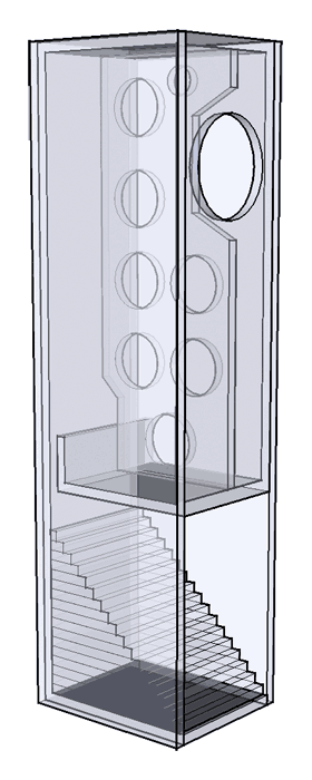

loninappleton said:Also a thing I found in 2 different drawings several months apart was the wave divider at center rear.
When the size of the start the port shrank there wasn't much room for the wedge. a suitably small one cab still be fitted. Another thing not in the drawing that i would add is a holey driver brace.

jrebman said:How big is the wedge, what is it made of, and how is it positioned?
The wedge would be (at maximum) a 1/4" high piece with a 45 degree triangle profile. This makes the 2 orthogonal sides 9/32". A peice of 1/4" 45 degree right angle moulding hypotenuse side to the cabinet back would do the trick. This runs horizontally centred on the inner back of the cabinet so as to "point" directly into the compression chamber exit.
dave
The Half-Chang drawings include an explicit holey brace. Note that if the driver is centred then 1 side of the holey brace is alighned to centre (setting the panel just off centre. This breaks up the primamry resonance mode & as a side effect provides a surface where damping can be placed so that it is dead centre.
dave
