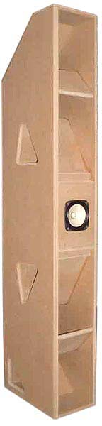

Harvey & siblings void fill
Do the voids in these Frugel-horn Spawn contribute anything ? Rather than fill them with foam, what happens if they are cut off (for the top and bottom) or opened up with say a 6" dia hole on each side for the internal ones above/below the compression chamber ?
Andrew
The can be cut out if you like:

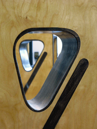

Hi loninappleton
I'm just catching up to this thread or I'd have posted sooner. In the curved Harvey, I ended up with (quite dense) felt about 1/2" thick on both side-walls - nothing else. Seems to work.
[edit]Also, I cut the side-walls away to expose the voids, thinking that this was both easier and more visually interesting than filling the voids with, say, sand and leaving the side-walls whole - see photo.[/edit]
Regards.
Aengus
