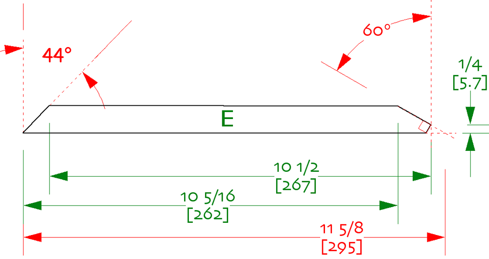

a problem with measurements
I started glue up today.
While laying out the pieces, I had to get the front face flush to accept the
2 baffle pieces.
When doing this I lost the glue line at E and F.
The drawing of E shows a 60d cut. The drawing also shows a back angle which my cutter duly trimmed out.
Dave can you confirm how this is supposed to assemble?
if 'north and south' component E on the compression chamber are parallel to top and bottom then there should be no back cut but just trimmed to 60 with some glue line remaining for F.
The diagram should indicate this.
If I'm in error please advise.
Meanwhile, I'm going to have my guy make some 60d glue blocks to get some glue line and bracing for the rest of the assembly.

loninappleton said:
Definitely a right angle and not a back cut on the drawing above.
The Harvey 1v1 cut list shows a backcut. I think the backcut would have been used on Harvey 1.o where the CC was not parallel to the top and bottom.
I will be able to make the adjustment.
The pieces of Harvey 1v1 of sheet 2 are just copy & pasted from sheet 1 and them dimensioned... what do you mean by back cut?
dave

Specifically (although I don't have a document number) I know I used what you gave me and the sheet says Sept 13 which I think is right rather than January.
The misunderstanding comes at piece E on the cut list where there is a dotted plumb or flush line on the right side of the image for piece E. The dotted line plus right angle base line is on there. At the tip of the drawn image, a reverse angle (what I've been calling a back cut) is visible. There is no degree of cut given for it-- it's just visible.
I'm seeing my guy today. We may have enough extra pieces to do a recut. Even so, I think I'll want some 60d corner blocks for stability.
The cutback is 30 degrees (90-60=30)
dave

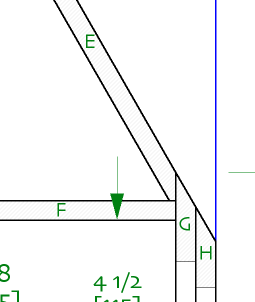

planet10 said:
Here is a snapshot with more detail...
dave
That's good detail. But why am I confused? The drawing further up
showed a right angle with no cutback.
I've used that upper drawing with no cutback to have a new piece E. Fortunately the guy does this gratis.
I'll report back on which fit works best. I now can experiment with both. Also using the glue blocks (for the belt and suspenders effect.)
planet10 said:
Now i'm confused... there is no "both pieces", They are the same... the 2nd detail is a cut and paste from the 1st one rotated "flat" to make it easy to dimension.
dave
