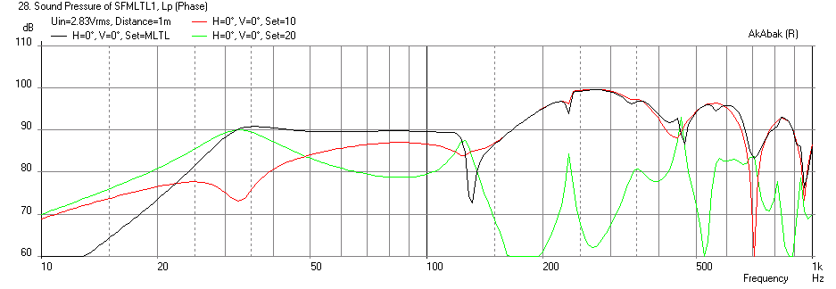

In-wall MLTL Sub with 6.5 in Silver Flute
Howard,
Per your request to have a sub that fits in a 21 in wide x 29 in tall x 3.5 in deep wall cavity that reaches 30 Hz. I decided to use the Silver Flute W17RC38-08 driver and a MLTL alignment. The Silver Flute has 3 in depth which is perfect for this wall mount application. The design is a single-fold so put a divider down the middle with the channel being 10.5 in wide on each side. Put the driver at 1/3rd distance from closed end. On the distal end make a slot vent that is 0.75 in high x 10.5 in wide x 9 in long with a parallel-to-the-wall shelf vent. Damping in the first 2/3rds of the line.
Here is the SPL vs Freq for 1 watt at 1 meter
Here is the Impedance
Here is the cone excursion
Let me know what you think. You plan to use a subwoofer plate amp with built in cross-over so that can take care of preventing too much excursion on the low end and stop the HF from leaking out. Probably want to XO at no higher than 120 Hz before the notch.

thanks xrk971.
It is amazing how much LF extension this type of enclosure can squeeze out of a 6.5" woofer, that has a 40hz fs, and is not really even a "sub-woofer".
