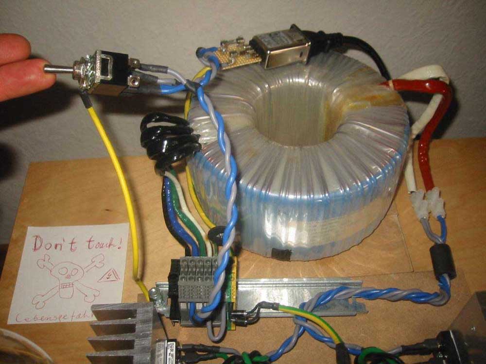

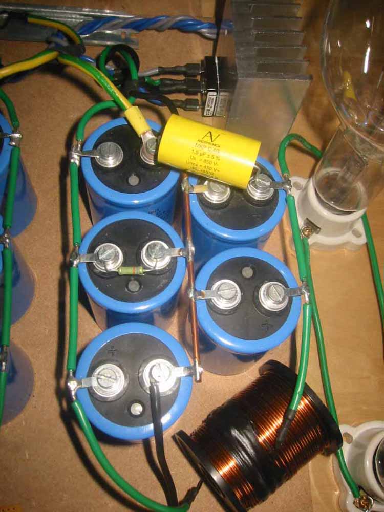

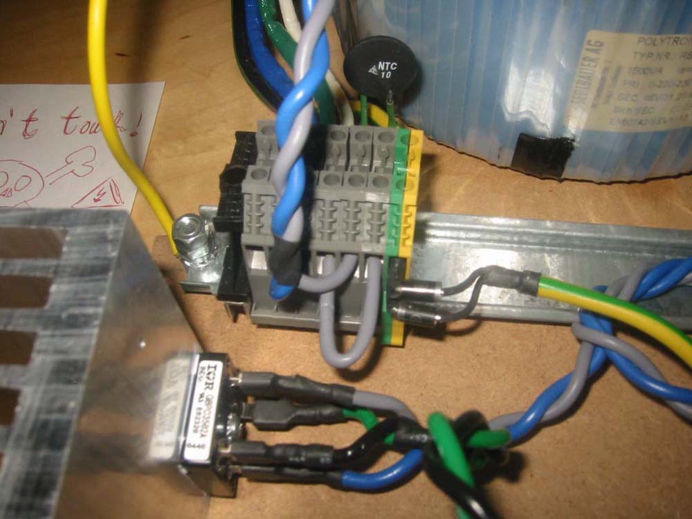

Hi, I hope someone is reading...
Ok, yesterday I’ve "finished" my Zen lite, my first DIY-project ever.
Unfortunately, I found some oscillation at the output...
Right channel looks like triangle (!) wave (like sine, but min and max connected with straight line) with some mV pp and left channel, even more $%#*, looks like a step (like a square-wave, but two steps between min and max, haven’t seen something like it before) with like 2V (two Volts, really) pp!
Now I don’t know what to do...I’ll describe my setup first:
The circuit is properly grounded, but not connected to earth.
For the power supply I’m using full-wave rectification and 3*10000µF (in parallel) electrolytics per channel for AC->DC plus one 110V300W bulb (also per channel...). There are still some 3µ film-caps around somewhere and more bulbs to come, but not wired yet.
The ground connections of the power supply are terminated at one single separate point (one per channel...), like a star.
This point is then connected to the ground point of the amp-circuit with a fat piece of wire.
The grounds of the two channels are not connected in any way.
The rectifiers (bridge rect.) and the FETs are mounted onto (and carefully isolated from) a heat sink, which can sink enough heat, really.
The wiring from/to FET and bulbs is a bit wild at the moment, so there is some improvement to come (like shorten them, solder instead of clamping contacts).
Plus the whole circuit is open on my table, not in a shielded box.

Hello Mr. Pass,
thank you for offering your help.
You mean
Supply and
Source to Gate and
Drain to Ground?
Maybe R3 and R4 don´t have the right value? Or could it be R1?
A damaged IRFP240 would have other effects I guess...
How much does the wiring of the FET affect the circuit? This would cause noise, but not oscillations, right?
I will do some measurements today and post them tomorrow.

Ahoy,
The DIY-Gods finally allowed the amp to work. It turned out MUCH bigger than I've been expecting, but I think that's something good.
I'm using CLC filtering, with 3*10000uF80V followed by a 0.5kg spool of magnet wire (18AWG or so) maybe 5mH and 1Ohm, followed by 2*10000uF80V bypassed by 1.5uF400V MKP at the load.
The transformer is a Sedlbauer 1500VA (14kg) with primaries from 0-220-230-240 and one secondary with 48V and many amps.
The switch is a real mexican one, just like the bulbs. The housing of the switch is directly earth-grounded, so I must not fear...
