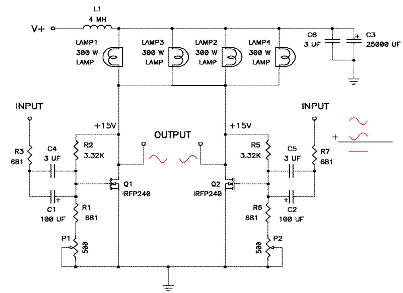

is it so that if you place your light bulb's parallel and then for both FET's like this
...............................................I

Soz is differential and there is a bulb par fet , in your schematic there is just one bulb and 2 parallel fets like a zenlite.
I admit, in experiments I did there was both iron and transformers near the bulbs .By the way I find the effect very intresting.
:cool:
sorry but there went someting wrong with the posting here is the schema
gr Jaac
not this way, as sayed if inverted and noninverted output are tied together = connected with zero ohms, we cant expaext any segnal across a loudspeaker load in parallel to that.
