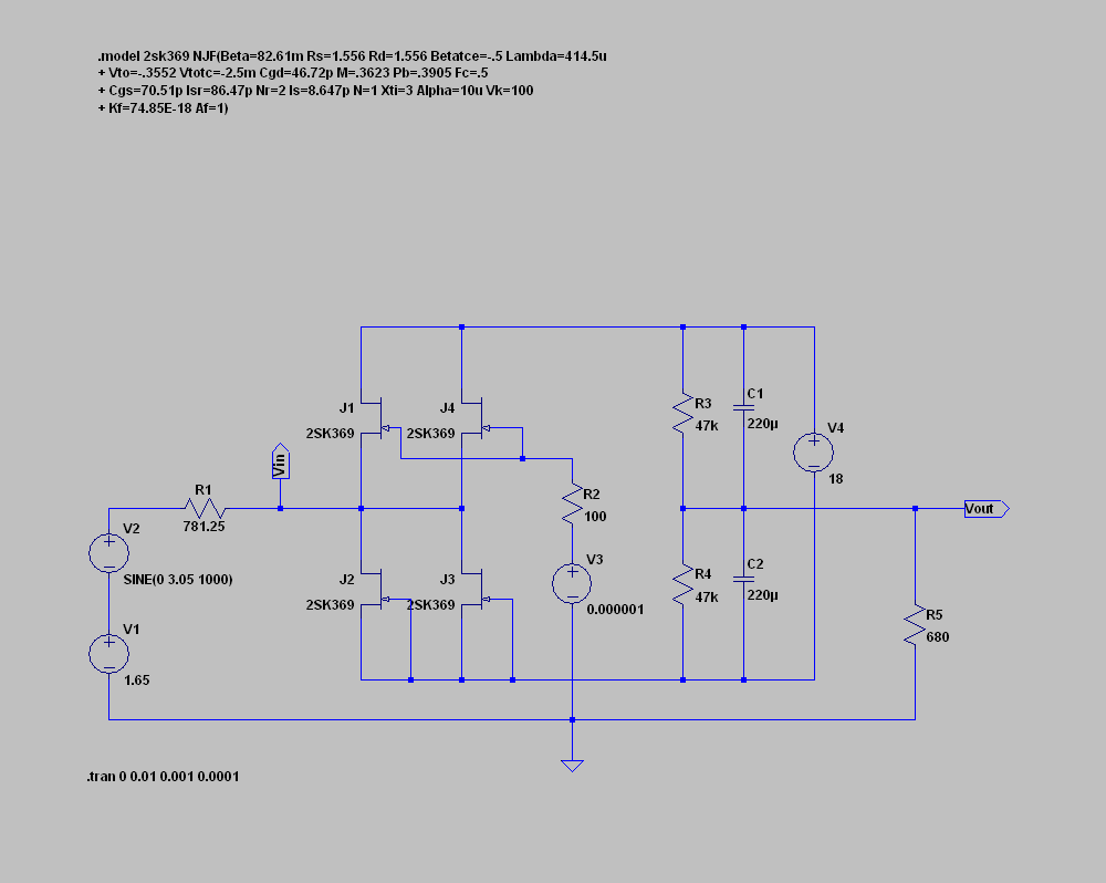

For a rational, scientific discussion, I made a couple of quick simulations in Spice.
The first schematics is SEN IV V18 with Vref at 1.65V, as NicMac has built with success.
The components V1, V2 and R1 represents the ES9018 giving out a full amplitude at 1kHz.
(See datasheet March 2009, P.30)
R3/R4 are 68k/47k in accordance with Vref of 1.65V.
The rest should be obvious.
Vin is the voltage measured at the input to the SEN IV (out DAC output).
Vout is the output across R_iv (= R5).
The output current of the DAC is equal to the current through R1.
The output figures shows the proper working of the SEN IV circuit.
Current amplitude is ca. +/-4mA. Output voltage is ca. +/-2.7V.
Patrick

In the second schematics Vref is set at 1µV (~0V), as Paul would like to have.
R3/R4 are both 47k for Vref = 0V.
The output figures shows a large swing at Vin, which is not how the SEN IV should operate.
Current amplitude is now ca. +2.4/-1.8mA. Output voltage is ca. +1.7/-1.2V.
I know which one I would choose.
Patrick
