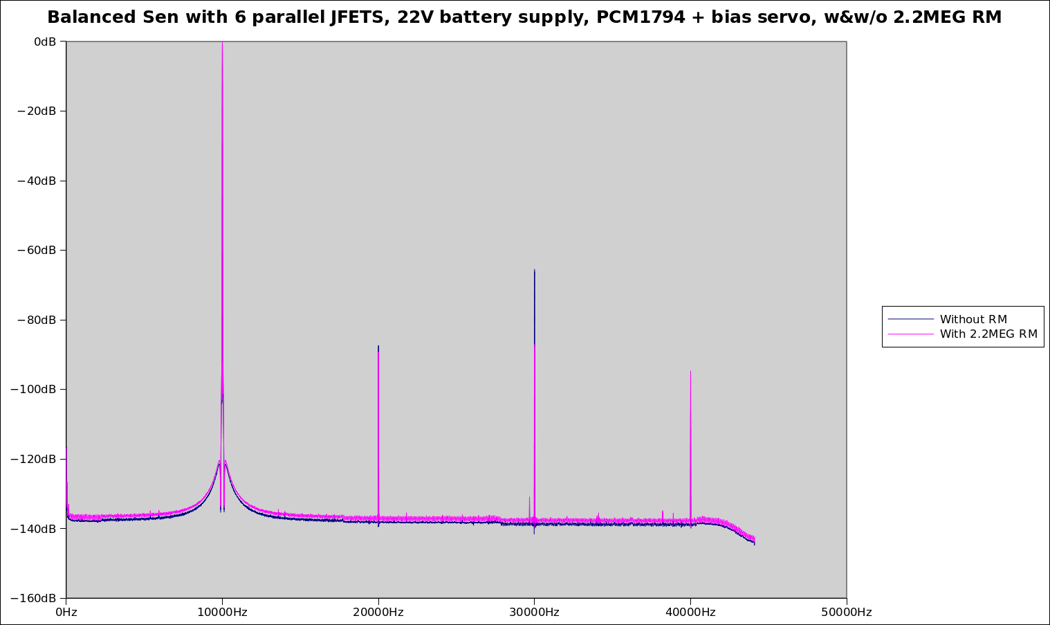

RM idea sniff test
I gave this a go on a breadboarded Sen. It seems to work. This is the first Sen I've made which I think would hit -90dB THD+N.
The effect of RM is more significant at higher frequency so I've attached a comparison of the 10kHz spectrum before and after the RM mod.
I listened to it briefly and it seems to be OK.
RM1, as shown, looks like a fix for the gate capacitance issue and would allow you to parallel up more JFETs.
Simulation shows significantly reduced 3rd harmonic distortion.
I'll try it out shortly.

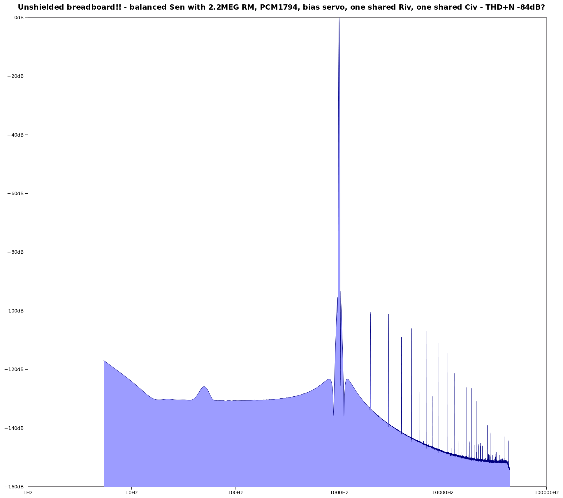

Most of the earlier results I posted had a small ground loop going through the servo.
For reference, having fixed that, I now have a balanced Sen implemented on a breadboard with no shielding and I get:
THD+N: 0.0063% or -84.0 dB
as calculated by the script here: https://gist.github.com/246092/dd9f7ffcaee42d1e1733e1280d3c77439fae951c
If I modify the script to exclude more of the skirts (from clock jitter?) I get -86.8 dB.
I really don't think you need to worry so much about noise. Just make sure there are no ground loops and put it in a box.
-90dB THD+N
I modified the script to have a notch filter from 0.725 f0 to 1.38 f0 which according to some comments in the script is more like an AP1.
This gets rid of a lot more of the skirt of the fundamental.
With the new script and a new measurement taken later at night with a bit less mains hum I now get:
Analyzing "1k5-4.flac"...
Frequency: 999.902450 Hz
THD+N: 0.0021% or -93.5 dB
So there's your -90dB and it's still on breadboard outside the box.
