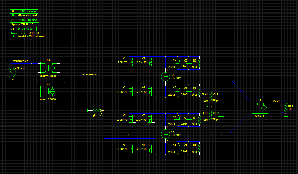

...minimally higher input impedance which is a dubious theory at best at actually adding distortion to most DAC chips.
It's easy to measure distortion caused by I/V input impedance using a passive resistor I/V. You can google for people who have done so and published results. I've done some testing myself and have seen a big difference between a 50R resistor and a 2R reflected load from a tube amp output transformer used in reverse.
In the 2SK369V SEN, the Zin is below 10R. I consider that low enough.
If you really believe in super low Zin, then opamp IV is your solution.
Or use (multiple) BJT with a high bias, something like 20mA.
You can see interesting discussions about BJT with Calvin at the start of the thread.

Sub-10 ohm is pretty acceptably low, and low input Z is of course only part of the story anyway.
When I read the LA article and was led to this thread, which I've been following ever since, I started looking at some alternatives, that incorporated the SEN approach of floating supplies (which I like a lot) but applied feedback to the SEN input devices' gates from an all-JFET separate gain stage (no opamps per se, no feedback resistors). Other distractions have prevented this from getting beyond those simulations, but the sims looked very promising. Someday...

I went with 12 JFETs in parallel but the 3rd harmonic was a bit too high so I'm backing off with my 4th Sen instance to 6.

Hello Patrick. I have a question regarding Sen V18 components values (for es9018 dac).
Can I use for C1 and C2 values bigger or smaller then 220uf and with voltage rating of 10v or 20-25v? (for example can I use something like 470uf 16v or 330uf 10v) And what type is best for C1 and C2, can be used Aluminum Organic Polymer Capacitors for this purpose?
And about Civ. WHat formula should I use to calculate the Civ value. Can be used this calculator at the bottom of page with sign First order RC-filter? And what value should be Fc? I see in original Sen Fc is about 170kHz isn't this bad thing that can bring a lot of RF trash to music? Maybe 100kHz should be fine here?
C1 and C2 I would use minimum 100uF and minimum 16V.
In theory with 18V supply you can use 10V, but I don't like using caps to their rated voltage.
It's just me.
I use non-polar Elna caps for those positions.
Riv and Civ forms a first order RC filter. So just the usual formula.
Whether you use 100kHz or 170kHz or else is a matter of taste.
It also depends on the sampling rate.
I suggest you try different values and listen.
Patrick
