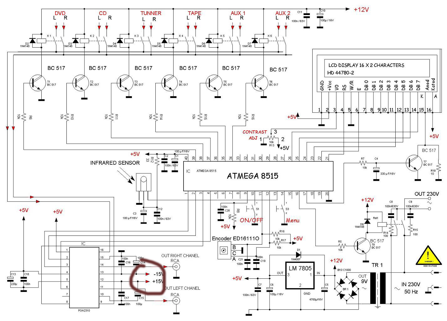

i'm just try to build this thing, absolute no experiance with electronics
What dus 15V means see picture and red circle.
does it mean you have to connect -15V and +15V or what?

Yes you need a separate +- 15V for PGA2310 ( dual voltage ) for analog part .

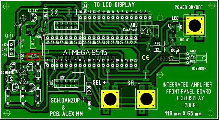

The Power-supply board layout is a little different from from the schematic, Is it still safe to use? (particularly around the mains)
Do you have a board layout that tells me where all the parts go for "IS REV 4 A". the board layout in your first post is for a chip source selector.
And may I ask what this is? (I've also noted that many of the transistors are different in the board layout... Is it safe to follow the schematic?)

1. yes ! no problems about if you keep in mind that there are live 230V voltage that can kill you !
2. that pcb was made by alexmm from this forum but have been tried by me and they worked .
3. use whatever tranzistors have , just stay with the schematics
4. that is a ferrite 0 ohm wire jumper

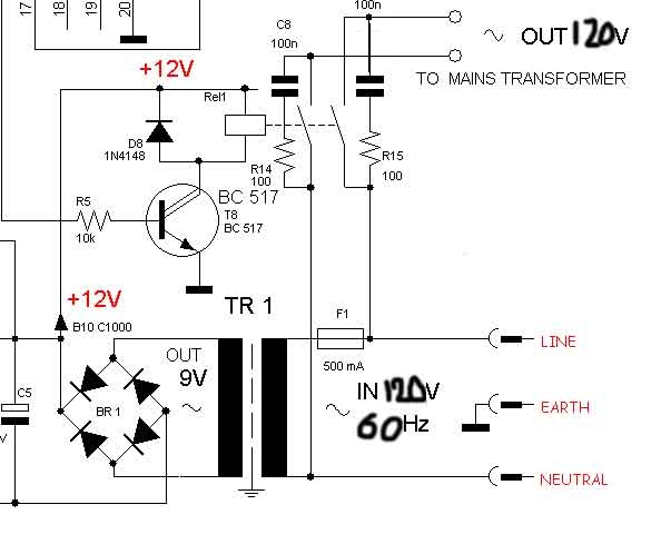

I'm currently building carlos's blame ST along with this VCSS. I've discovered that each channel pulls 180watt's and 2.5 amps (I am currently building 2 channels) . This part of the schematic here:
What kind of resistor wattage ratings would i need for R14 and R15? And if there's any information i need to know, let me know.

1/2W ( that resistors do not depend on the power of consumer side but there are on circuit together with capacitors to protect the relay contact ) .
Voltage of capacitor >120V I think you know that .
