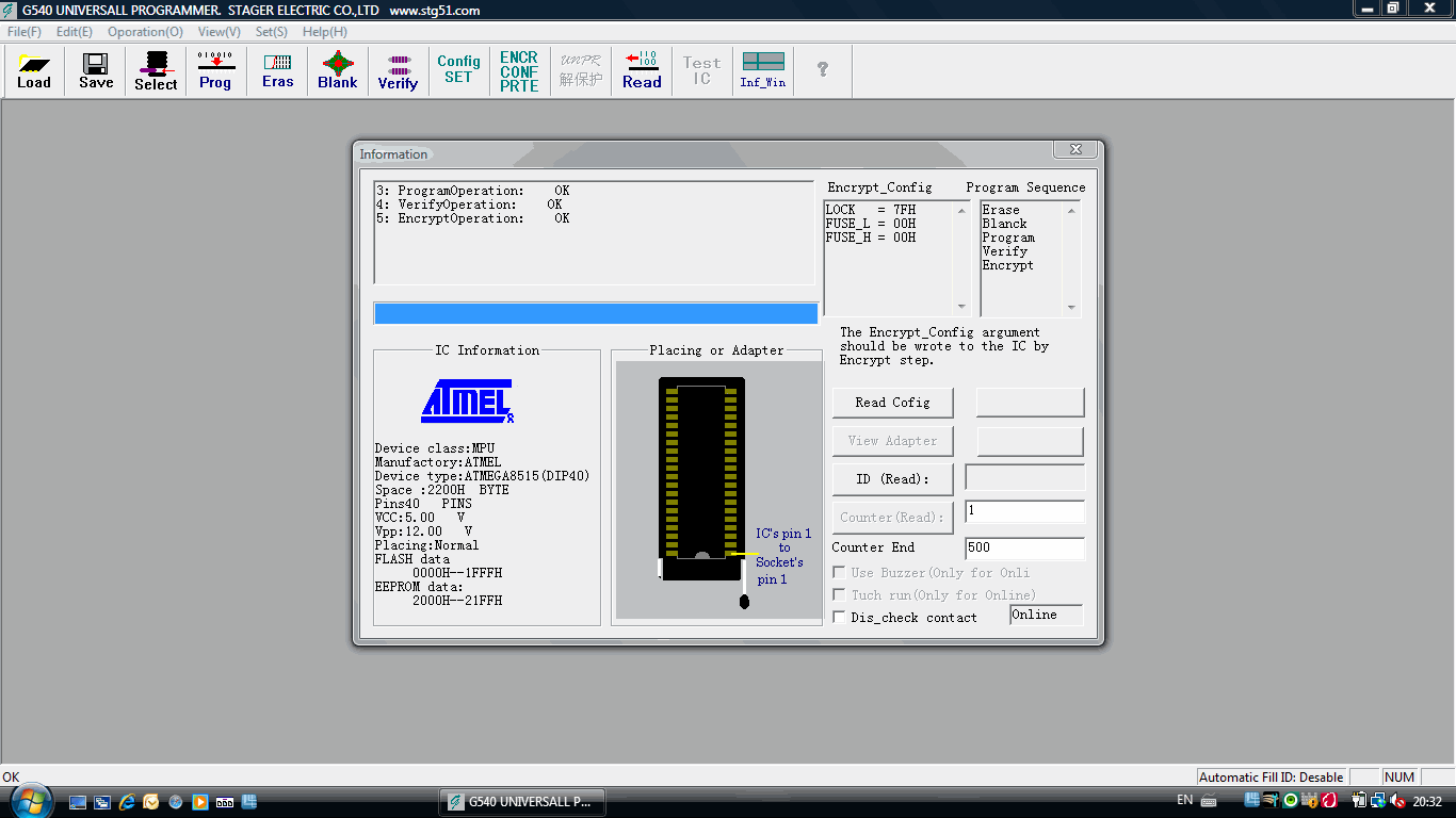

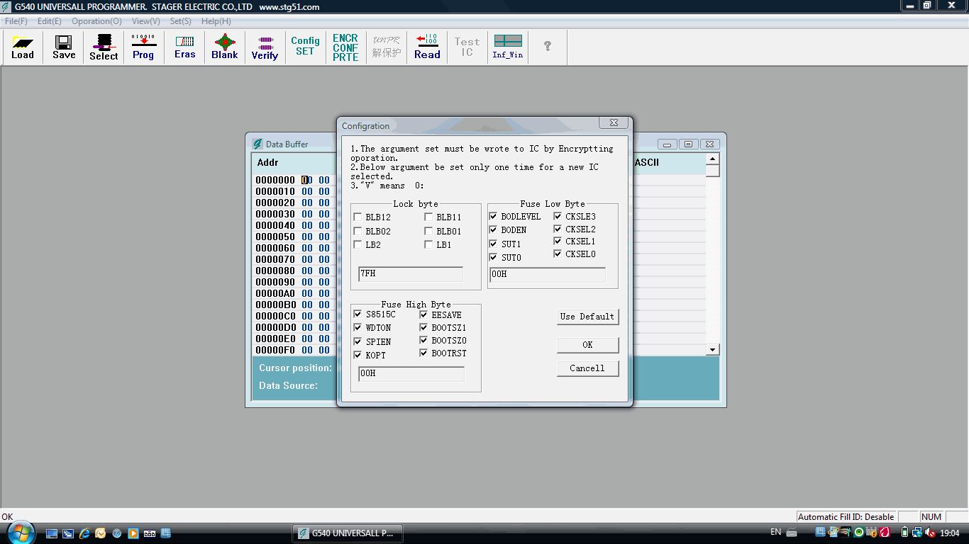

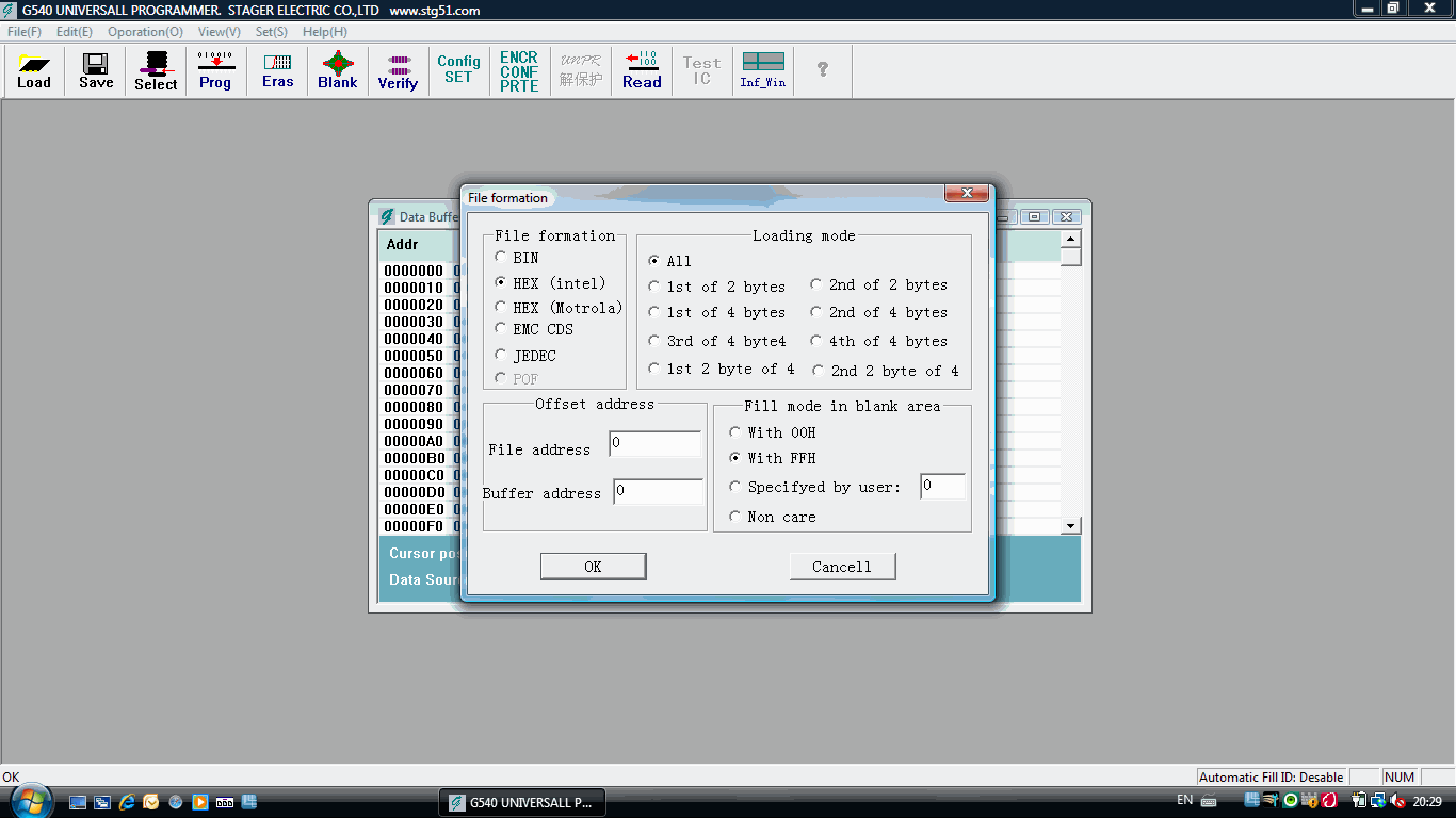

Dear Danzup,
i have made a hardcopy of the setting for the programmer
i don't no what to select. I have program the 8515 as you say
load the HEX file and program. I only see in the first line
bars on the LCD nothing else check every wire but can not find
any wrong connection. does you software check everything like pin 16 on the processor must be connected.
hereby a hardcopy

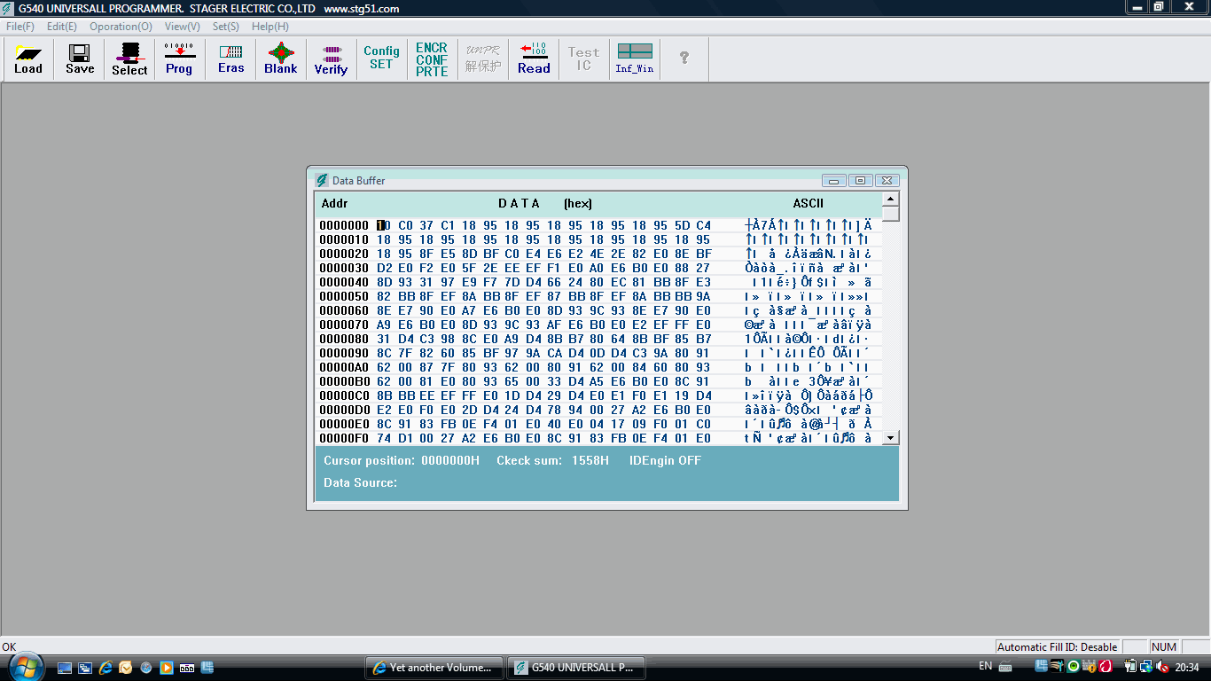

Read the 8515 (not the fusebits ! ) with your programmer and put here a print screen please .

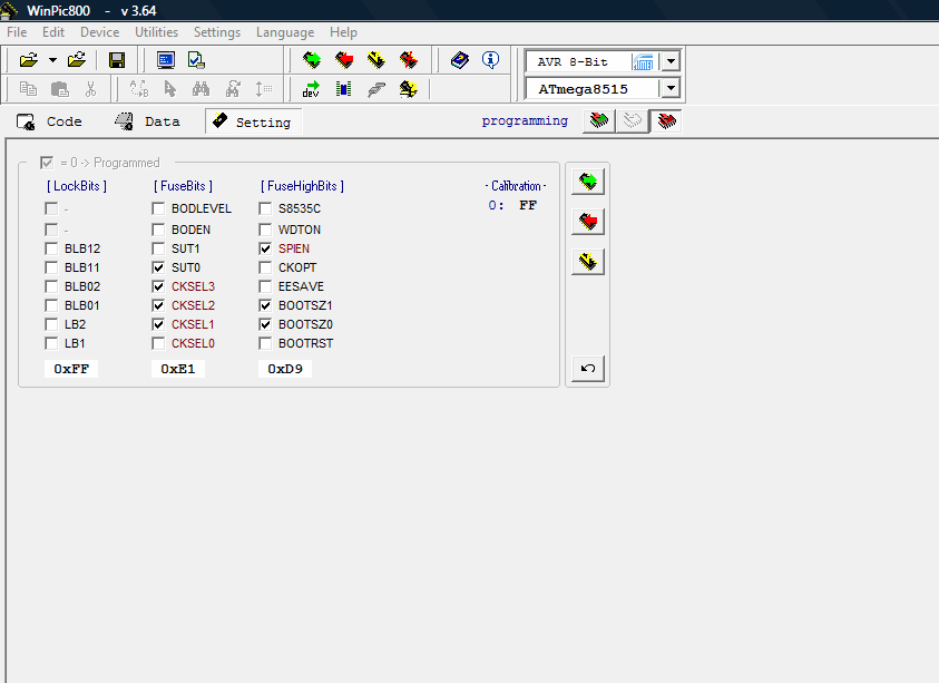

dear Danzup,
i have borrow an PIC programmer for the winPIC-800
could you me the fusebit settings see picture
Ok here are the fusebit that must be altered :
CKSEL 0 = selected
CKSEL 1 = selected
CKSEL 2 = not selected
CKSEL 3 = selected
selected means there be that sign "checked"
After the fusebits been programed please check connection between LCD and atmega8515 to be exactly as in schematics .
You have something wrong on those lines .
Also please check the contrast potentiometer , begin with cursor at the ground and slowly go to the other extreme .
Also connect and press the on/off switch as my program get in the power off mode after you power the circuit .

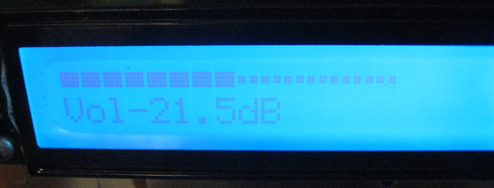

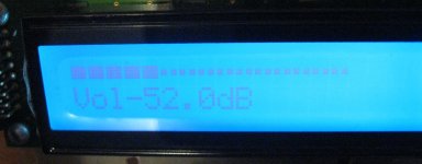

Bar Graph
Hi
Here is my bar graph version
Dim I As Word
Dim Cols As Word
Deflcdchar 0 , 32 , 32 , 32 , 27 , 27 , 32 , 32 , 32 ' empty symbol
Deflcdchar 1 , 32 , 32 , 31 , 31 , 31 , 31 , 32 , 32 ' filled symbol
Declare Sub Bargraph
'-----Bar graph------
Sub Bargraph:
Cols = L / 17
Locate 1 , 1
For I = 1 To Cols
Lcd Chr(1)
Next I
For I = Cols To 14
Lcd Chr(0)
Next I
End Sub
