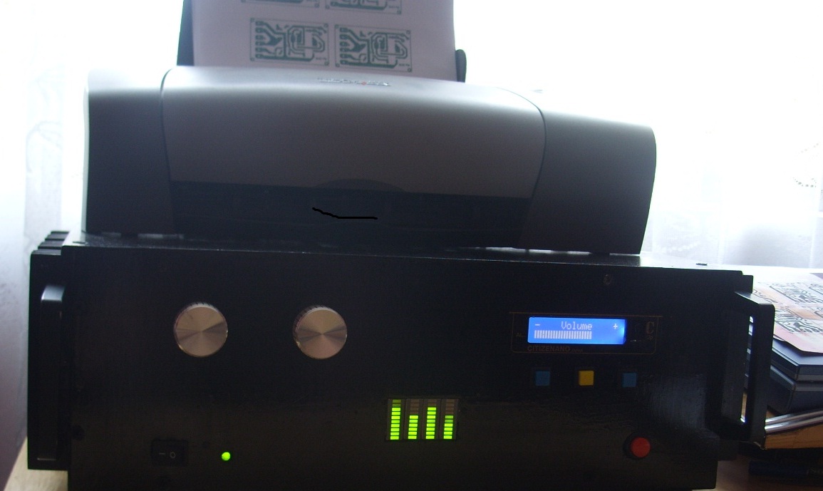

@danzup
Yes, excellent, wonderfull, beautiful. I was sure you had idea, but never thought that you already made this. It is even better if it can be done with two lines LCD. Do not hurry, first finish your tone control firmware. I am patient, I can wait.
@both danzup and didiet78
VFD are really nice and cool, but hard to find in Serbia. I must stay with LCD.
Greetings to both of you.

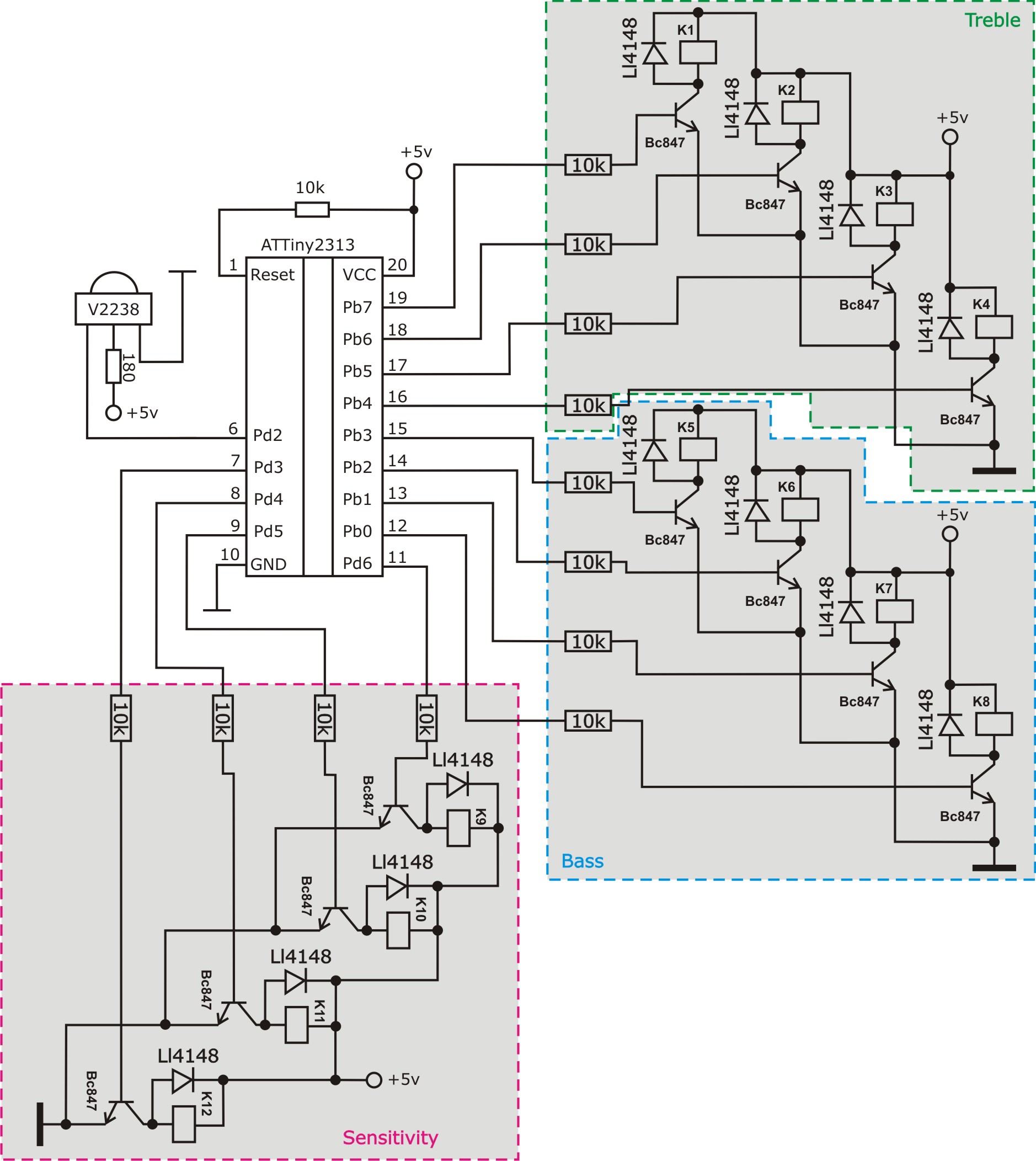

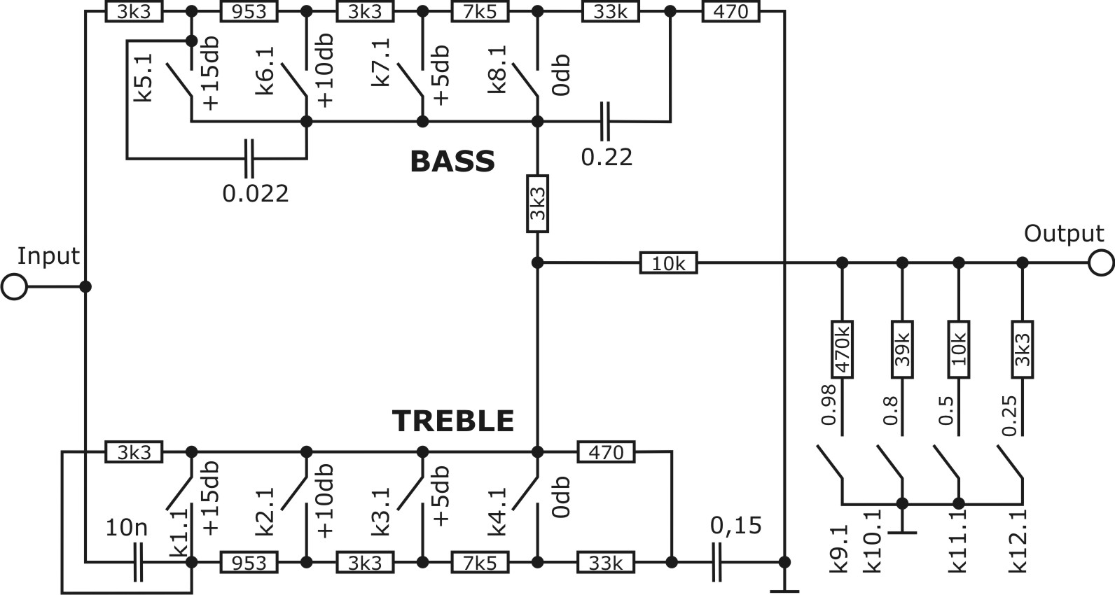

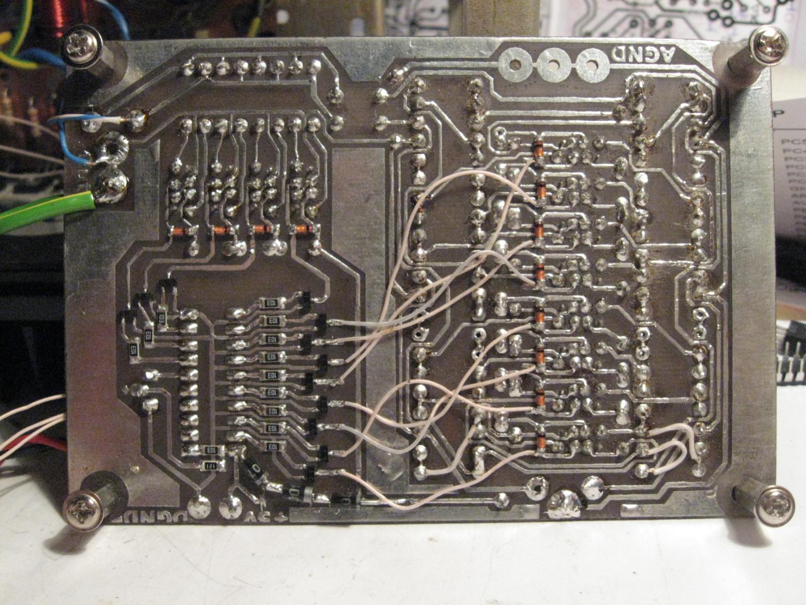

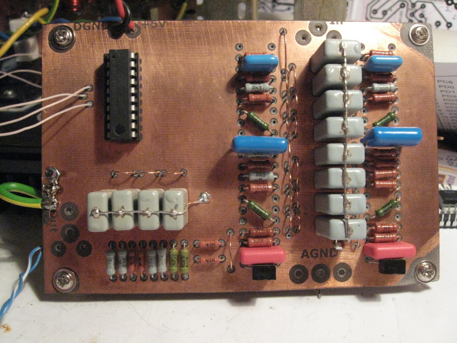

Hi all.
A month and a half ago I finished my tone control based on danzups firmware.
I made some changes for my needs. After some schematic and PCB additional changes it works properly🙂
Sweet sound with old-school soviet resistors is perfect😉

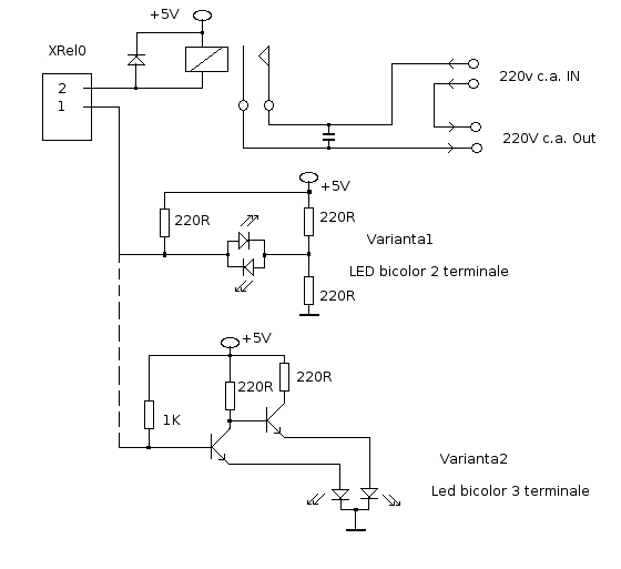

These are probably dumb questions but I'm a bit new to this. About the direct input. I dont really see its function but people seem to be happy that its there. Can someone explain it to me?
I cant see what Xrel0 is for. Is it a spare relay control?
That direct input is really an record output /line out of selected input source !
For Xrel0 the pictures is self explained .
Also with another firmware in case of use for tube amplifier Xrel0 command for 2 relay : first for main power/heater of tube and second for tube anodic +B voltage control (instead of controlling led ).
