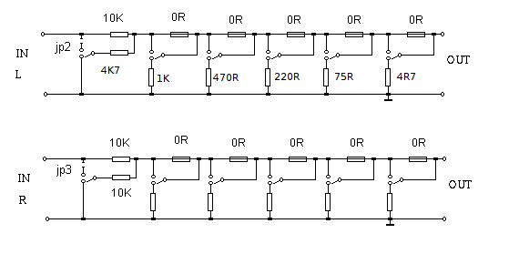

50-Step Shunt Attenuator Resistor Calculator - Neville Roberts
and choose 32 steps , then you calculate resistors in parallel to fit in 6 relay combination .
And at the end you will find my value !
Thank you for the information Danzup.
I was further analysing your shunt circuit, but find the variance between the steps rather wide and variable. I probably missed something :confused:
What I did was calculating all possible resistor combinations using your values (10, 100, 470, 4700 and 10k) for the resistors. Then I sorted them according to their attenuation factor and tried to select the interesting steps (in the beginning and the end 6 and 4 dB allowed, in the middle preferably 2 - 3 dB steps).
The thing is: I can hardly find 32 steps that are significant and usable (I'm not going to use < 1dB steps suddenly followed by a 4dB step for example..).
Attached my excel sheet with a graph showing the variance for each step called "Step(1->12)" varying up to 11dB and the total attenuation called "Att(0->70)"
Do you have a similar varying step-size?
Thanks for your help!
Berny

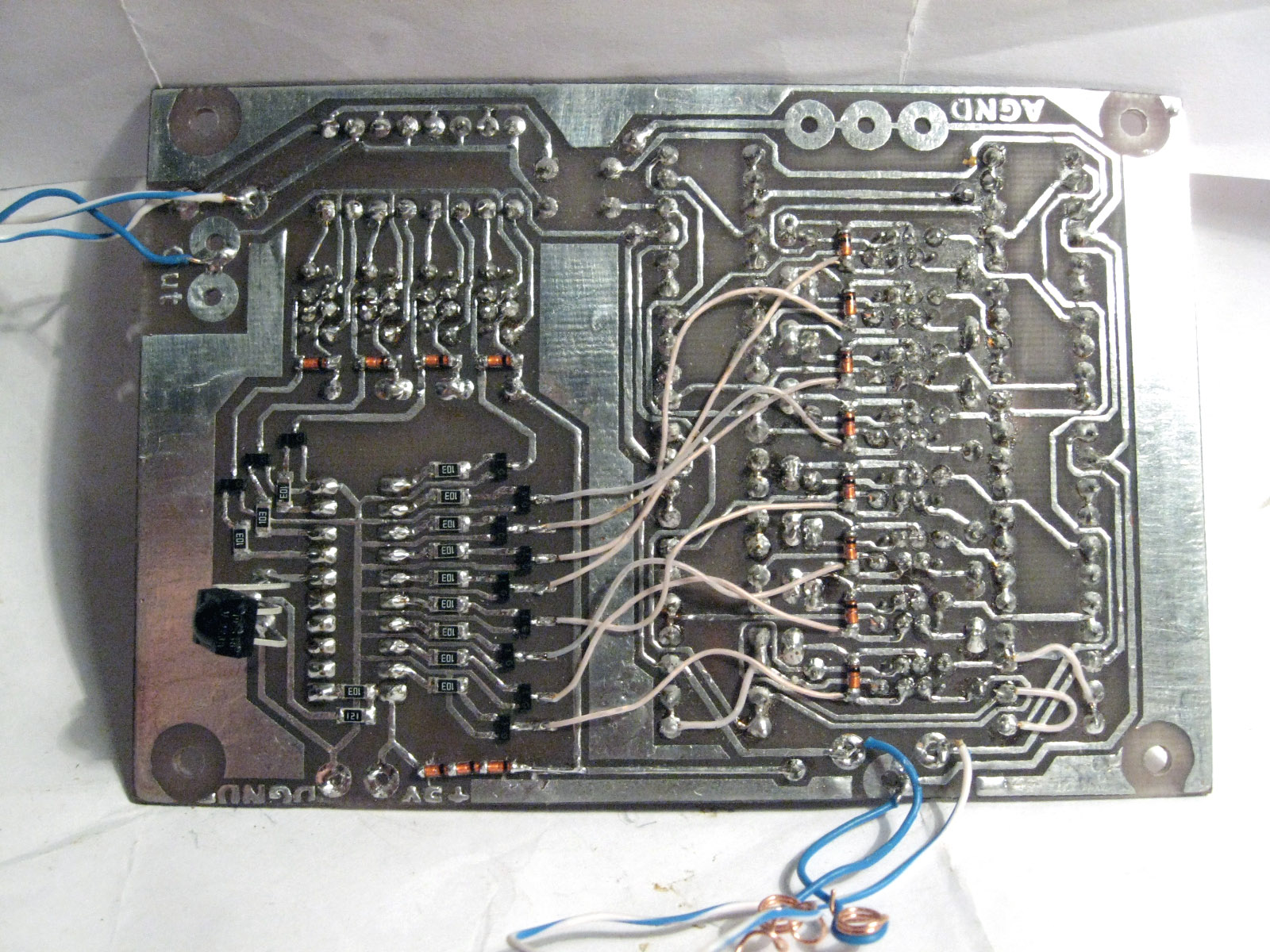

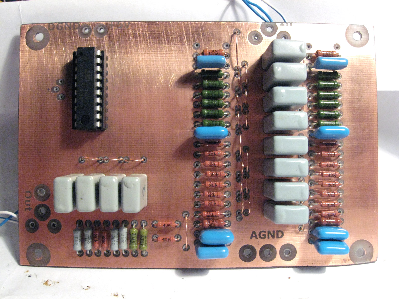

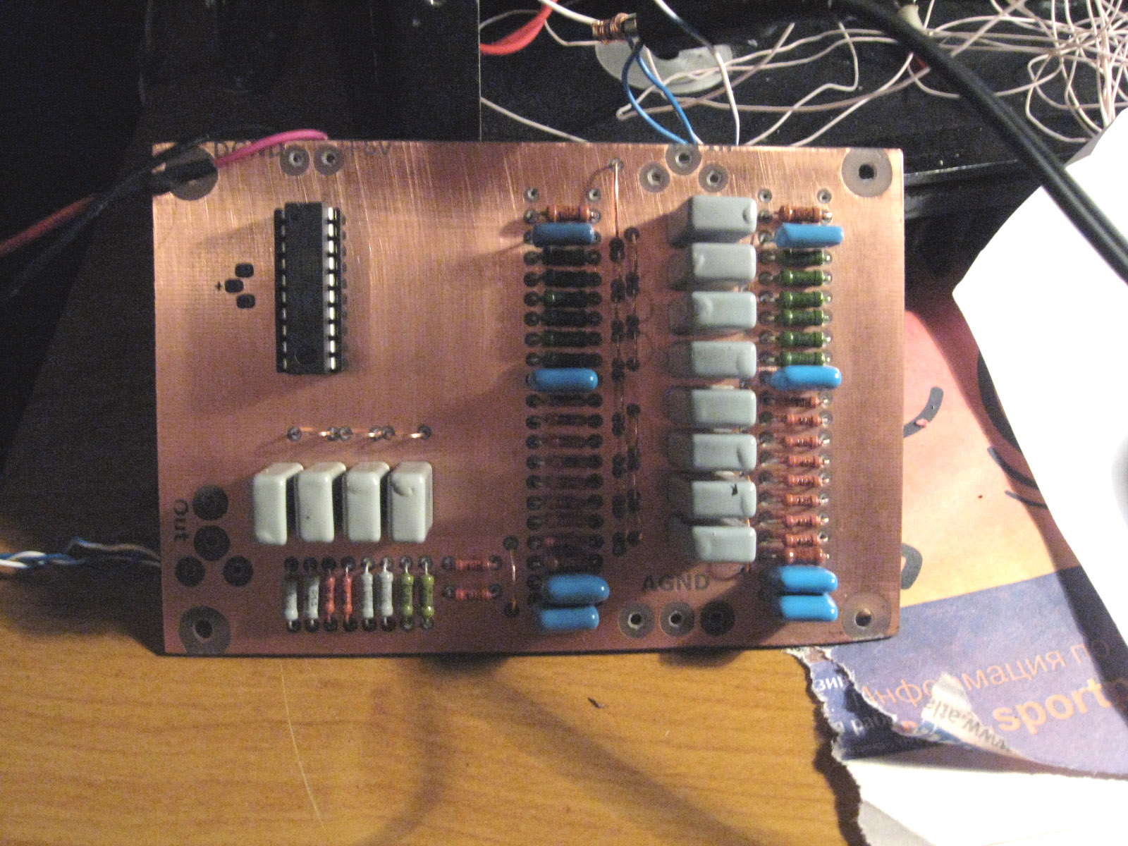

  • Source_HEX.ZIP

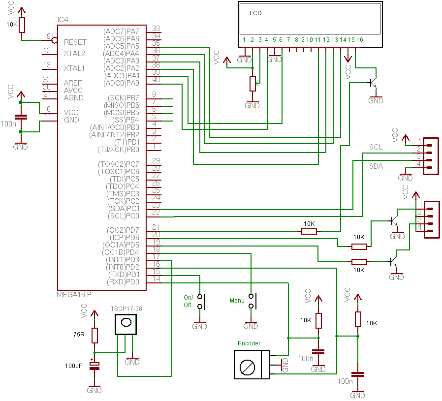

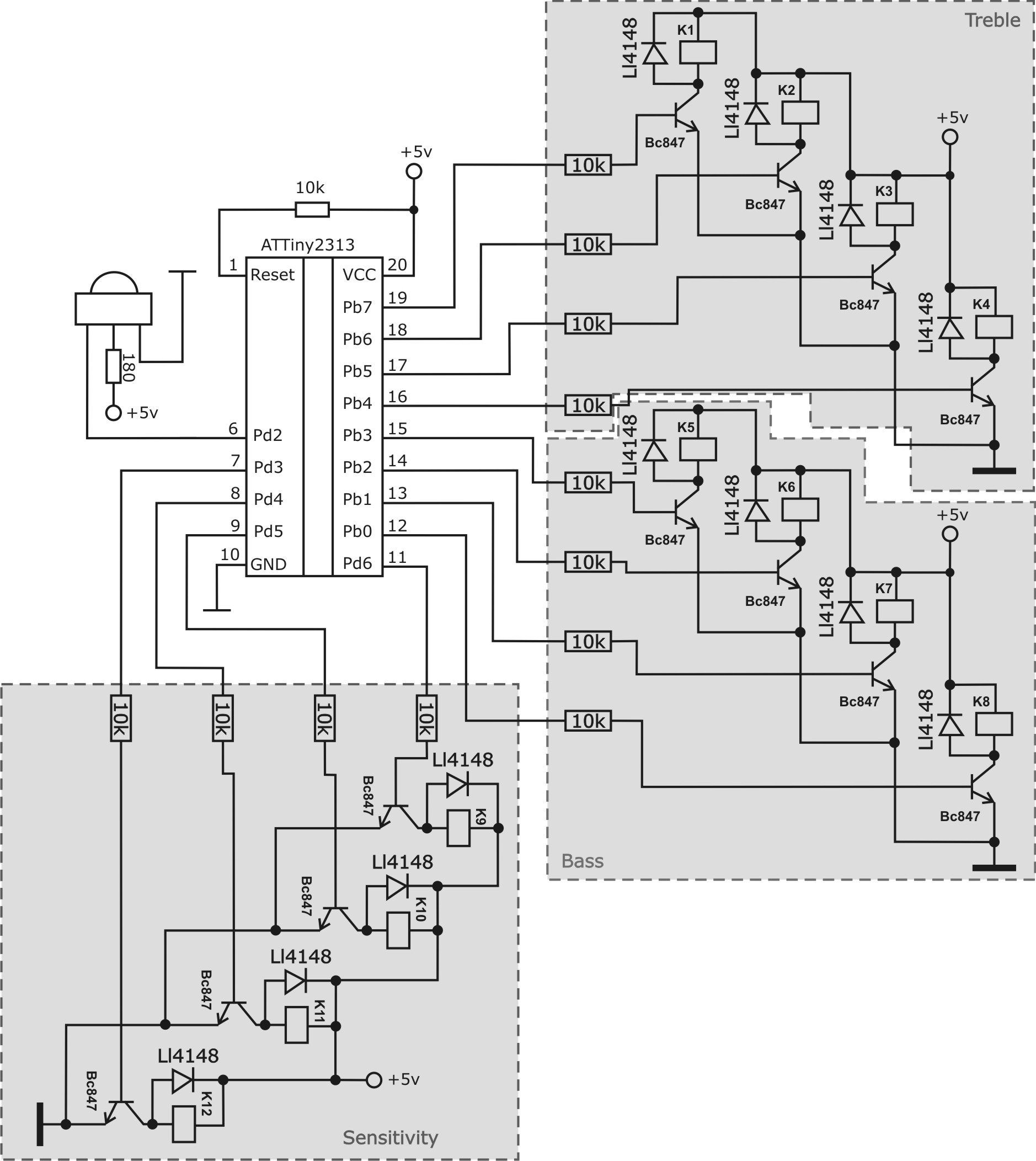

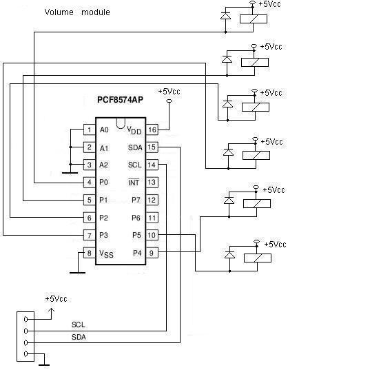

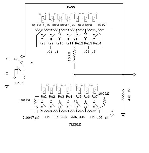

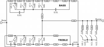

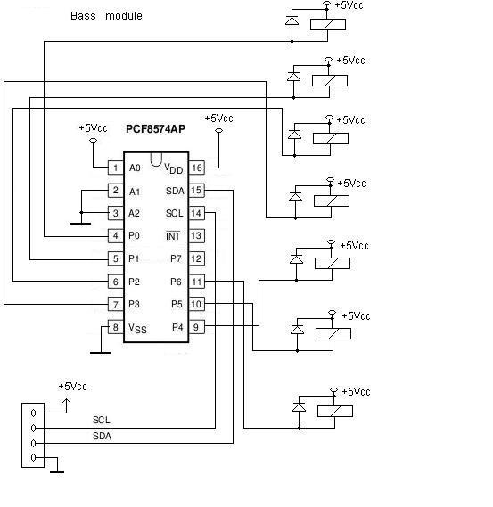

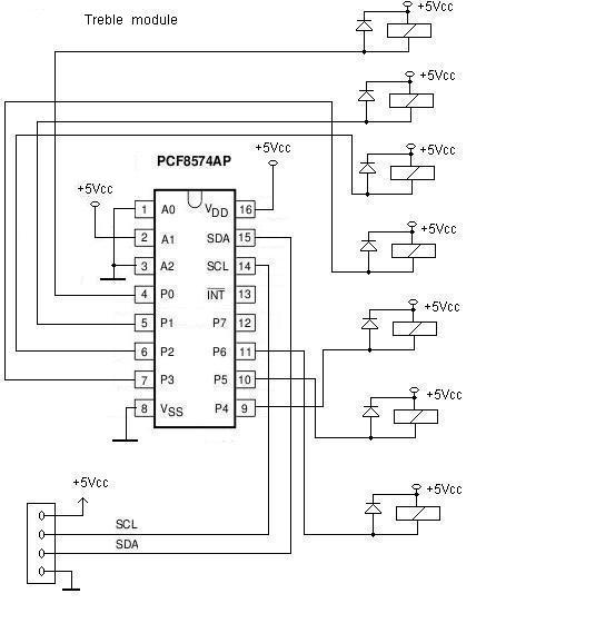

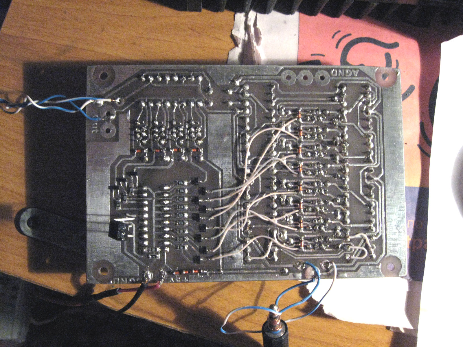

Passive Tone Control will be provided by following modules .
The micro-controller will be atmel atmega 16 with LCD , IR ,encoder and switches .

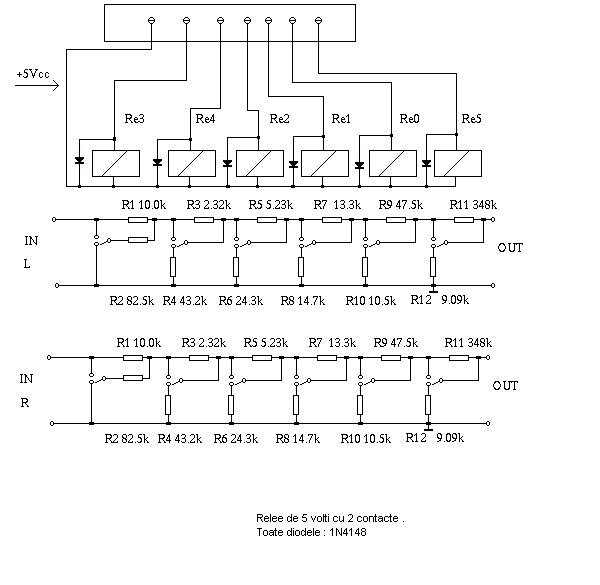

For each step I check how to account the resistor depending of the position of the corresponding relay. IF(logical_test,value_if_true,value_if_false) will recognize 0 as false and all other values as true. If the relay is ON = 1, the output for that if-structure is the (R)^-1 (inverse of the value). If the relay is zero, the output of the if-structure is the inverse of an infinitely big resistor ((10^10)^-1 = 10^-10). The equivalent shunt resistor is the inverse of the sum of the inverted resistor values you have in parallel. Req=((Ra^-1) + (Rb^-1) + (Rc^-1) + ...)^-1. Better values I found are: 12000, 5500, 3400, 2350, 1700 based on a photo from a commercial product, and I hope they don't mind too much... Anyway I still don't understand their solution fully and there should also be a switchable serie-R I guess.

Melf SMD and Takamishawa 5V relay are the best !
This is what I am using .

Berny all the info are here in this thread :
- for r/2r attenuator I am using values identically with Jos van Eijndhoven ( http://jos.vaneijndhoven.net/relaixed/index.html )
( 64 steps as I use 6 relay )
http://www.diyaudio.com/forums/atta...olume-controlers-source-selections-dmw7pg.png
- for shunt attenuator there are some values that are result by month of using and listening by me:
( 32 steps as I have 6 relay )
http://www.diyaudio.com/forums/atta...volume-controlers-source-selections-shunt.png
and now again I have modified the values as in the attached pic and this for my audio set-up like this :
CD-Player--->Shunt ATT--->Tube amplifier--->96dB speakers
more info on first page of this thread an project number 3 with all info there .
Relay are this :
