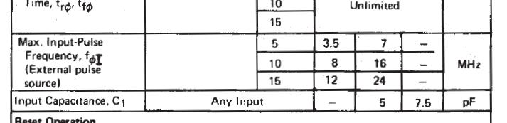

4060 work well at 15V if you dont use cap over the crystal! All my amplifier work with this clock generator and for about 6 years, no fault at all on this section! As you know to, 14060 and 4060 is not the same IC...What I use is the CD4060BE for Ti..Look at spec!

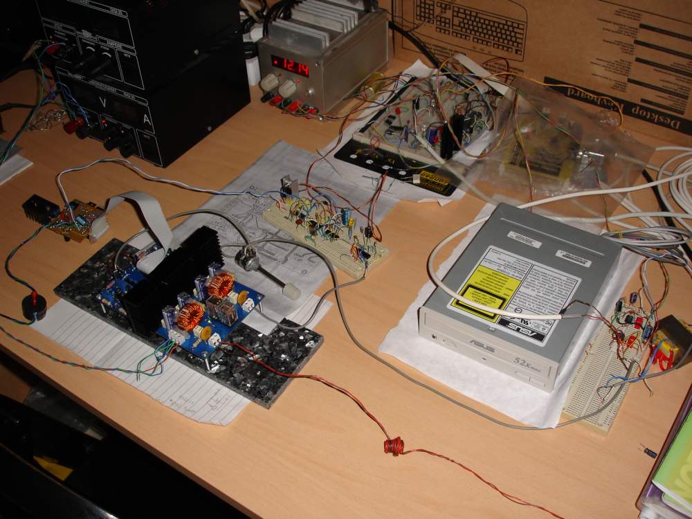

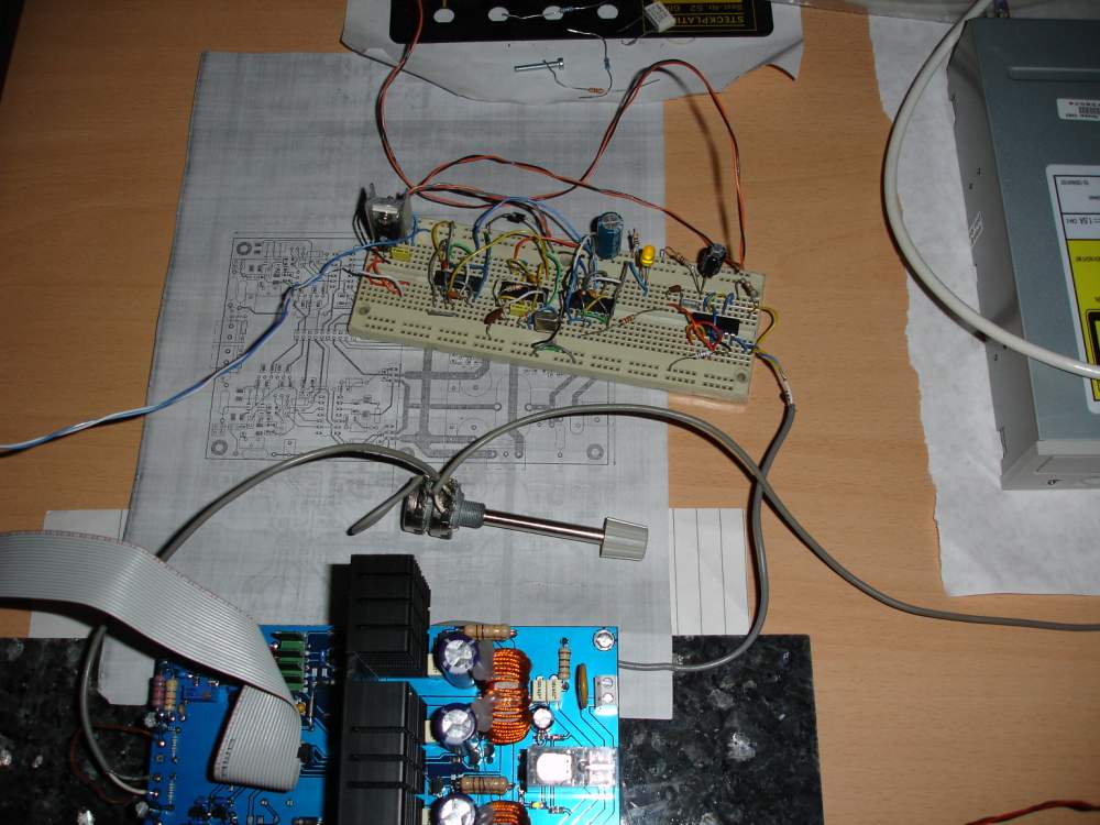

Hello everybody again !
I was just wondering is it possible to occur a bad feedback response if I use +-25V insted of +-50V which was originally suggested by IR ? I asking this cos. this my version is still in testing phase and I've seccessfully added crystal controlled clock to lock freq. to 447.443kHz
(3.579545 MHz / 2^3)
Nice work! Why heat sink on the IR2110? Just higger your gate resistor and reduce dead time to reduce dissipation in it! And important, run it at 10V, not higger!
