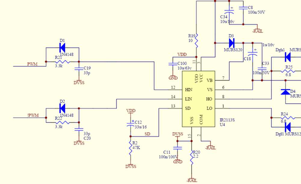

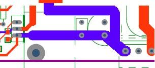

Would you possibly want to add C46 to your board to improve the turn on of your high side MOSFET?
Trying switch on your MOSFET with charge from the 10uF/C39 (I guess electrolytic or tantalum with a larger than wanted impedance at higher frequencies) I wouldn't think would be very good.
Edit:
Also I always though it to be good practice to run your power traces via your decoupling caps (C62, C64 in this case) to help isolate your DC buses from the high freqency current loops created.

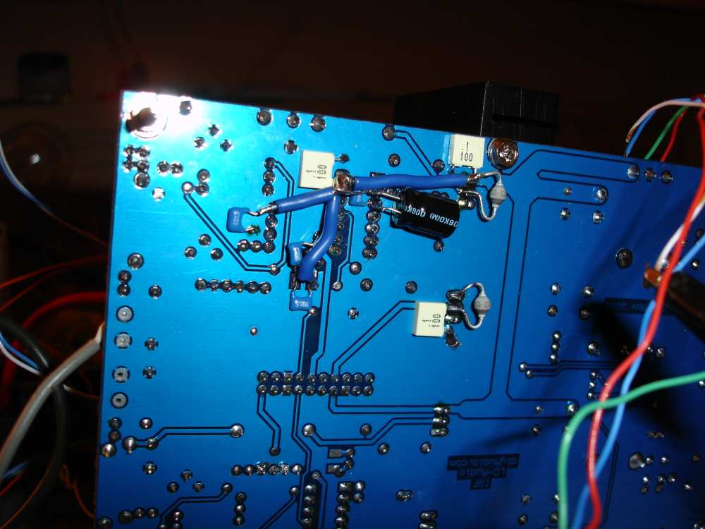

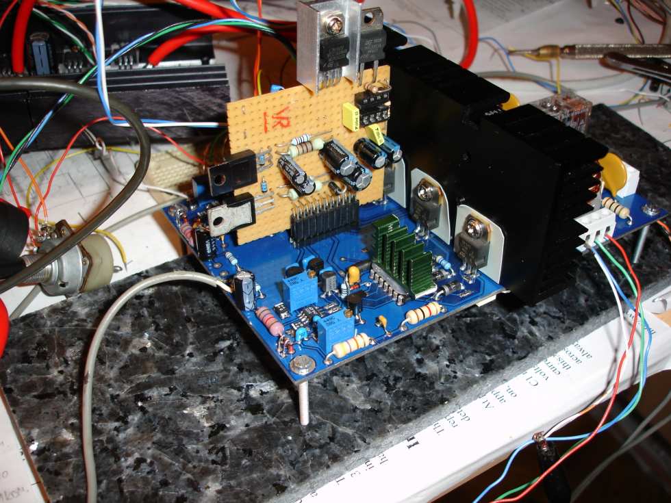

I did some improvement with 0.1 caps and some pieces of thick wire like you might see in this pic.
Now I am able to achieve 400kHz but I have around 40 deg. celsius on fets and 45 on ir2110 so I don't know what to do or think but one thing is for sure.
I would definetely gain some signal quality if I make some metal cage (or case) for oscilator and ir2110 to make them isolated from all outer side effects, since there are 80% chances that this all is due to pcb design.
And I added some clampig diodes but they do not improve anything.

is it ok to put some deadtime passive control like in this pic, cos. in this way turn on off time on fets can be short since I am inserting deadtime before ir2110 and he has some schmit trigger on all inputs, so this must not be the problem ?
I also supply logic side of 2110 with same 5V as I supply 7404 (little smd) and power side is supplied with 15V.
So my thinking is, if I get managed to insert dead time befor level/power shifting of 2110 then I may use lower vaule for gate resistor (like 10ohm or so) and make fets open/close faster to get lower dissipation.
But one thing confuse me, why I have heating on ir2110, do I perhaps have some power interferencing that makes him heat?

Hello zkaiser
Your approach seem good, but I suggest you higger value for your dead time cap and lower value of resistor to avoid parasistic pick up at the input of your 2110....Dissipation of the 2110 is directly proportional the the frequency and current feed to the mosfet...So try to reduce frequency to 250-300 Khz, that was enought by the way for audio if you take feedback after the output coil, and irf640 should be drived with 15-22 ohms gate resistor....By experience at 300Khz!

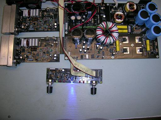

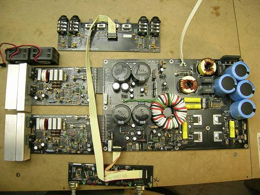

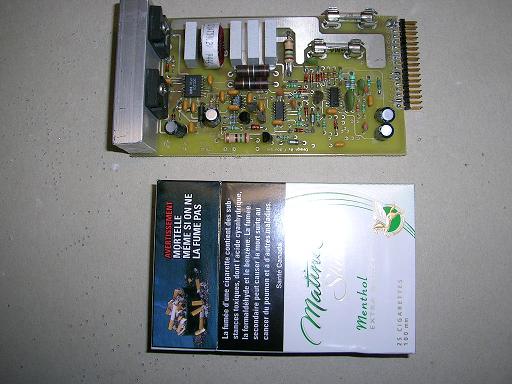

Hi have try lot of experimentation with IR2110 and have found that only work well with CMOS drivers. Lot of unpredictible thing with TTL and bad stability with passive component for dead time. At least if you make discrete arrangement with 2N7000 lo voltage mosfet, it could work well, but cost make me move to the CMOS. Another trick here, lot better effiency with a 555 charge pump for the hight side supply, better dissipation for the IR2110 and for my design, I have no choice because I'm in class BD, so minimum pulse was not enought to keep the hight side capacitor charged!
Have a nice day!
Fredos
Charge pump is referenced to the VS and coupled with capacitor in diferential mode to the hight side to avoid parasistics capacitance to the HV square wave...Differential signal is get with 3 2N7000 mosfet in inverter mode. That provide a constant 13V to the hight side with a 47uF on the hight side supply to feed enought current when amplifier is near 0% duty cycle! Gate resistor is 10 ohms with 1n4150 back diodes. A simple CMOS4001 with diode, resistor and capacitor provide dead time. I have run amplifier on 4 ohms load with music from 6:00H AM this morning at clipping, it was now 18:00H, ambient was 28 celcius and heat sink was at 32 celcius with 2 small fans! No fans on power supply and no heat sink on syncronous rectifier! Bit warm but normal! Really cool, I think I have discover something! Send me an email again Classd4sure, I could be interested if you have some experience with CSA certification! Most of constraint will be on the case design, so more a mechanical job than electrical....Board is already in production, is more easy to design board than design a CSA case!

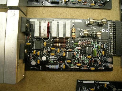

No I never see the schematics of the infinity sub...I have design this amp 7 years ago with all discrete component because IC was not affordable at these time....The simplest and most economical way was with PN output stage. The model 1600 I have design is similar, but have many improvement and more protection.
Anyways, it was simple and reliable, good effiency, so anyone who whant to make a first moderate power amplifier can make experimentation with this amplifier easily, with very good stability. The trick is all in the converter with the LM319 and the dead time controler.
