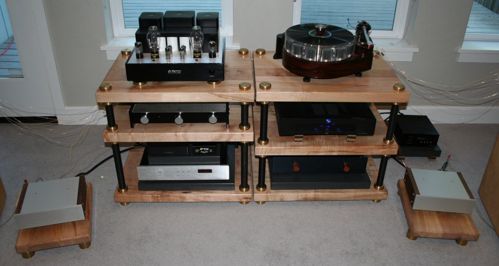

I have been messing with a DAC-60 for a while now, I believe the glare in the upper mid-range is from the SRPP stage. Try paralelling a 10K resistor across the output and use 330 ohms for Rk. I reduced THD 40%. Remember SRPP is good for one load only, falls apart above/below. Helped sibilance but still noticeable.
Unfortunately it isn't practical to fit a Aikido in the DAC-60 chassis.

<<Unfortunately it isn't practical to fit a Aikido in the DAC-60 chassis.>>
You must have noticed that from the last picture I posted.
I, however, have a secret weapon:
