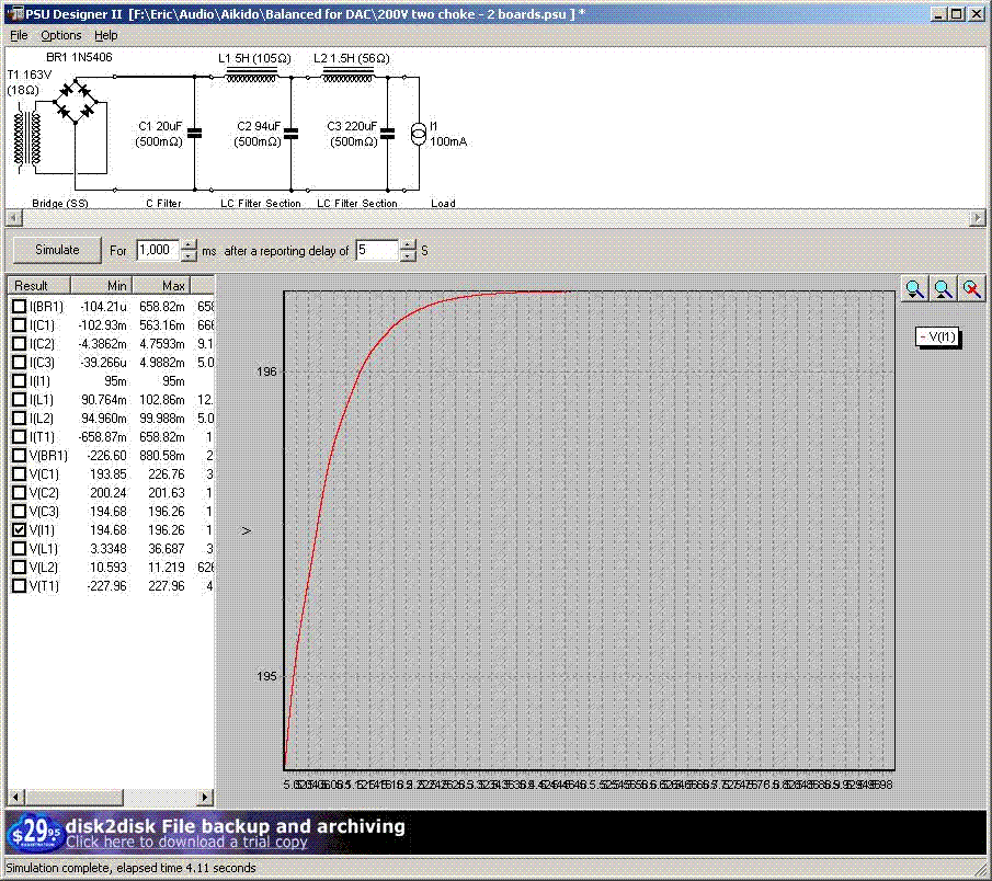

I'm in the process of assembling a pair of balanced Aikido boards and PSU to use with the Buffalo DAC.
Here is my PSU design, it leverages my existing stock of parts. I'd appreciate any comments.

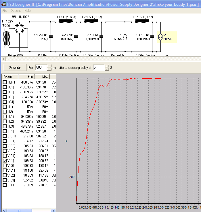

You are showing the initial response of your power supply in the first second or so. What you want to do is wait until the supply settles down -- in the first few seconds things are just coming up -- caps are getting charged, etc. The "reporting delay" box allows one to get out of the startup window.
The PSUD chart below shows the ringing of the I2 current tap with a 10% change in current demand. It should be a smooth response but it has a whole lot of ringing.
I'll post more later when I have more time, with some suggestions. You have a lot of parts to work with so I bet you will be able to come up with something good. Also, if you use alligator clips you will be able to move things around to see how changes effect the sound.

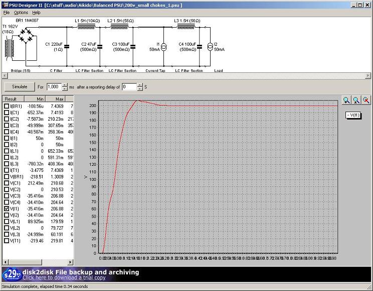

Hi Cappy,
The model doesn't accurately depict the planned implementation, the second LC stages would be in parallel, not in series. I don't know of a way to do a parallel model in PSUD.
Did you implement a step in the current source to generate that signal?

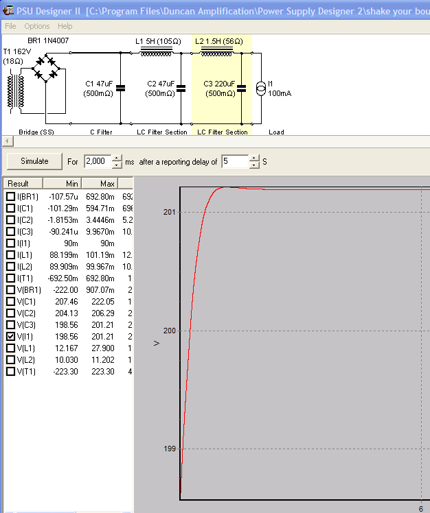

Here is a slight variation on yours that uses your parts and has the quick impulse response with the little bump I've been looking for in my power supply experiments. It has a bigger first cap (47 uF) and a smaller second cap (47 uF). If you use alligator clips you can easily try both supplies to see what you prefer. It gives a few more volts B+ too.

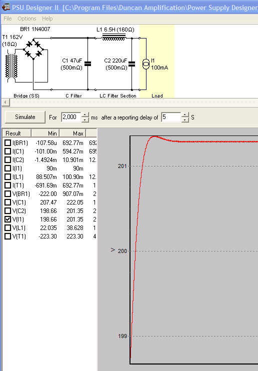

Here is another one to consider, a CLC. I have some gear with CLC supplies and know they can sound excellent. This particular one has the quick impulse profile with bump. Ripple rejection isn't nearly as good as yours. Still, I think this is worth trying. Simpler sometimes sounds better.
The 6.5 Henry choke is made up of your 5 and 1.5 henry chokes in series.
Putting a 100 uF cap in the first position lowers the ripple and maintains the impulse profile, so you could try that too.
