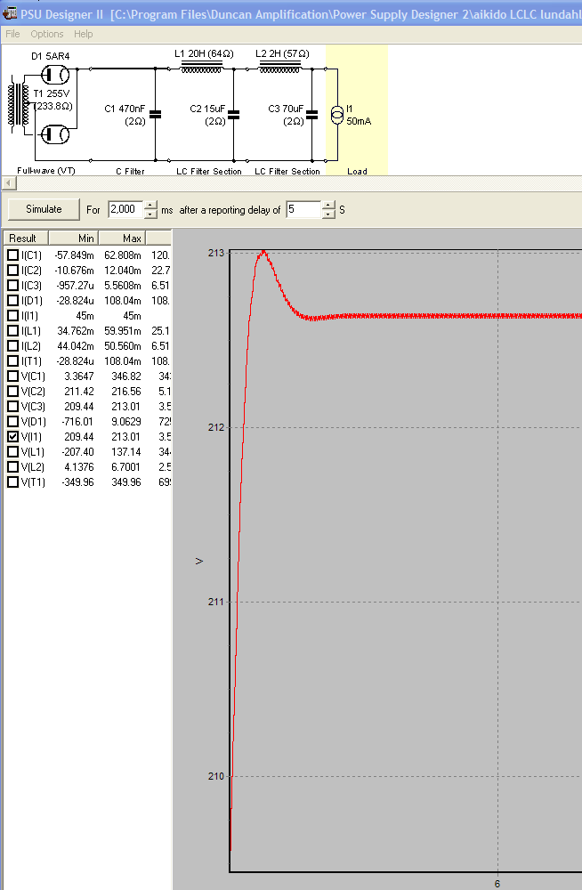

Y A A B - Yet Another Aikido Build
The idea to stick in the oil cap as the first transitional cap came from some posts I read from Dave Slagle.
That worked out well, so I went looking for other Slagle power supply ideas. On Dave's forum I read a post where he suggested to a DIYer to remove his final LC cell. And on his index page, he says "We have had great results with CLCLC power supplies with the first choke being Amorphous and the second choke being Nickel."
So even though I had to move around some alligator clips, I decided to make the two minute herculean effort to pull out my last LC stage and make it a CLCLC.
This turned out to be a good win. There were noticeable gains in tonality, frequency extension, and dynamics. Obvious gains, not requiring any back and forth checking at all. Definitely a bandwidth bottleneck removed.
Plus the power supply is smaller and cheaper by removing a big capacitor and a small inductor. I did end up using the 70 uF Oil Obbligato Oil/Film as the last cap instead of the 47 uF Obbligato Film as I thought it sounded better in my circuit.
So the new CLCLC supply with the current Soviet Special Aikido is "Configuration D". As usual, I'm following the Swenson methodology for getting a good impulse response.
Ripple is higher, of course. PSUD simulated ripple is 20+ mV. Interestingly, actual measured ripple is only 12 mV and steady on the scope. This is higher than the previous supply's 3-4 mV but sounds subjectively ok to me on horns.
The only downside, other than a touch more hum, is a bit of sizzle in the treble but I believe this is the class-d amp showing it's true colors. I'll revert back to my 300b amp soon.
Given that Dave's first two suggestions worked well, I'm guessing using an Amorphous core first inductor and Nickel core second inductor would be good too, but that is $$$ and must wait.
When I get my courage up I'll try running some FFTs. :)
Here is the new supply showing the 10% change in current. Note impulse response is quicker than the previous supply.
