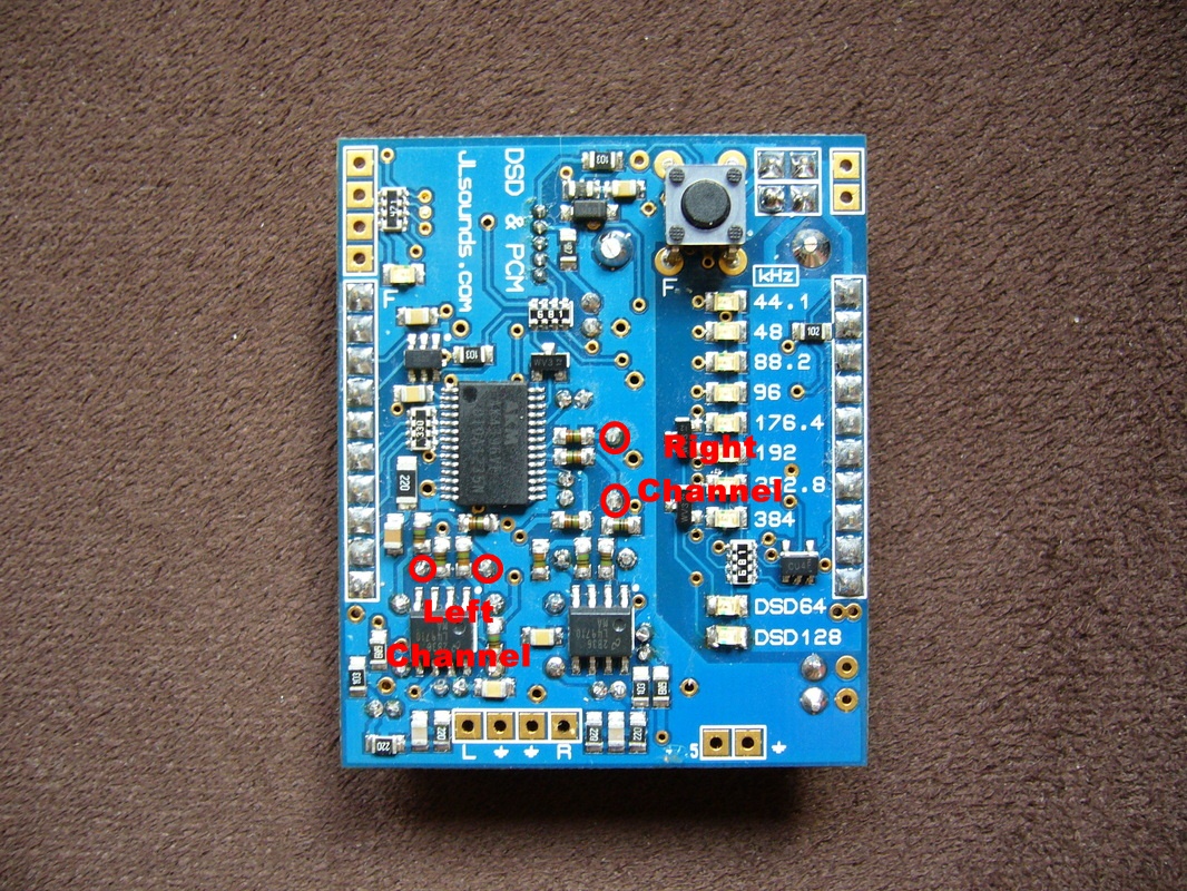

@Joro : Hi Joro. In case you don't remember, I was the one asking if it would be possible to purchase the AK4396 board without the output stage. Could you point out which components in the DAC board correspond to the boxes in red and blue (image attached)? After I've broken in the DAC board and have a feel of how it sounds stock, I'll remove the output stage myself, and connect my experiment(s) to the pads left by the resistors in the red box.
Hi taisho_daniel,
it is easy to tap into dac outputs, look at the picture. That is right channel in red square, left channel is underneath the board.
Hi taisho_daniel,
Thanks mkusan. The other channel was what had me confused, I thought it might be part of the cluster of MELF resistors near the opamps, didn't think to look underneath the board.

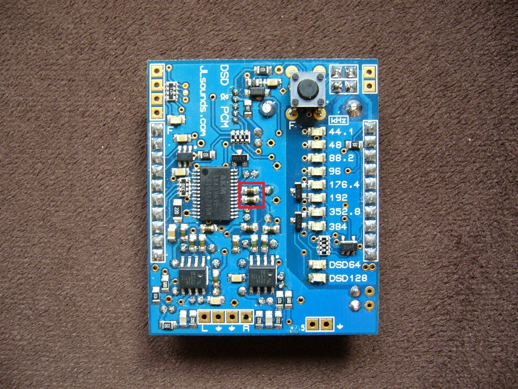

About the blue box in my earlier diagram, the reason why I asked about it is because I wanted to remove the opamps from the board once I have my own output stage going on. Would it be ok if I just removed the opamps, or should I remove the support circuitry as well?

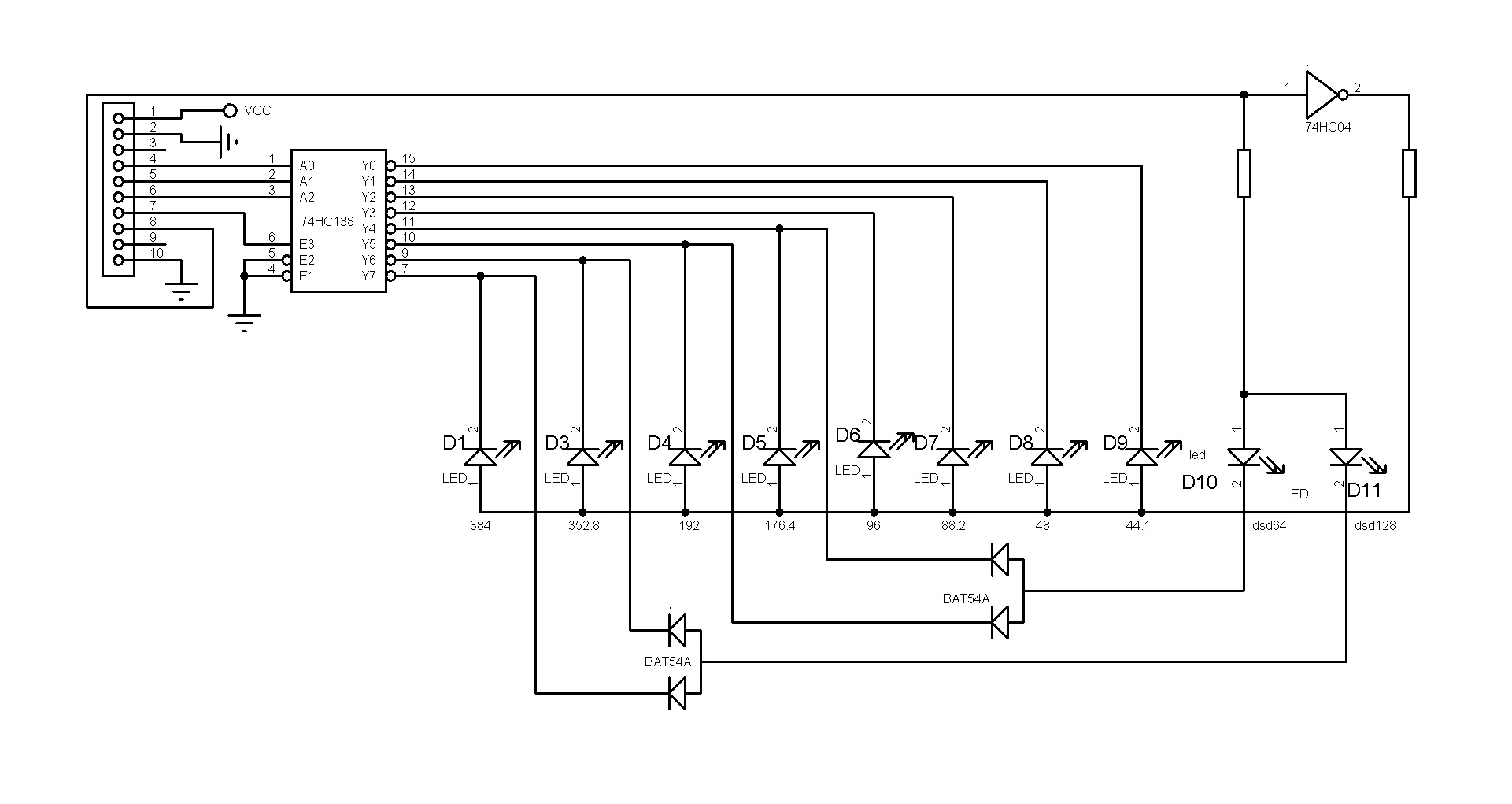

How can i get signals for front panel LEDs about frequencies and DSD64/128 (AK4396)...
I attached you a scheme, which will help you.

@Joro : Hi Joro. In case you don't remember, I was the one asking if it would be possible to purchase the AK4396 board without the output stage. Could you point out which components in the DAC board correspond to the boxes in red and blue (image attached)? After I've broken in the DAC board and have a feel of how it sounds stock, I'll remove the output stage myself, and connect my experiment(s) to the pads left by the resistors in the red box...
If you remove the resistors in the red box you can use the outputs directly. However, my recommendation is on their place to be soldered 0ohms resistors, because the pads are very small and they easily could peel off, and you can use the holes of the 1.5n capacitor to solder the wires. You heve to remove all MELF resistors on both sides of the board. This will be enough to have a completely free outputs.
mkusan is right for the places of 1.5k resistors in the red box.
The recommendation of mkusan to remove the op-amps for this mod is OK.

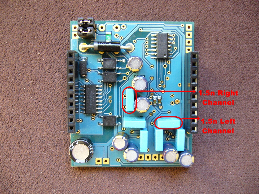

Hi Joro,
What's the package size of the MELF resistors? I want to go ahead and order some 0r resistors online.
Also ... I'm pretty sure where the 1.5nF cap for the right channel is, but I'm not too sure about the left channel. Can you show me where on the board this is?

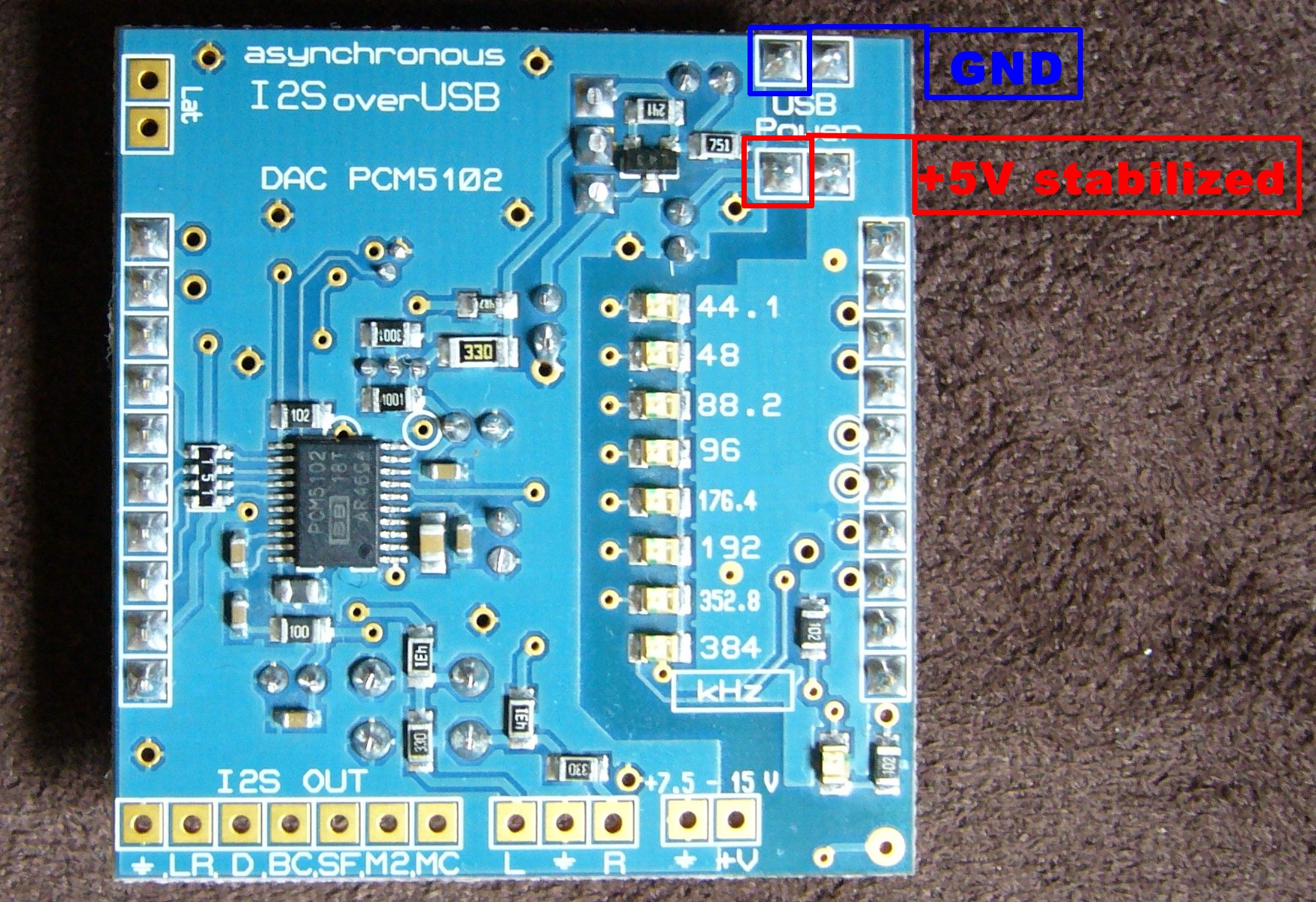

* I forgot: Why do Joro need 7.5V again? The 5102, clocks etc just require 3.3V.
The 5102 comes with internal charge pump for +/- 3.3V. Is there no way to feed
the isolated side with 5V?
* Has anybody tried to bypass the output filter ?? I'm wondering how much of use of is!?!?
The datasheet considers it also as optional as it seems.

...What's the package size of the MELF resistors? I want to go ahead and order some 0r resistors online...
In a previous post I gave part numbers of the elements. There is a complete documentation for them :)The package of MELF resistors is 0805. You can use this resistors: digikey part number MCU08050Z0000ZP500.
I attached two pictures, which will help you.

As far as raise the topic of the electrolytic capacitors on the board Ak4396 board (and PCM5102 board), they all participate in analog circuits. By changing the type of capacitors, you will change the sound signature. Polymer capacitors (Oscon) in this case are not suitable (due to their participation in analog circuits) - they will lead to degradation of sound, IMHO.
I looked at the board of the PCM5102 and for those who wants to feed the DAC, not with 7.5V, but with stabilized 5V :) can do this as on the attached last picture.
