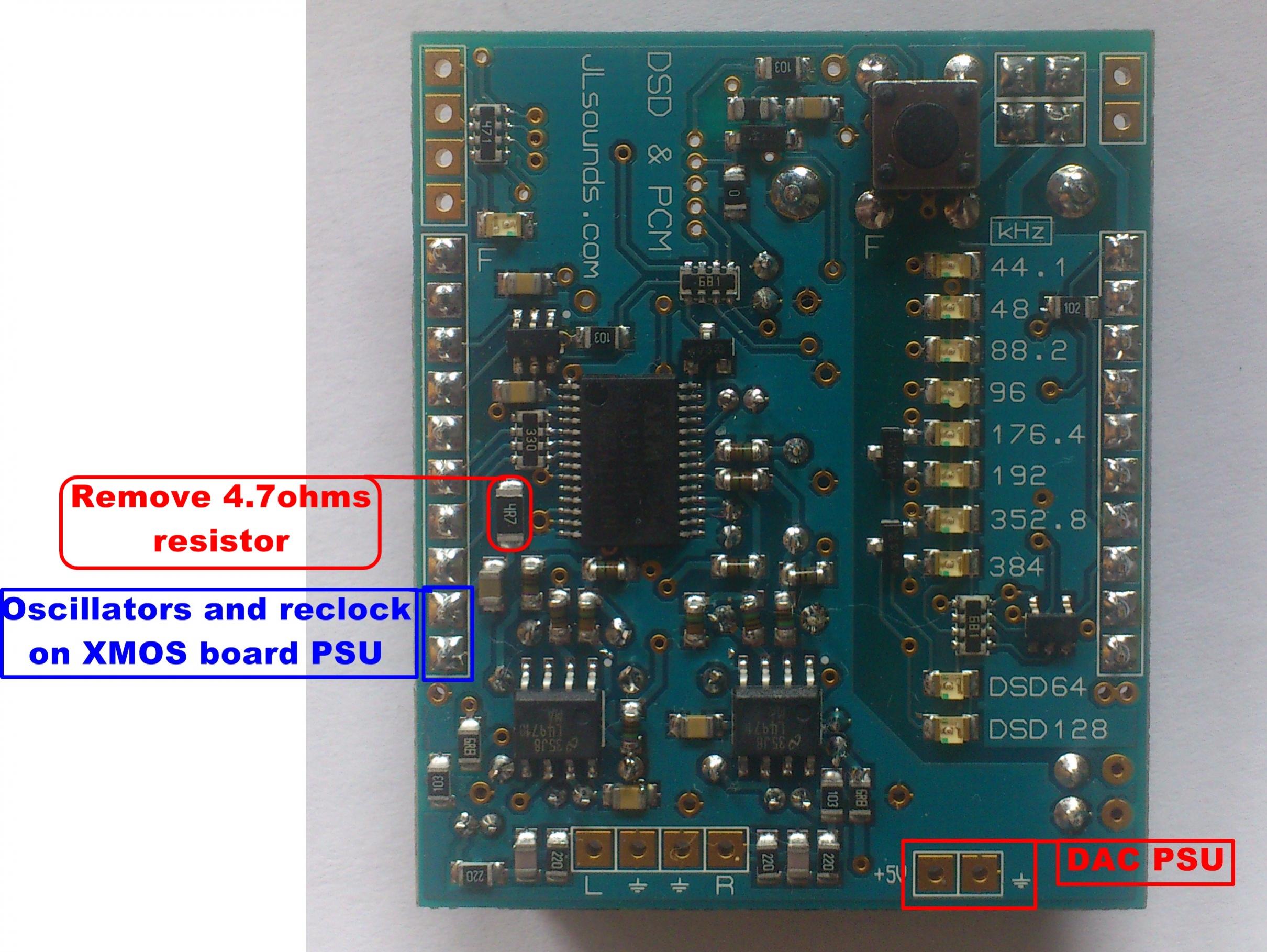

Could you please clarify: you want to feed the oscillators and reclock with other 3.3V regulator (or with two regulators), or you want to separate the DACs' power supply form power supply for the oscillators and reclock?
Joro
Chris1967 thank you for your feedback.
...If I would like to install a separate preregulator only for the reclock and oscillators what would be the necessary steps?
Joro
I would like to separate the DACs' power supply and introduce one preregulator for existing power supply related to the oscillators and reclock.
Now I get it
I attached you a picture.
Joro
Now I get it

Power consumption
Hi Joro,
In order to properly implement the separate regulation for the oscillators and reclock what is your estimation of the total power consumption of these parts?
USB board draws about 335mA and AK4396 board up to 111 mA, right?

Why don't you measure voltage drop across that 4R7 resistor and calculate current from there?
Regards
Marko
The reclock and the oscillators consume around 60mA. The AK4396 DAC consumes around 60mA. It's good to have 10 to 20% reserve.
Yes, you are right. The USB part consumes around 335mA and the AK4396 DAC and the oscillators and the recolck on the XMOS board consume around 120mA.

...If supplied separately like this, how much would each (the DAC board / reclocker) need in terms of current?
...USB board draws about 335mA and AK4396 board up to 111 mA, right?...
