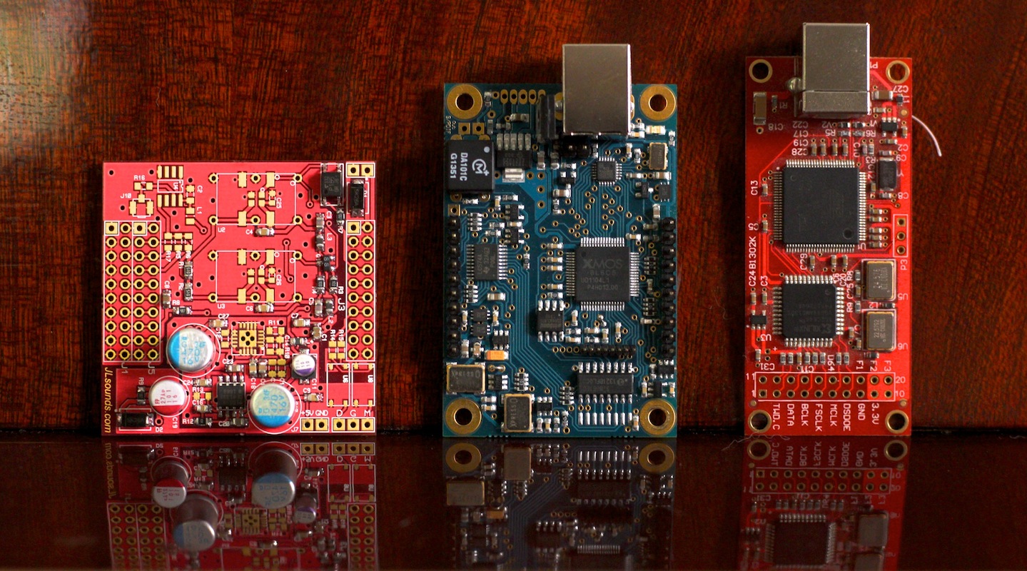

I have received the boards. It was a super fast shipment. Thank you!
First impressions are very positive though i used SPDIF and ordinary psu on 7805 and chip dvd player.
I guess with proper psu, i2s and external clock it will leave very very little if anything at all to be desired as the transport. I smile when i think of 7k esoteric or dsc cd player.
I used it with MacPro and Macbook pro without problems.
(i added amanero board for comparison)

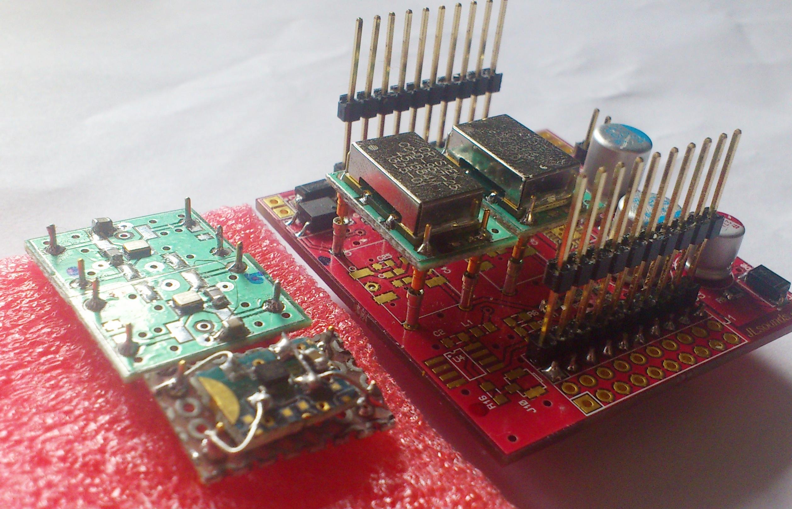

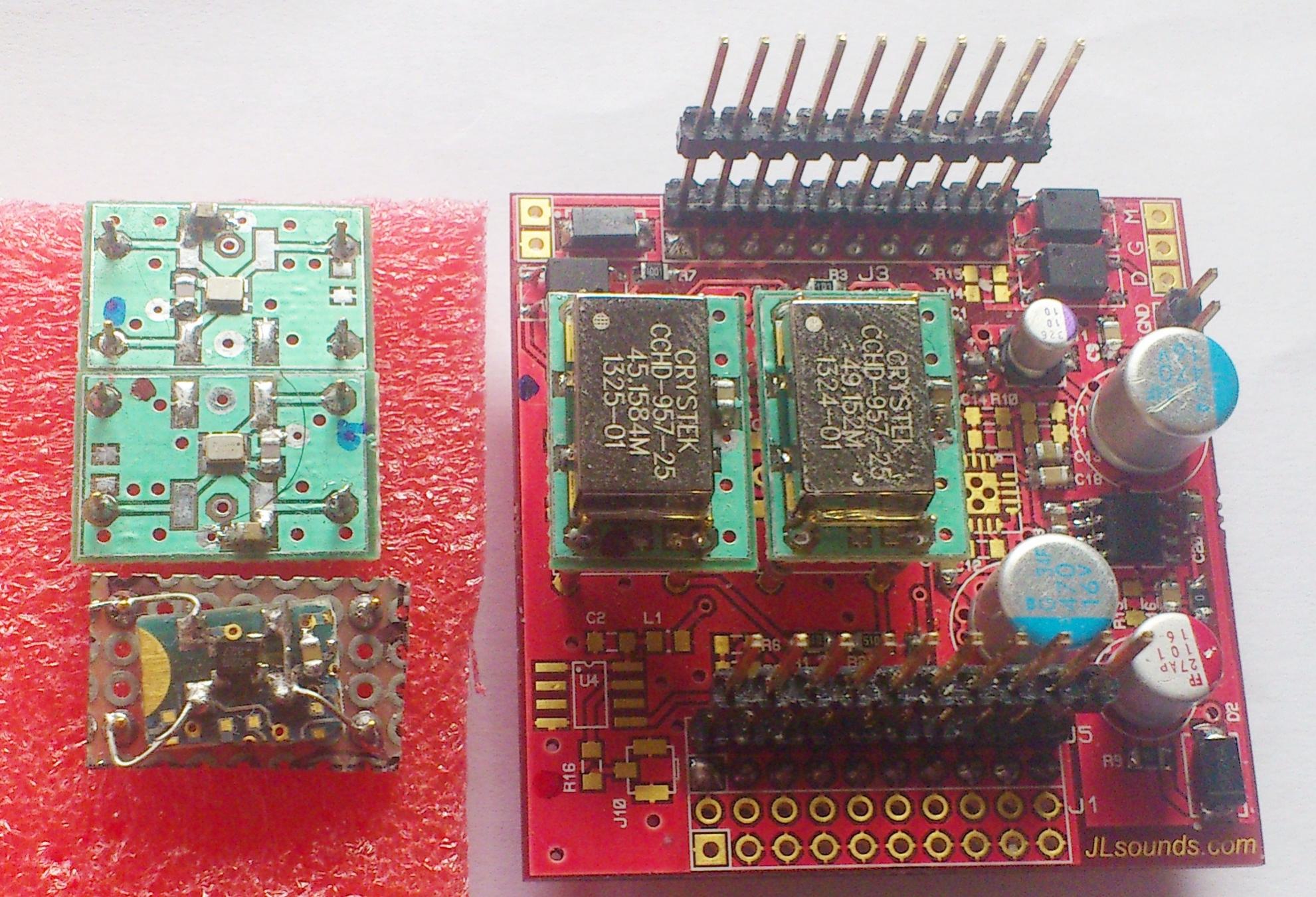

Maybe it will be better if I join the deal about the oscillators daughter board.
This board was designed about two months ago, and till now many listening test were done (and the tests are continuing) with different people. The board was performed at the annual expo of the bgaudioclub.
Generally the board was designed as a daughter board, so one can use precise oscillators. The oscillators may be powered by TPS7A4700 or ADM7150. I prefer the ADM7150, because it has lower noise. One can use CCHD-957, NDK NZ2520SD, DIP14 and DIP8. There will be listening to a SI504, but I have to finish the firmware for the initialization of SI504
You have to use USB Audio Player PRO and an external power supply for the whole board is a must.
No problem at all to connect the XMOS board to ES9023.
Connecting the 2 GNDs lower the quality, because we lose the galvanic isolation. I recommend to use one external power supply for the oscillators and reclock, and when you use your phone, you can make a custom USB cable on which you are going to have 5V.
Joro
