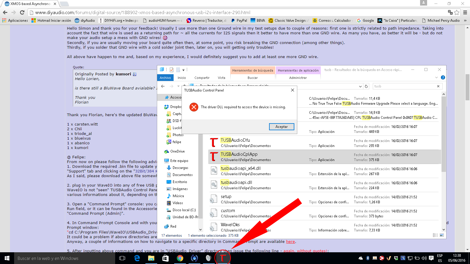

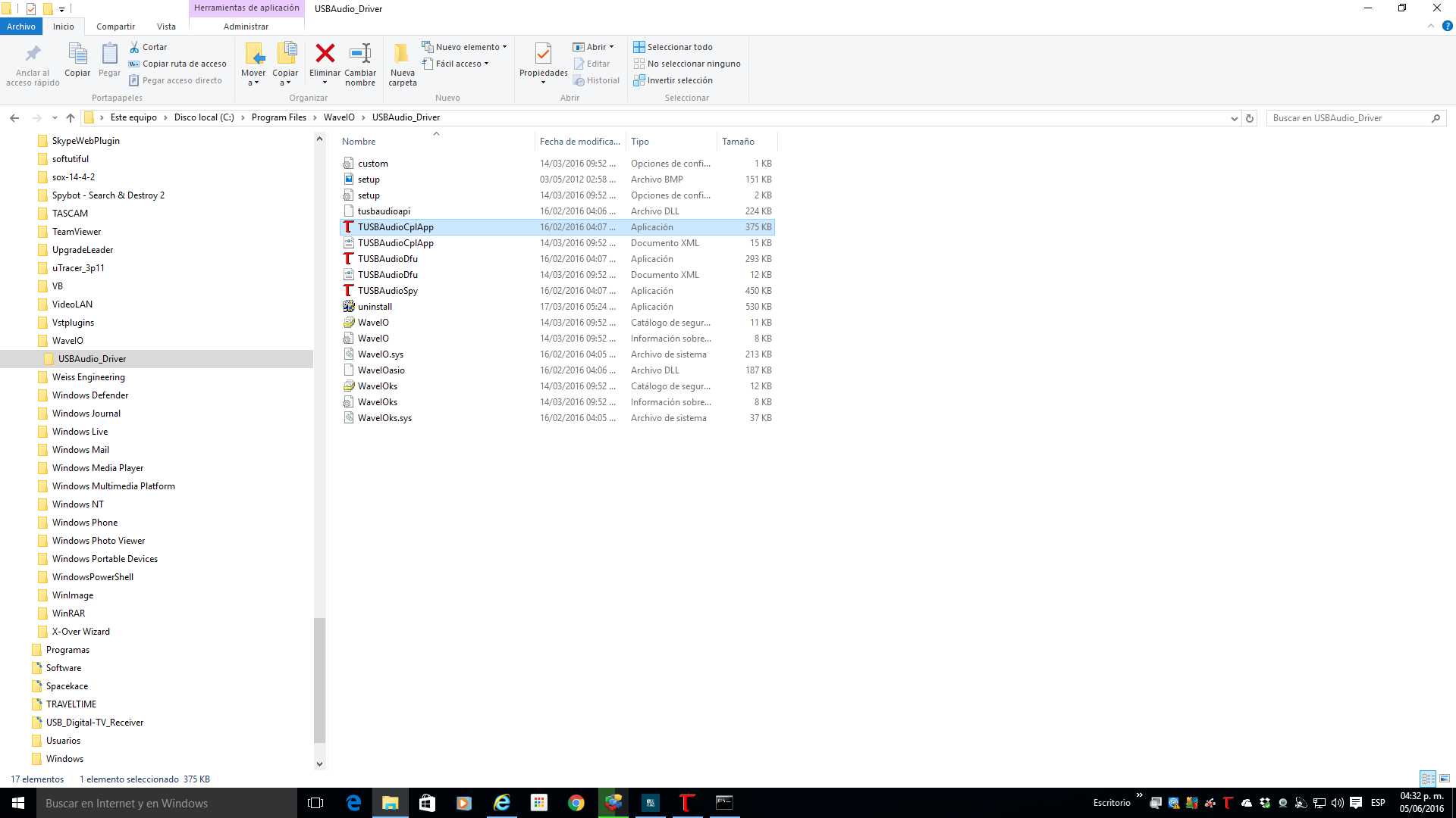

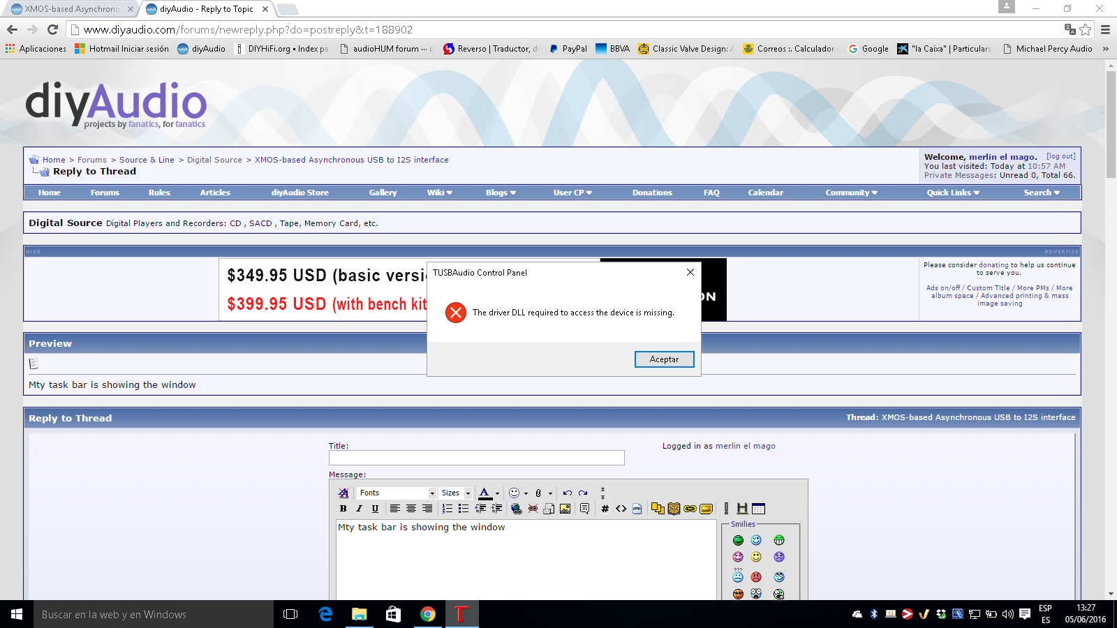

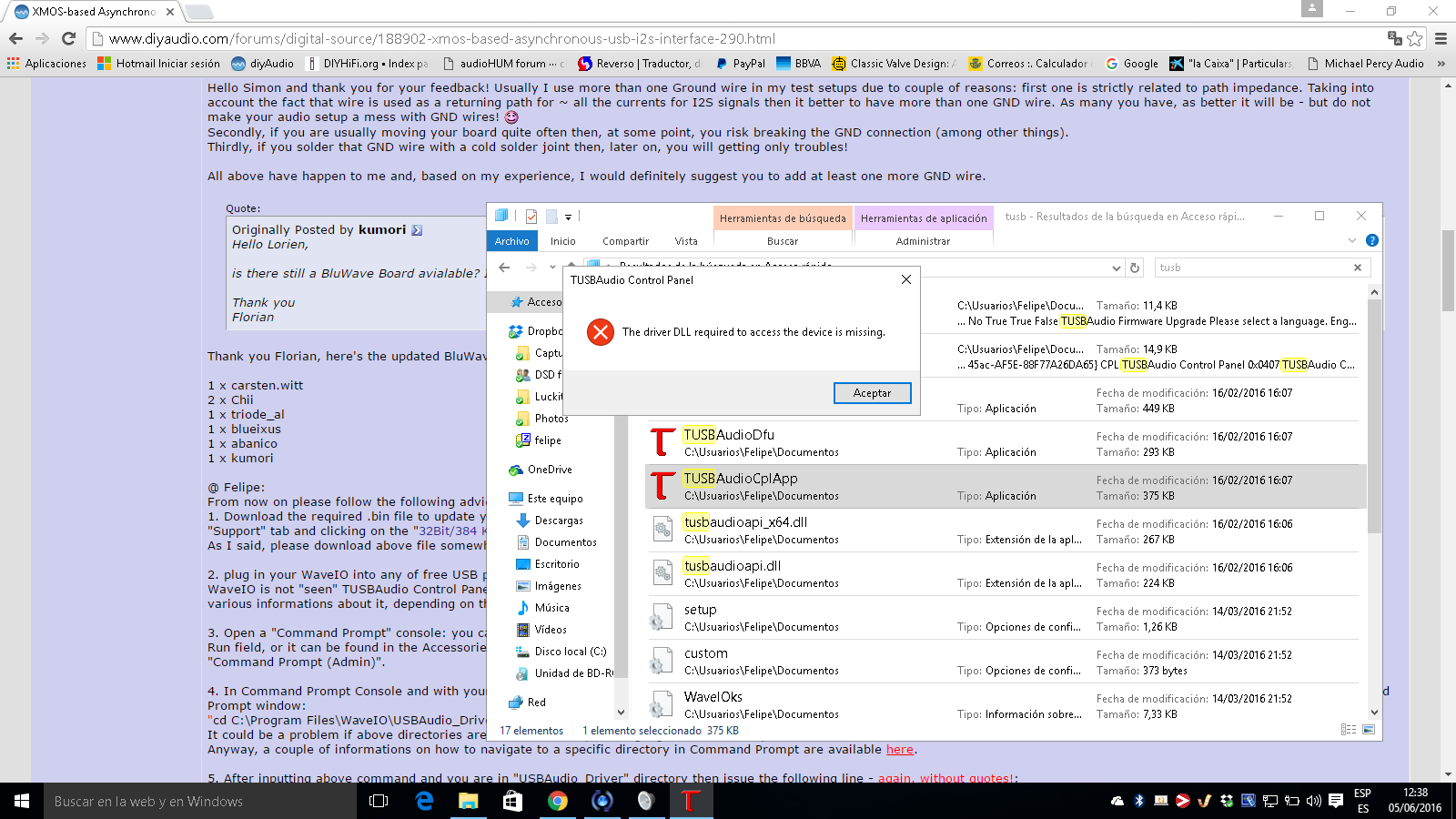

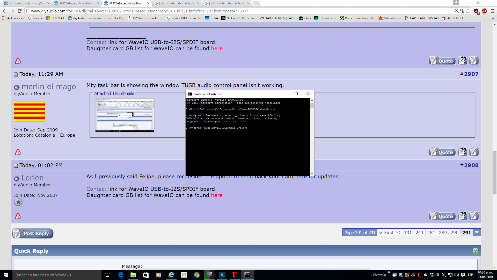

browse to:
C:/Program Files/WaveIO/USBAudio_Driver/
and run "TUSBAudioCplApp.exe"
From what I can see, it's already running on your PC since there's the appropriate icon present on your taskbar (see below).

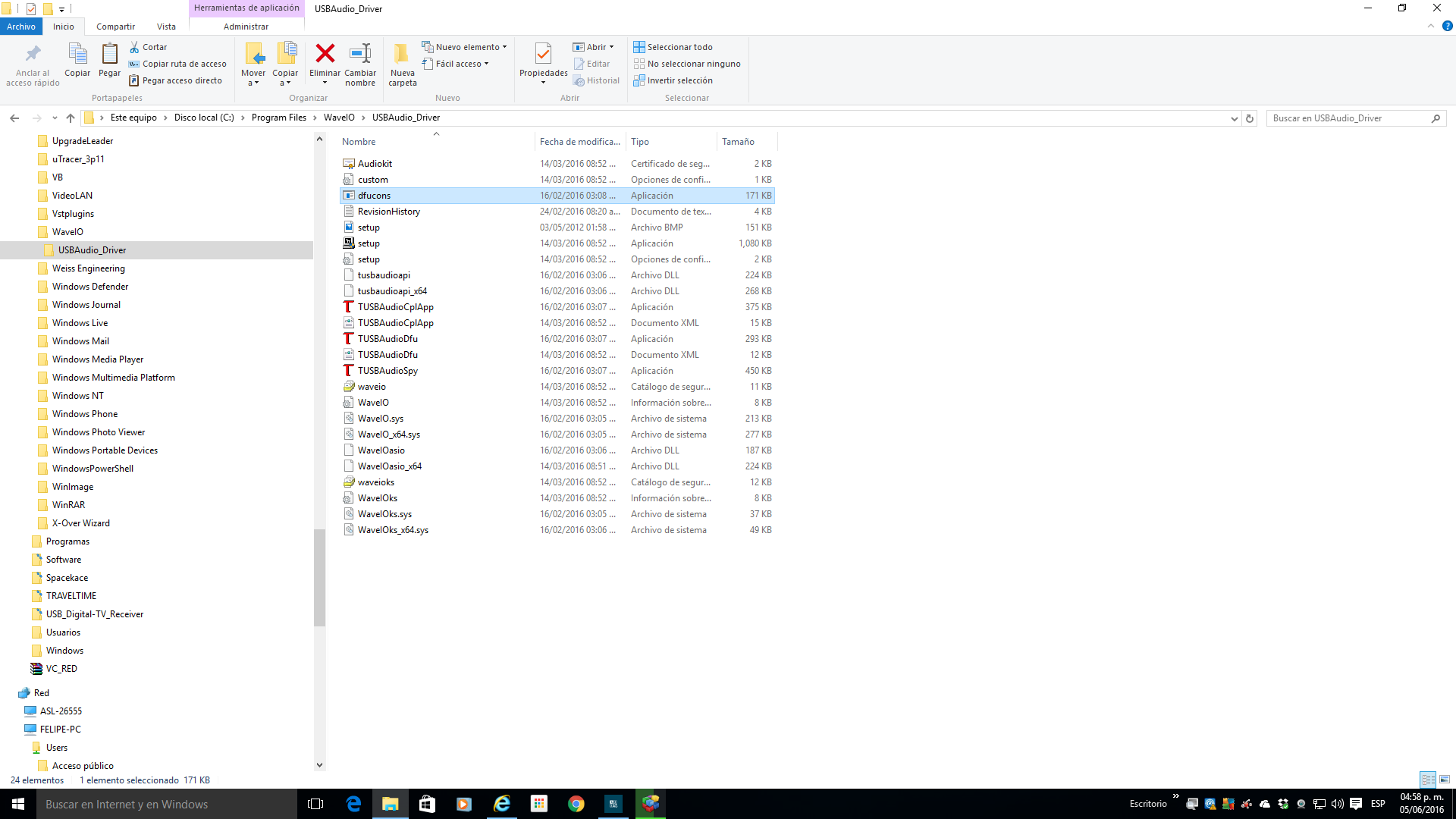

If drivers are installed and "dfucons.exe" file is copied then from now on you have to forget about files from driver's archive I gave you. For now you'll only work with those from Program Files / WaveIO / USBAudio_Driver

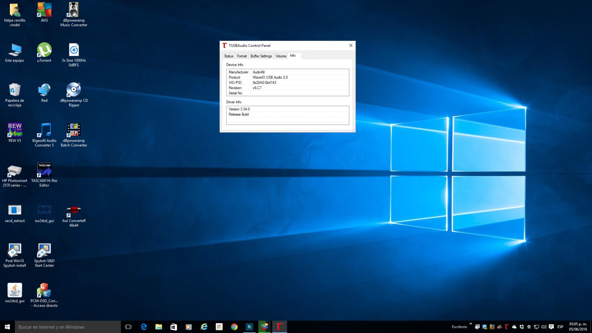

Hi Lorien,
Under my Win 7 SP1 64-bit OS, the only driver that works is v2.26.0
It seems that v3.26.0 and v3.34.4 packages have 2 drivers each, that are not certified. If I install these drivers, the WaveIO card does not get recognised. Maybe you have certificates that I need to install first, before installing the drivers?
Nick
Nick, please stick with 3.34 as it's valid but you need to install a couple of KBs on your Windows 7 OS to cover up the changes made after the Heartbleed bug problem which affected the SHA1 certificates.
Please follow this link and your troubles regarding WaveIO drivers on Win7 should be over!
Keep us updated on your progress,
Lucian
