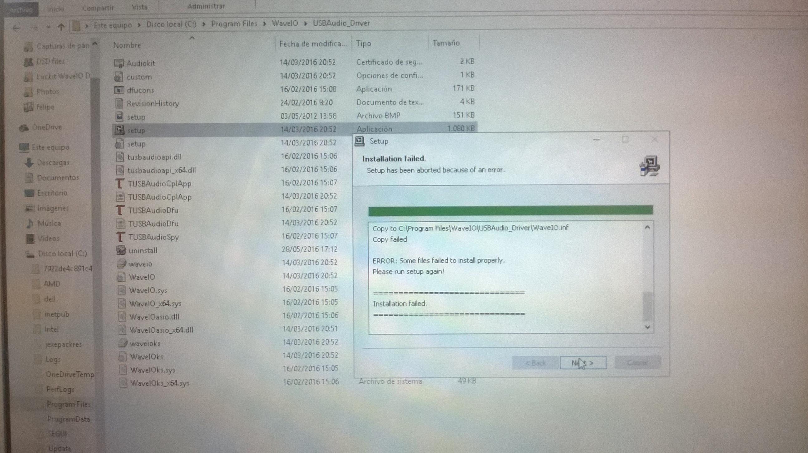

Connected the WaveIO board but laptop doesn't recognize.

Lorien your link said:
"A. Like I said before, you can use any WaveIO available to you that has the
Revision ID higher than 0x0330 for the DFU functionality to work! The
0x0330 variants are not working (no DFU enabled in firmware) and will act as
a brick in your tests!
Revision ID can be easily found by plugging your
WaveIO into any free USB port and open "TUSBAudio Control Panel". There
should be an "info" tab on the right saying RevisionID and Serial Number.
Please ignore serial number, just follow the revision ID value."

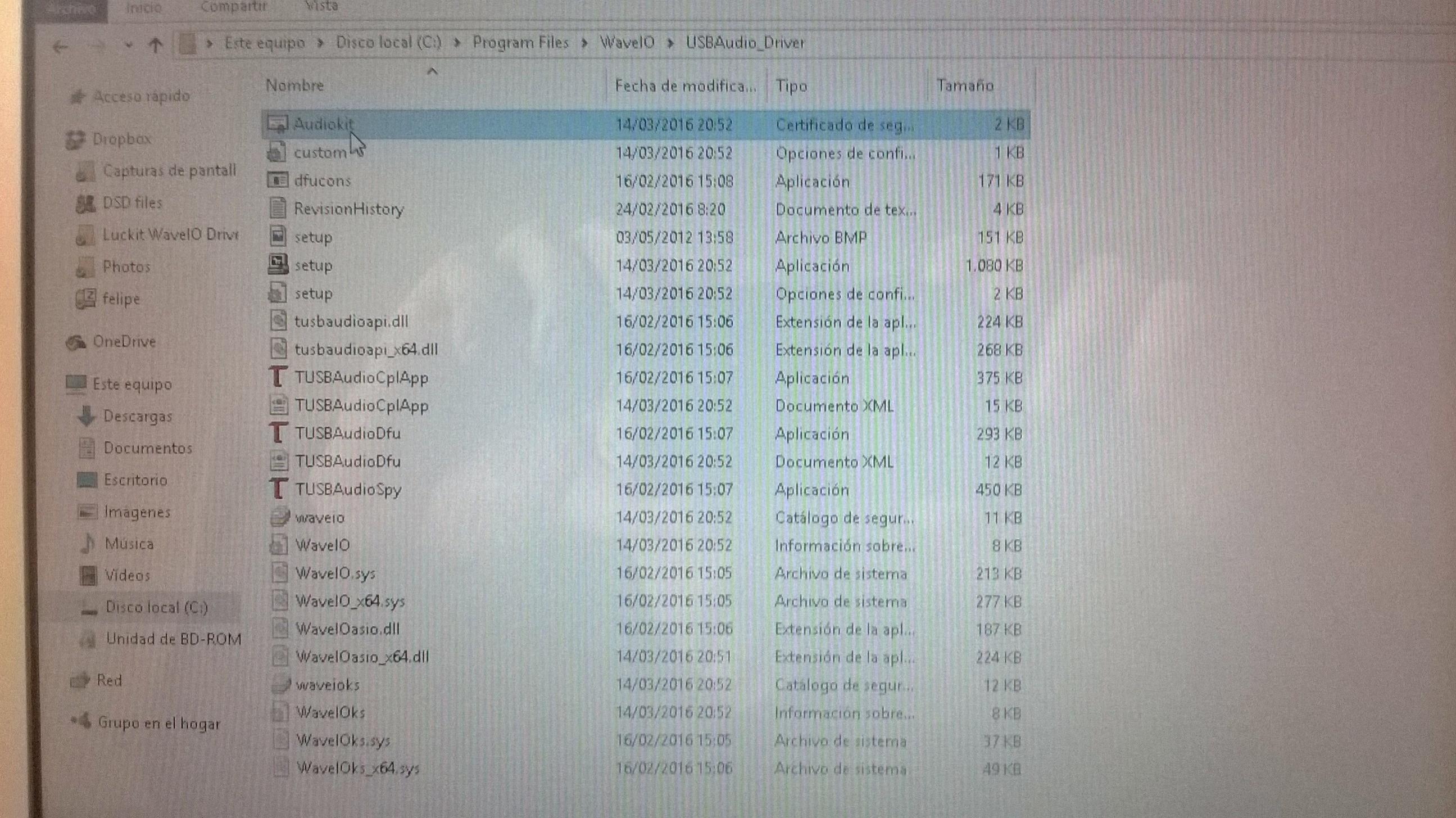

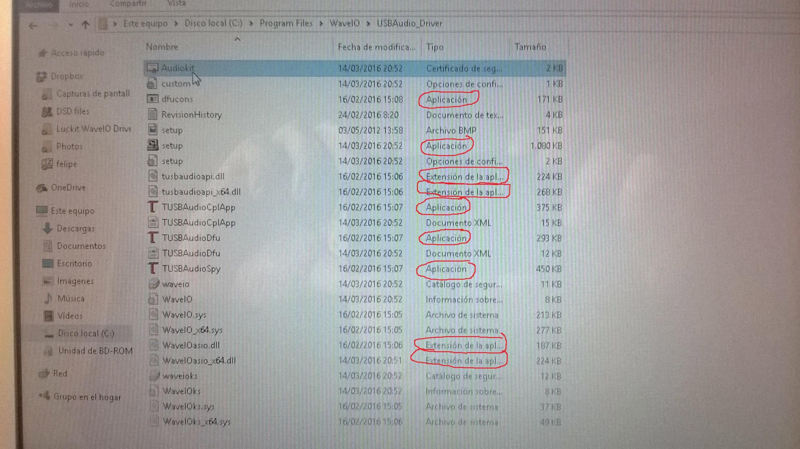

As I can see by looking at that picture, it seems that you didn't install WaveIO's drivers. At least, there's no trace of any files that are related to this driver pack and usually are installed / copied to that directory.
Make sure that you are installing WaveIO drivers first and then copy the dfucons.exe to where the drivers are installed... usually C:/Program Files/WaveIO/USBAudio_Driver/
Felipe, as I can see, you have unpacked the files form the WaveIO driver's pack I gave you to exactly the same path where the installer will place the driver files.
So, the source of those files and the destination is the same. It's normal for you to get an error when you are installing WaveIO drivers.
Just delete this directory: "USBAudio_Driver" from the path:
C:/Program Files/WaveIO/UPSBaudio_Driver and forget it for now.
go to archive I gave you, unpack the archive to ANY directory you can think off except the one listed above and run setup.exe
After that we will move on...

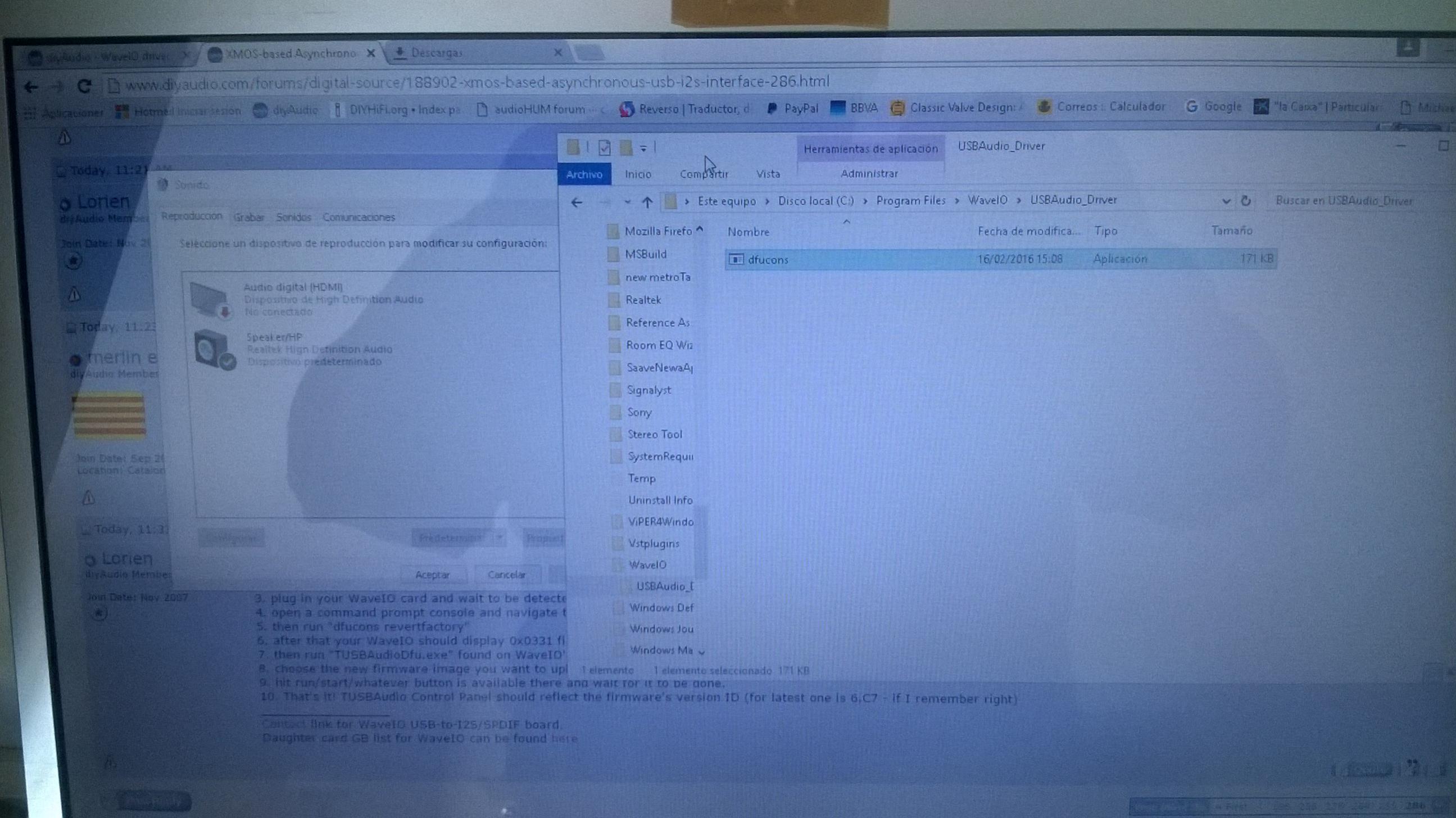

@ Felipe: so do I have to understand that you managed to install your drivers but what revisionID does your WaveIO shows now? Check at TUSBAudio Control Panel => Info tab.
