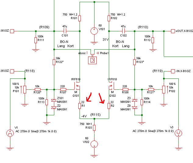

I have now replaced the 10k input resistors with 12k, and feel it was another step in the right direction, but I still have lots of gain.
Should I use lower output R's? Or go lower on feedback R?
Another Q; the volrage regulators are HOT, is it the pre-amp load, or the high input-voltage that makes the heat?
And, if it is the voltage, would it be ok to increase output to 65 or 70V?
Arne K

In my opinion, if we control the amp gain by adjusting R101 and R102, it will affect the bias current. How about if we think of the structures below Q101 and Q102 in the same way as original Pass BOSOZ? If so the adjustment of the gain will be easier without affecting the current bias value.
Hi jh6you
No! Only the DC level at the drains.jh6you said:In my opinion, if we control the amp gain by adjusting R101 and R102, it will affect the bias current.
Yes, it will be easier using R15 in the original bsoz configuration, and yes, the T-tail as I suggests will affect the current bias, but oly from 37.3 to 36.8 mA, so nothing really, and it brings down the gain to the half.jh6you said:How about if we think of the structures below Q101 and Q102 in the same way as original Pass BOSOZ? If so the adjustment of the gain will be easier without affecting the current bias value.
Not much loss, for less gain...
BTW, would it be ok to increase voltage (to increase bias) and to lessen the load on the regulators?
Arne K

Arne,
it´s very simple to decide for yourself. The power dissipated in the regulators is (Vin - Vout) x bias.
Bias = (Vout -4) / (source resistor).
So if you up the voltage bias will go up. Say you go from 60 to 70 Volts:
Pdiss = (80-70) x (66 / 750) = 0,88 watt
before ist was
Pdiss = (80-60) x (56 / 750) = 1,49 watt
So changing the voltage will reduce dissipation in the regulators (do you use heatsinks?) and up dissipation in the amp from:
120 x (56/750) = 8,96 watts
to
140 x (66/750) = 12,32 watts
Just change the values for the one you have
William

Hi Arne!
My advice, try to live with the heat or ad heatsinks one way or the other. BTW I suggests you uses a set of regulators pr. channel also for better heat dissipation.
Regards
It is determined by the voltage and the load.Cobra2 said:Hi, Henrik!
I just wondered about the heat in the regulating mosfets were a result of high voltage from trafo or just (bias)load from pre-amp?
You could, but then you will get the heat at the gainstage, and your filtering from the regulator may be poorer.Cobra2 said:And then, if it is because of voltage, would it be ok to "adjust" a zener to get say +-65 or 70V?
Nice that you like it, and I hope you will succed.Cobra2 said:(BTW, it sounds good, great work, Henrik)

guessing heatsink temp is a bit difficult, better measure it.
70°C at 1 watt dissipation doesn´t seem that bad. Look at the datasheet for max. thermal resistance junction to casing and calculate your junction temp. In this case 2.9°C/watt so your junction is at 70 + 1,2x2.9 = <75°C wich is around 75°C below the upper limit.
This looks like a safe distance
william

I agree with you.wuffwaff said:guessing heatsink temp is a bit difficult, better measure it.
I have also wonderd about this, but Nelson and many other has stated, that the absolute max. heatsink temperature would be 60 degree, and the optimal 50. The explanation for this were the shorter liftime for the devices. I have never tried my self to test this, but I like to be on the safe side.wuffwaff said:70°C at 1 watt dissipation doesn´t seem that bad. Look at the datasheet for max. thermal resistance junction to casing and calculate your junction temp. In this case 2.9°C/watt so your junction is at 70 + 1,2x2.9 = <75°C wich is around 75°C below the upper limit.
william
BTW The Junction to Ambient is 40 degree C, so if the ambient is 35 degree C you don´t need any heatsink at all in order to keep a Junction temperature at 75 degree C.
But anyway You might be right on this one, I don´t know.
