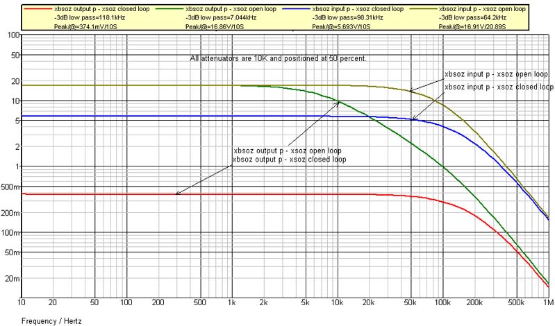

Here is a link to my xbosoz and xsoz.
http://www.diyaudio.com/forums/showthread.php?postid=67322#post67322
In the xbsoz scematic I forgot to draw C3 and C4 from the original circiut, they are most certainly needed.
Hello Henrik,
Is there any particular reason that you use the attenuator at the input (P1-P2) for you X-BSOZ? Why not put it at the output (P3-P4)?
Does the X require a fixed output impedance (in order to operate optimally)? I know that output impedance will vary if P3-P4 changed.... so I guess you're avoiding the impedance variation.
Is that correct?
Is that correct?
Hi sianturi
Yes, the attenuator is placed at the input of the xbsoz to keep the outputimpedance of the xbsoz as low as possible. This becauce my xsoz has a very low inputimpedance at 120 Ohm. Any variation in the driving sources (xbsoz) impedance will cause variation in the amount of x-feedback in the xsoz and also some change in the frequensy responce.
The attenuators are the standard to ground.
I am working on a new and better attenuator for the input of the xbsoz.
