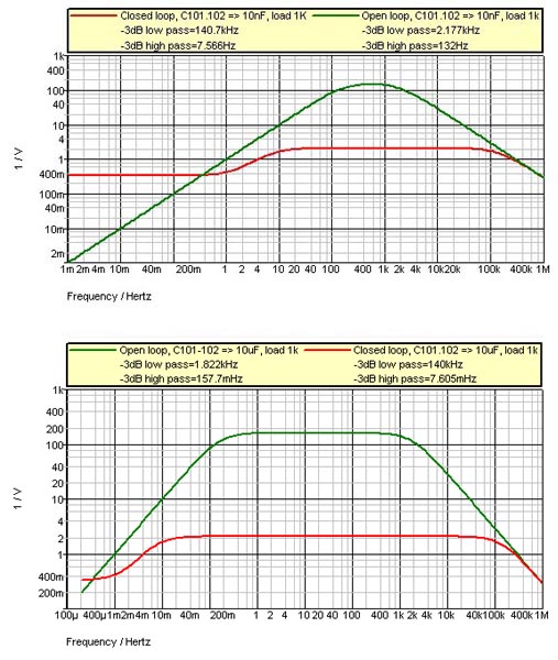

Hi William!
Some nice amp you have made, real nice work, PCB and all.
I have compared my xbsoz directly to an bsoz and an NLE, and xbsoz is better in all parameters in my oppinion.
It seems you are not quite satified with the sound, and as you mention, some brakein might correct this.
But one thing is comming into my attention, and that is your attenuator that shortens the output at your xbsoz. As I recall, Mad_K (or some one else) tried this way of attenuation and was not at all satisfied, that is why he went back to use attenuation to ground as I also did. So this coud a be part of your problem.
The output caps (C101 and C102) passes through the lower inverted frequencies, and then they will be fed back through the resistors (R122 and R123) and then attenuate the noninverted input as much as the shunt resistors (R120 and R121) allows. But at some point on the frequensy scale, the cap (depending at the value) will begin to act as a resistor, the higher the frequensy the higher the resistance becomes, and hereby lowering the feedback acordingly. But when the NFB is lowered the gain at the drain raises, but lowered again by the resistance of the outputcap, and thus the gaindvice keeps the gain close to constant within a wider band of frequencies. As long as the cap let some current flow through the feedbackresistors (R122 and R123) the gaindevice will compensate for the lack of gain, until the maximun gainlevel of the gaindevice is reached. From there the frequensy responce falls at the output.
If you look at the attached file, the upper and the lower graphs shows the gain as amplitudes at different frequencies in open and closed loop (open loop is when R122 an R123 is disconnected, not shorted). The difference in closed (red curves) and open loop (green curves) tells us how much feedback we have at various frequences. When we compares the feedback in the system with 10nF and 10uF we can see that the amounts of feedback at different frequencies isn´t constant, with 10nF we barely have a band of frequencies with equal feedback which is the case with the 10uF output caps. If the only thing we had to worry about ware the frequensy response of the entire circiut, then the 10nF woud be okay. But since the X depends on the amount of feed back, we want to keep the feedback as constant as possible regardless af the frequency, so ideally we want the frequensy response in openloop mode to stay within the useually limits for high end audio, -3db 1Hz to 100 kHz, only this way we keep the X constant through out the whole audio band. So when we look at the lower curves we see that 10uF at 1K load is on the safe X-side with regard to the high pass capabability. But the low pass is a not so idal, and that is caused by the gatecapacitance of the gaindevices, wich is IRF610. If I were to do some more recearch on the Xbsoz I woud try to see if this is a problem or not, one way ore the other.
You mentioned in an earlier post, that you are using IRF510. Under normal circumstances, as in bosoz, that would be more than ok. But may be they have a little too high gate capacitance, which could strain the highend responce.

Hello Henrik,
thanks for you reply. I´m happy I was right about the caps in the feedback loop.
The IRF510 have 135pF input capacitance opposed to 170 for the 610. This was why I choose them.
When I use the amp single ended the minus out is connected to ground via the 2k2 resistor and the volume control is just like a normal pot referenced to ground. I switched a few times between balanced and unbalanced (wich goes with the flick of a switch when connected to the Aleph5) but there wasn´t much between them. I will try this again next time.
The amp is funktioning again now with 20muF (2x10 WIMA MKS4) and 2k2 output resistors. I´ve listened to it the last hour (upstairs) and I think the problems are gone now (will confirm that when I´ve listened downstairs).
I´m still finishing the cases so it´ll be a while before I can post some new pictures. Worked a few hours today to make some holes in the top and machine the axle/bearing for the volume control.
thanks again!

Henrik,
the 510´s are from Harris, the 135pF is from their Datasheet.
Frequency response is good, -1dB @ 100kHz and -3.6dB @200kHz so this is probably no problem.
Oh and I read your explanation again and before anyone gets confused, the resistance of the output cap gets lower the higher the frequence is........R = (1/(2*PI*f*C)
william
william
