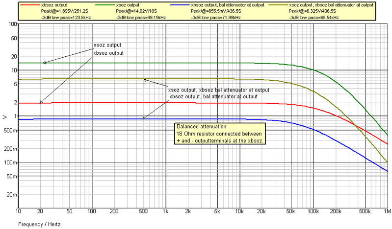

The xsoz isn´t like most poweramps. It´s not trivial to keep it right on track, the highend rolloff is the big challenge to keep alive, it has to do better than -3db at 100kHz. The sound is degraded already when its highend roll off is -3db at 80kHz, I have tried a lot of times.
I have attaced a graph showing an 7 db attenuation done with a resistor at 18 Ohm across the + and - terminal at the xbsoz output.
This is quite a normal listening level with my speakers in my room. And it is obvious why this dosen´t sound good, we are down -3db at 65kHz at the lowpass at the output of the xsoz.

Hi again William.
I have worked a little more with your idea with an attenuator at the output of the xbsoz, and I think you are right after all, it might be done, and it´s easy to try in real life since I can try it outside the box. But the values of the resistors in series with the signal has to be as low as 56 Ohm, and for 6db attenuation the resistor across + and - has a value of 220 Ohm. At this attenuation I can keep the lowend roll off at 100kHz. I haven´t ben looking at the open and closed loop gain in the xsoz, but I believe they should keep the ratio. I will find out later.

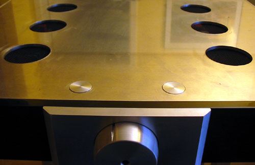

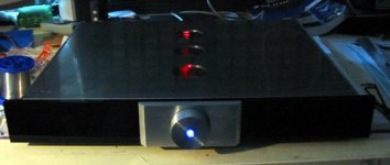

more observations
after drilling some holes in the top of the preamp and power supply I can leave them on permanently without worrying too much about overheating, fire etc.

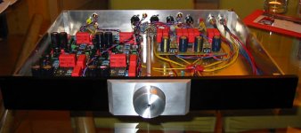

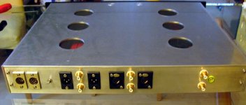

on the back there is a 230V input on the right with switch and fuse. On the left are the two XLR-connections to the preamp. One 6- and one 7-pole (so I don´t feed +-60V to my ONO). The 6 pole feeds power to the X-BOSOZ, the 7-pole to the ONO. Plus, minus and ground are seperate for both channels.
and this is the preamp without the top. On the right is one veroboard holding both x-bosoz channels, on the left are the two ono boards. All the ground connections are connected to the case at one point ( 4 grounds from the power supply, 2 from the x-bosoz, 2 from the ono, two from the inputs and two from the outputs plus grounding for the tonearm).
At the back you can see the Elma 24pos switch used as a balanced output attenuator.

Which part of your preamp reaches 43 degree C?

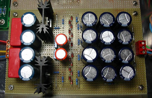

I can´t see your output fets on the photos, are they mounted under the veroboard at the bottom of the housing?

yes the fets are below the board mounted on the bottom of the case. Temperature is the same all over the case (after a few hours). Total dissipation in the preamp should be a bit over 40 watts (not measured it yet) so a high temperature was to be expected.

attached is a picture of the x-bosoz where you can see the holes for the hex-key to fasten the fets. (picture was taken before I doubled up the output caps)
