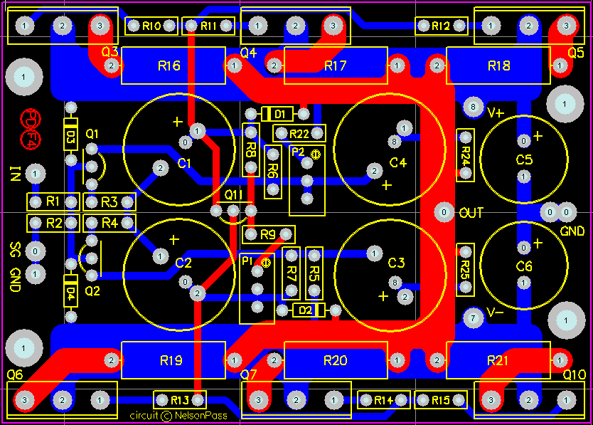

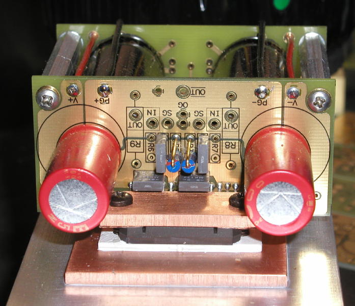

This is the new layout with latest upgrades. If you see any errors, please point them out.

Hi Peter,
thanks for your excellent work! The pcb looks really beautiful, clean and optimized.
Just one item: I guess it is only possible to mount resistors with miniature footprint to this board, do you see there any change to enlarge at least the footprint of resistors within signal path to regular size? e.g. to experiment with some Dales or others (in horizontal position)?
Again: Thank you for your great work and the effort you put into this project!
thx, Michael
Hi Peter,
I compared the layout to your previously posted version and noticed that the additional buffer caps between +/- rails and gnd (C9,C10) are gone.
I know that they are not drawn in Nelsons original schematic,
but i like this idea very much.
Do you think it is possible to include them again, maybe with smaller footprint to fit to the board?
-> just a thought, sorry for being a nuisance...
thanks again, Michael ;)
It may not look like it, but the resistor footprint is for Caddocks MK132 or S102 Vishays. The miniature resistors from Digi Key (Phoenix, Panasonic) will fit here as well and if somebody wants to use Dales they will fit also, although vertically only. Placing them in this way shouldn't cause any problem, and I've been doing it for years with my LM4780 boards. I checked already for bigger size footprint possibility, but there is enough space only for ressitors, so I don't think it's worth to bother.
Adding additional bypas caps on board should not be a problem.
