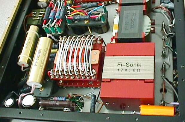

I buy or trade. My friend designs and sells. One of the people that built an amp my friend designed wound his own opts by hand, using perfect lie (every layer is wound in the same direction). My friend reports it sounded wonderful.
There may be more to this hobby than arithmetic problems

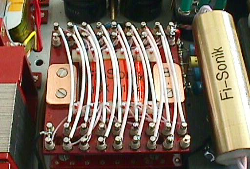

Almarcy,
I wonder if you could get close to the same results by just winding the secondaries in the same direction. Winding all of the primaries this way and attaching the connecting archs would be tiresome indeed. That is quite a lot of soldering on very fine wires. As I posted before there is a real nice example of this type of transformer on the One Electron site Randall museum page.
