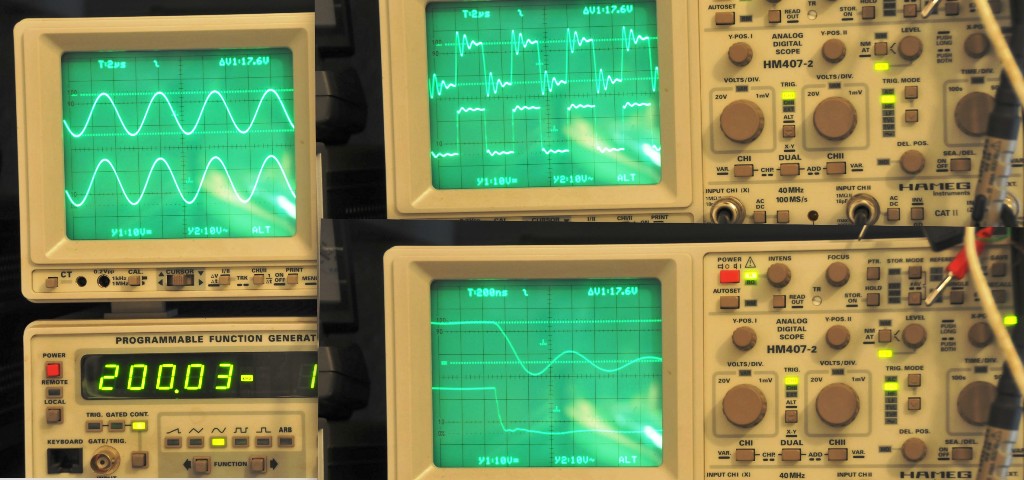

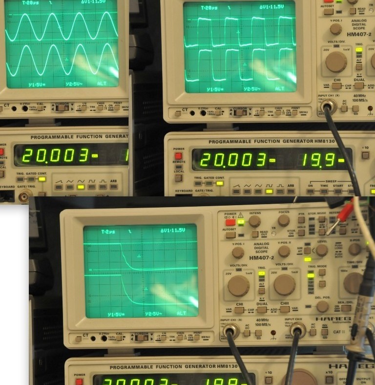

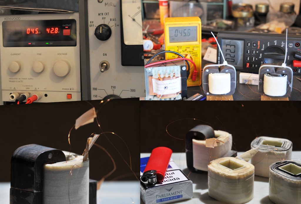

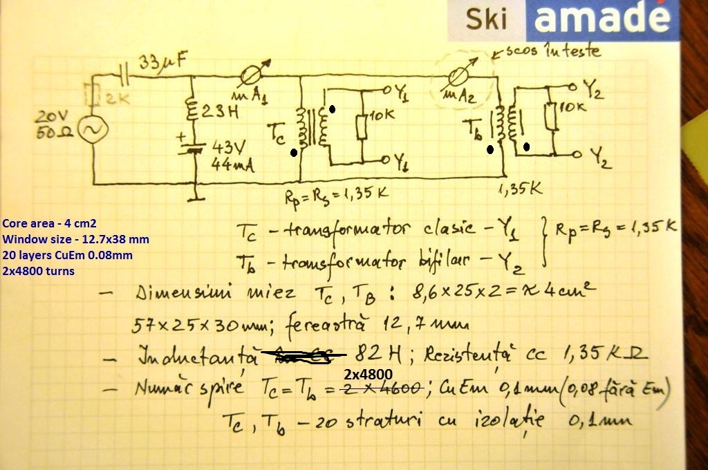

I've not seen yet much about a DIY interstage, so I attach a comparative test on a (same) 2x2 cm double C-core wound core as follows; Y1, upper on the scope, is an inverting 1:1, let's say, 10k:10k interstage transformer and Y2, lower position on scope, it's a bifilar wound bobbin having exactly the same wire and turns as the previous one (2x4800 turns, 0,08mm). In each of the primary windings there is a 22mA DC curent. Source impedance is ~2k (50+2k resistor), secondary load is a 10k resistor, test frequency 20kHz, 19.9Vpp.

Hy Tyimo, I've mentioned in the sketchy drawing that the insulation is 0,1mm (with a secret touch) in both cases (though, not a reason to learn Romanian language). This is an "internal" test, I wonder why I put it here ☺...
I wait for BudP's, Yves's and (many)Somebody's opinion before saying that interstage are not good for coupling... I recall such a statement right in this post ... cheer up! go on, challange me!... it's springtime!

Tyimo hi,
Overvoltage is not my concern, you can choose anytime higher insulation grade for the copper wire; I believe there are 3-4 classes of insulation (depending on continent, no kidding). No, the insulation is for dealing with capacitance inter-layers and for having a smooth and firm surface for tight winding.
I don't know what's "transposed bifilar winding", but this doesn't mean I didn't use it ;). The bifilar bobbin is wound very near to "normal", with a gentle personal touch. The inverting bobbin, for A2 dreamers, it's other league, very personal method, but let's say it's more like classical...
Dorin
Actually (or funny enough) the cores were rejected 30 years ago by quality control for not having the physical dimensions in a given range. A wise engineer put the cores aside, about 50 pieces, and he gave the whole bunch to me last year, when the comparativ test was conducted.

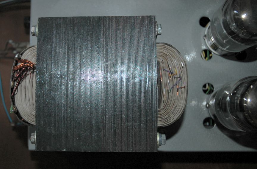

I have wound a few drivers and outputs. Output I use 13 windings. 7 secondaries quadrafilar for 4-9-16 ohms, can be done easier if only wound for 8 ohms. Most were 3 layers for each winding, and a lot of insulation. Wound by hand for almost 98 % fill. No fancy cores, just recycled scrap ones. -3db 7 cycles to 50Kc for this one.
S-1
A-3
S-2
B-1
S-3
A-2
S-4
B-2
S-5
A-1
S-6
B-3
S-7

Hi fooeywuffle,
your winding pattern seems to be basically similar to mine (#195), but, of course, in a much more elaborate and sophisticated fashion. Great!
The conclusion of your tetrafilar secodary winding is that you parallel one wire of each of the seven segments, i.a. seven wires in parallel, leading to four 1 ohm packets, and arrange these to get those three impedances, isn't it?
