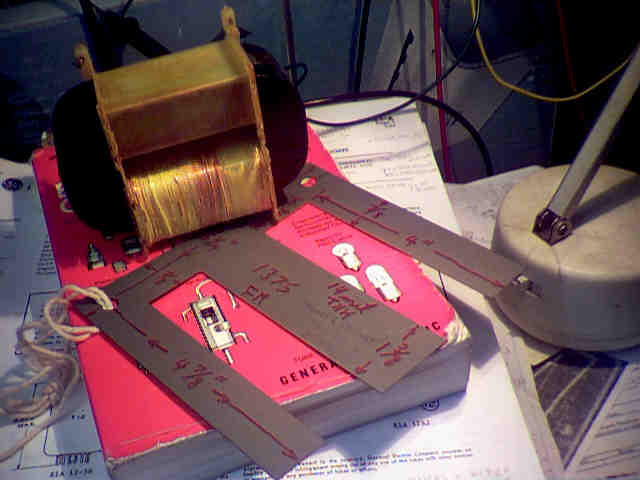

i am toying with the idea of cutting off about 0.25 inches on one of the E's on a 1.75 inch center leg lam, so that stacking them is easier....

The double E core that Tony mentioned above uses special long E laminations (some outfit in NJ, had the patent I believe) with an (at least) double width back side to the E's. The opposing E's then get pushed all the way together without I lams. The back side will have somewhat reduced permeability compared to an I lam due to it's grain orientation. But the double E scheme does not suffer from a sudden drop in permeability when the flux reaches the 1/2 max point, where it would normally have to suddenly jump the E-I air gaps in an E-I setup. So the double E version is more constant permeability than E-I over the full flux range.
One could, I suppose, use I lams with the double E setup by using a normal stacking that leaves room for the I's. Then the benefits of both could be combined.
The main benefit is from using long E's, in either case, since they reduce leakage inductance considerably over scrapless E-I's. There are long E lams still commonly available (but without the doubled backside, see image attached) for constant voltage transformers.
Using the long aspect ratio Es is definitely a good way to help cut down on leakage. I use this dodge often with the right shape ferrite cores for SMPS transformers. Using a somewhat oversized stack to get the turns down also helps. Some people try using an undersized core and pile on the turns to compensate, and wonder why their transformer doesn't work all that well....

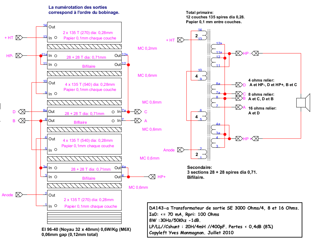

Hi there,
Here is a secondary arrangement which allows 4 or 8 or 16 (more exactly 4,9 and 16) with no compromise -understand: "using all the wire anyway".

Hi there,
Hi Yves,
With this arrangement you effectively keep the B+ (which is ground in AC terms) and Loudspeaker Minus at close distance, which is good with regard to capacities.
The same for Anode connection and Loudspeaker Plus at the inside of the coil, closest to the core.
When I look at your secondary sections, they are each two layers, and each layer is bifilar wound.
So actually there are four 1 ohm sections within each of your three "two layer bifilar secondary" sections (four isolated windings of 28 turns).
This means that you could make the 4, 9 and 16 ohms arrangement also for each individual secondary section, and parallel these three sets of arrangements.
In this case B+ and anode connections are more spread over the coil with respect to the loudspeaker connections, which is different from your arrangement.
Did you try this?
When I was experimenting with these possible arrangements I found somewhat better HF frequency bandwidth with the "parallel" approach despite the series connection being better in theory because of less capactive coupling from ground to signal (but it's been quite a while ago so my memory is not 100% reliable ).

Hi YvesM,
when i found your OPT arrangement with 6 ohm only secondary, i took it to mean that is can be used for either 4 or 8 ohms,was i correct in assuming that?
tony
Hi Peter,. . .
Indeed, the 4 by 1 arangement is by no mean a novelty, I've just "prewired" to reduce the number of terminals from 8 to 6 as well as the number of jumpers to move
Duh? Try ... what ? Please explain differently.In this case B+ and anode connections are more spread over the coil with respect to the loudspeaker connections, which is different from your arrangement.
Did you try this?
Yves.
Hi Peter,
Yves.
In your arrangemant you have just one Loudspeaker Minus terminal, which is close to B+, and also one Loudspeaker Plus terminal which is close to the anode terminal. That predicts good capacitive behaviour.
In the parallel arrangement (by making 4, 9 and 16 ohms within each secondary section there are three instead of one loudspeaker minus terminals at the coil, spread evenly over the coil, and also three loudspeaker plus terminals, also spread evenly over the coil.
That differs from your arrangement, of course also in capacitive behaviour.
Indeed 8 terminals are required for loudspeaker connection.
I was curious if you have tried this arrangement also.
