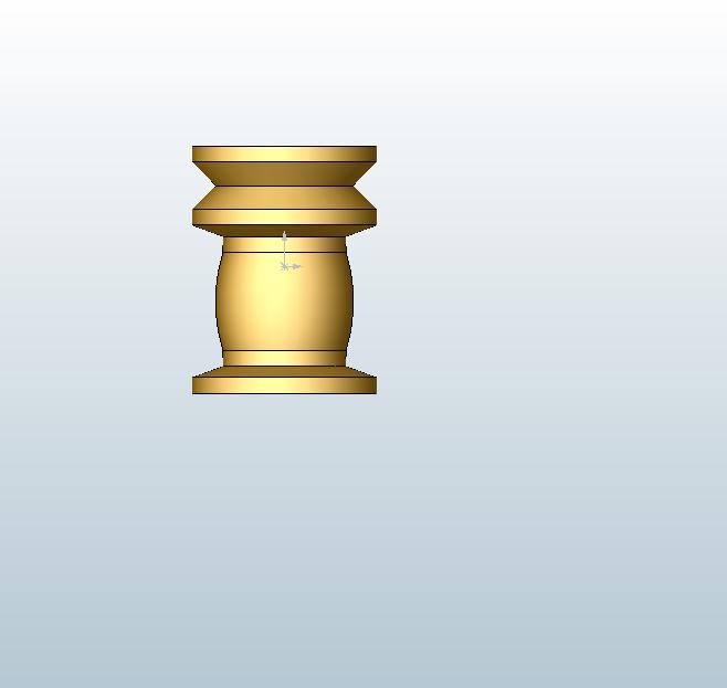

DaveM said:Here is design idea #1. This should work for everyone. Although it may not be asthetically what everyone wants. Please give me feedback.
Dave
I'm not sure that the pic will post, but I am trying.
ok this will work for tape too just make sure it is at least 7-8mm wide.

DaveM said:What are people's feelings about set screws or not. If people are happy with using thread lock to hold this on, my life will be a bit easier. If we need set screws, I will find a way to make that happen, but the cost will jump as payed labor will now be involved.
Threadlock would be fine, just as Bobken suggested. The pulley would be easy to mount, without using excessive force.

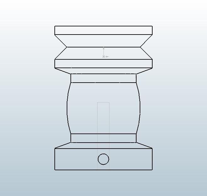

Here is an updated design with a 12mm tall portion for the flat belt. The original was almost 17mm tall. If more is needed let me know. Also all of the flat porions are 2mm. That includes the flats on the top and bottom of the belt portion.
Does anyone have a suggested diameter for the crown needed for the belt? I don't have a flat belt to play with and have no experience with this.
Dave
Dave

Something like this?
This makes the bottom flange 5mm so a 3mm or less tapped hole can be made there if necessary.
I will need to do a collection of names and finalize how many of these I will be making to get an accurate price quote. So, If anyone else is interested let me know soon. I will order up the required tools and get ready to run these.
DaveM
