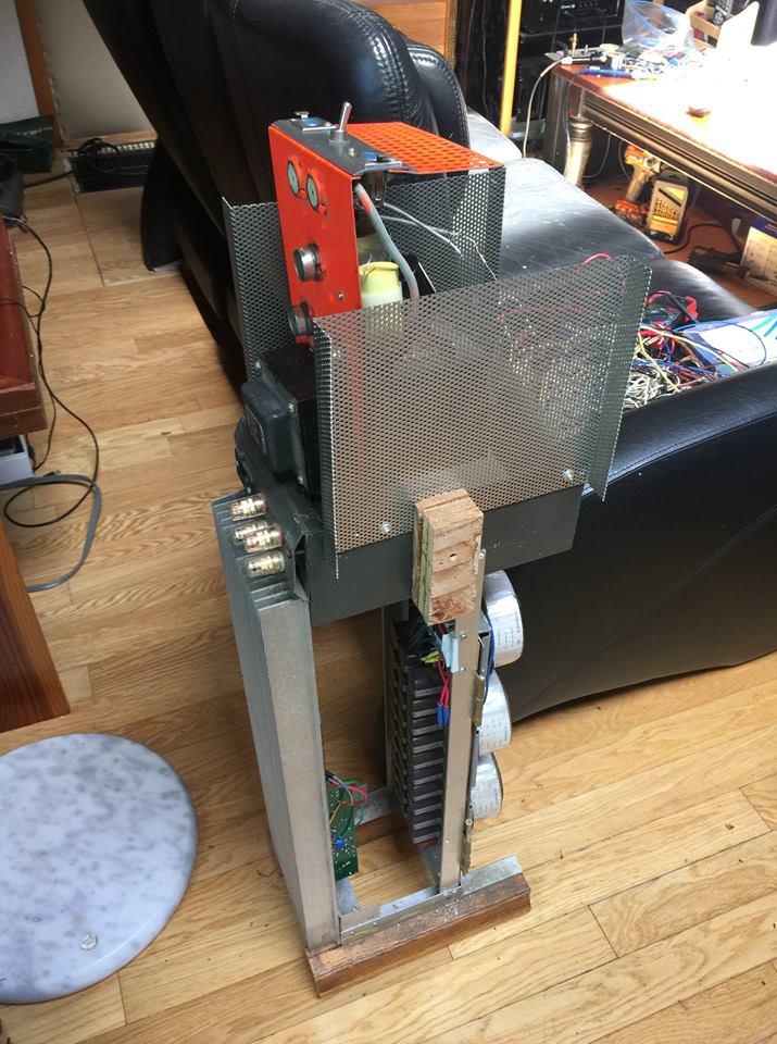

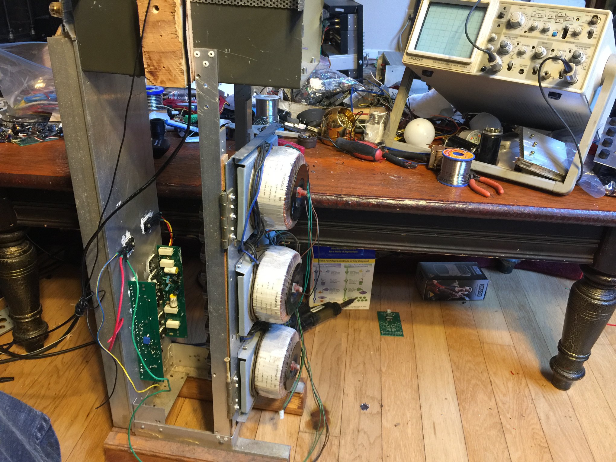

My OTL amp.
But if it works.....I'm interested in more details of what you used!
Here is a discussion about simplified version, that has a link to the previous thread.
Modified Wavebourn Tower II ?
That's cheating!

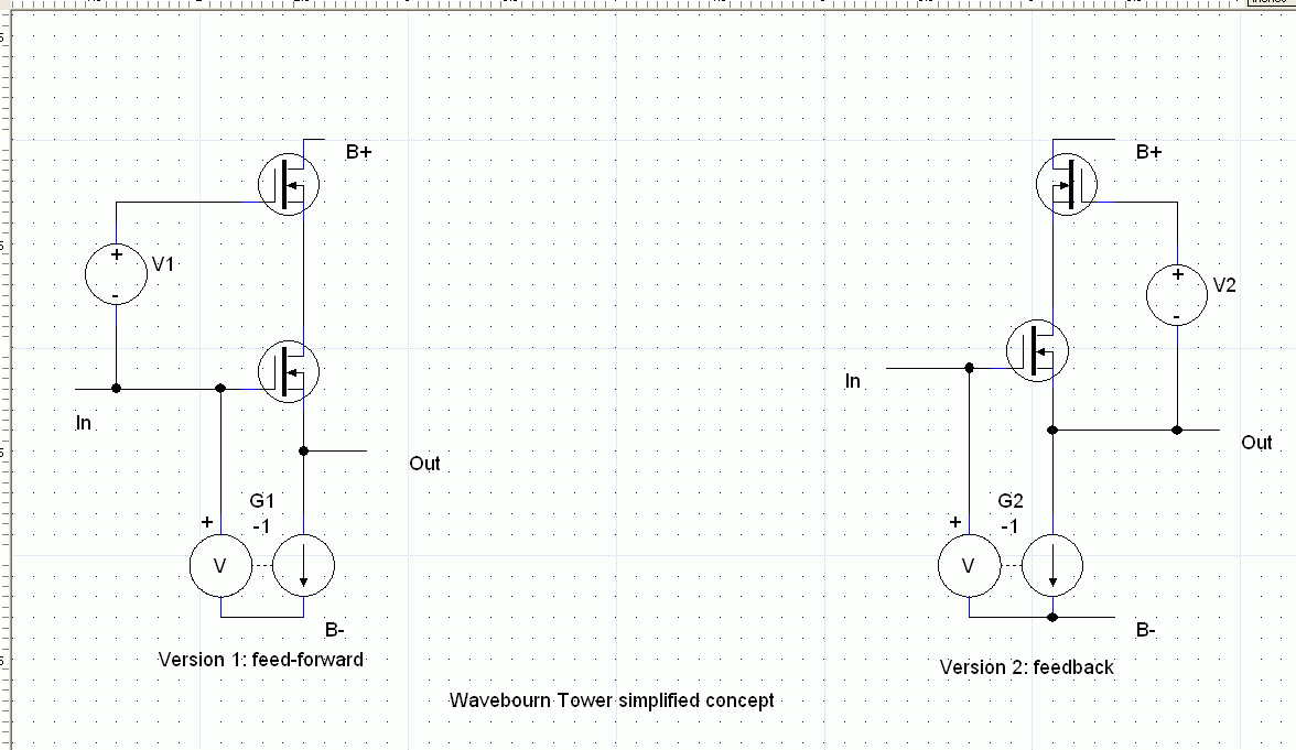

Well, a source follower sounds better or the same as a cathode follower, especially, when loaded on a CCS, even if it is modulated.

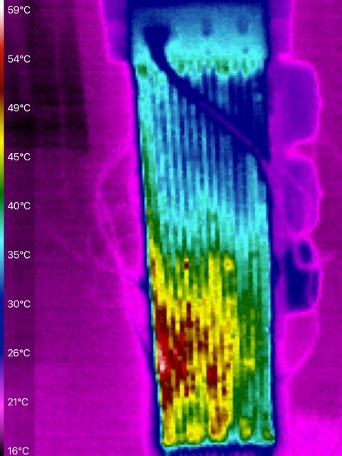

However, it does not glow (except in IR, attached) But driver tubes glow. 1x6N1P and 2x6P15P

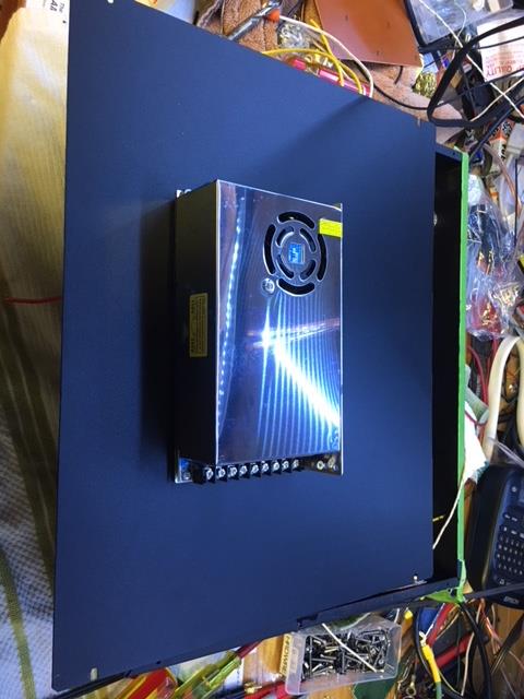

Can you flick up some details of the SMPS you used for the heaters please?
Do you mean for GK-71?
I used some industrial 24V SMPS retuned to 20V. I found it in my barn, bought about 10 years ago.

Tubes are heated with an SMPS. That's a common mode choke to get rid of any noise. There are a couple caps under it too. Amps are very quiet.
No, I was curious what SMPS he has used here.....
Thanks,
Drew.

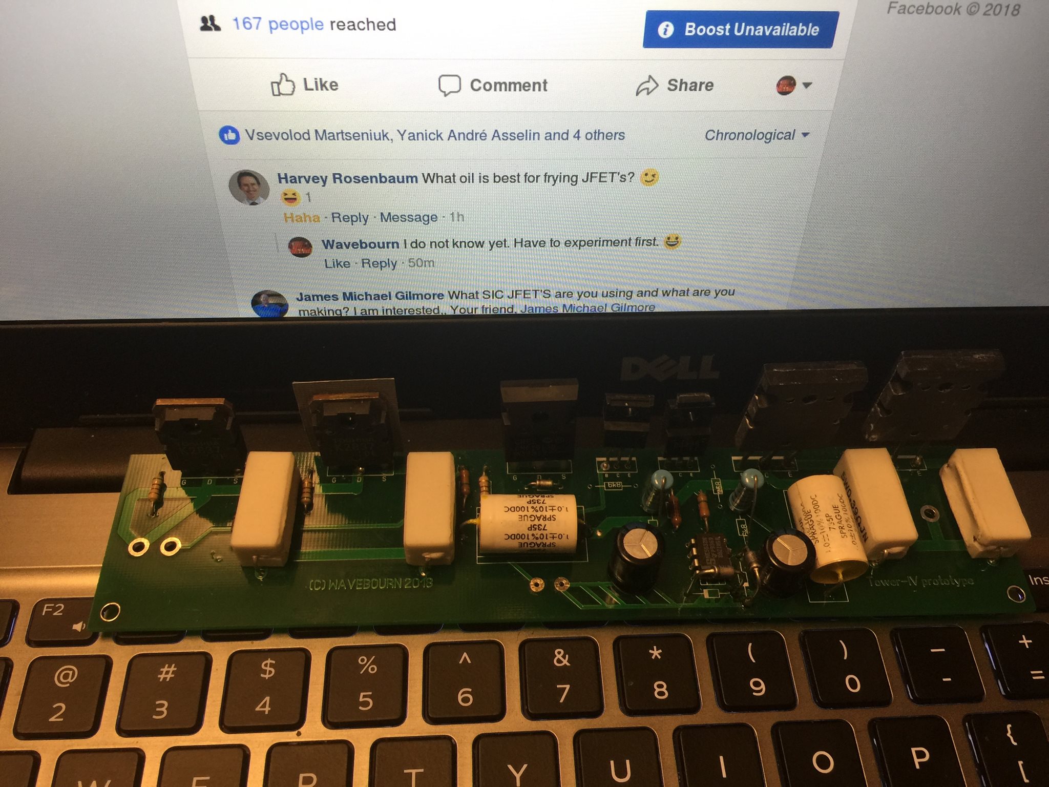

I gave up vacuum tubes in OTL amps. Here is a nice "tube" with 9A/V transconductance.
https://www.wolfspeed.com/downloads/dl/file/id/959/product/222/c3m0075120k.pdf
Wavebourne, That's some cutting edge stuff. Way above my pay grade. I use silicon carbide materials every day at my job but don't think I can make an amp with it

Hi Drew, SMPS is a 12V 20A fleabay special. Output (6N13S) tubes are connected series-parallel so they draw around 12 amps. Small tubes are 12SN7GTA's which are much cheaper that the 6SN7. The SMPS has very slow start up which is easy on the heaters. I've since cut ventilation holes in the bottom covers. Also cut a hole for the ps fan and flipped it over to prevent it from just circulating hot air around inside the chassis. Ralph (Atma-Sphere) deserves all the credit for the circuit. It's amazing. Class A and no feedback.

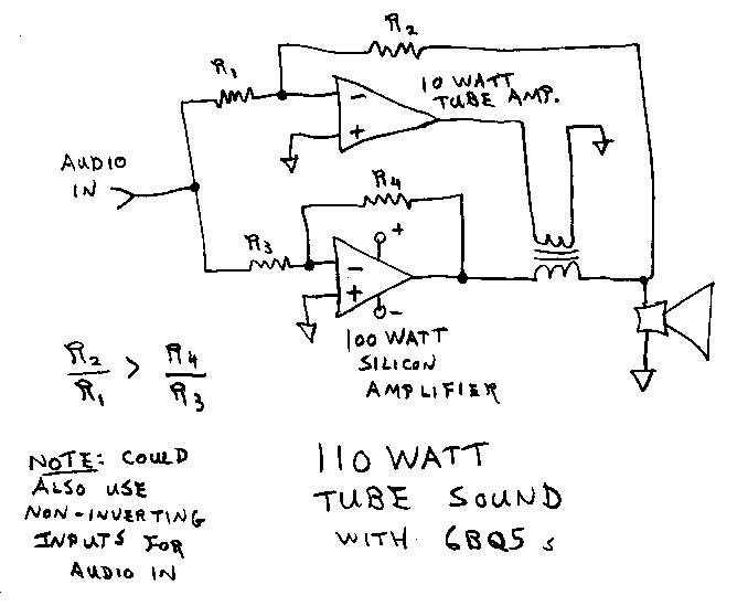

If you can use a SMPS for power, why not use a SS amplifier for power.
Take any SS amplifier, and run the a speaker line through a big current xfmr toroid (a few turns, or use a typical HV to LV power toroid ). Then your tube amplifier puts the final finish on the voltage waveform. (a Tube Veneer Amp)
It's actually equivalent to a class G or class H amplifier, with the big amplifier supplying the variable tracking B+ power for the small amplifier. The small amplifier operates with just small voltage changes across the tube (from the supplied tracking B+ from the big amp) to finish the waveform.
The OT for the tube amp is very low Zout, so the small tube amp can supply the same big current as the big amplifier. Just making small voltage variation, to set the final distortion profile.
The tube amp can run class A for final purity, while the "supply" amp can run class aB for efficiency. Or even class D. You want beam pentodes in the tube amp so that the final output is isolated from the "variable B+ tracking supply". Same as any class H amplifier. (tracking supply to the output device collector or drain typically)
The small tube amp actually uses a fixed internal B+ for the OT center tap. The tracking part of the class G or H is simply being kept to the LV side of the OT (but effectively in series with the internal fixed B+). So this is all
--very simple-- and cheap to build. With extreme fidelity results. This simple and cheap design can add tube sound easily to --ANY-- SS amplifier out there, or already in your living room.
