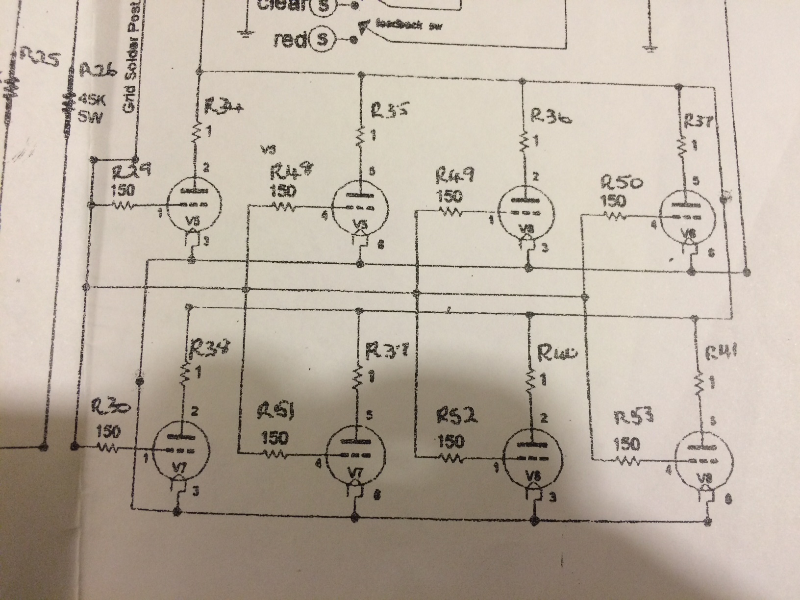

While assembling following one set of schematics i was supplied with a few parts i purchased i stumbled across the error on the output tubes....who can spot it? glad i sat down tonight to compare the Mk2 schematic that i had the the Mk2.3 i downloaded off here thanks to Ralph!

Ahh so i could have left it the other way! I purchased a box of parts that had those schematics included Ralph and and started working from them but after reading thru this forum found the 2.3 plans and decided to run with them, excluding the A/AB switch, i do have one question i cant find an answer for, and that is what value meter is used for DC balance? Getting closer to powering up and running some tests!
Team, some help please, have finished building one of these up, and i can power up, both power supplies working as they should, added tubes and then connected speaker and a source but i only get a very faint output when the input is at full (2v) have double and triple checked the schematic and cant see anything i may have done incorrectly! Any pointers greatly appreciated!
Fabio
Check for correct conection of two floating power source to Circlotron OPS , maybe there is problem ,
top basic schematic show usual incorrect connection , and bottom basic schematic is correct one .
Thanks Banat, I have double checked that and all connected correctly, I have 160v floating supplies and the other supplies is 350v and 325v tho the negative supplies are both -350v so don't know if that would make any difference? And one question for a newbie, does it make any difference in the way section one or two of the valve are connected?
