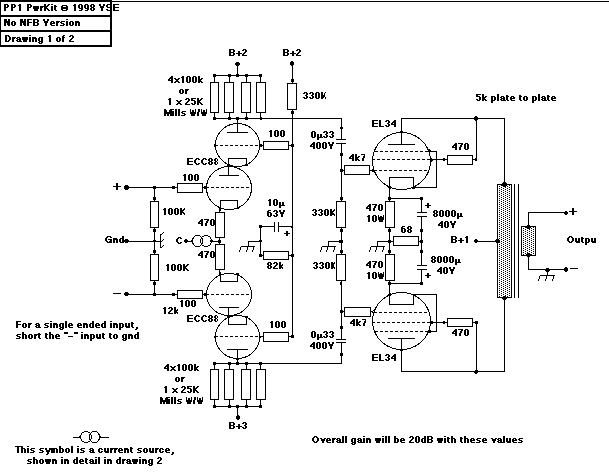

Always looking to be more Zen. Would this driver stage work? And how many tubes could it drive?
That driver stage could work, though the capacitor coupling can mean troublesome overload characteristics. The ECC88 is a stiff, high gm, type that can operate at lowish Vpk's and still pull some decent currents. It should be able to keep up with the Ci of the finals, especially if you're using pents as these aren't hard loads so long as you stick to Class AB1.
As to how many, that depends on the type and operating conditions.
Thanks for the replies. I am looking for a two tube solution instead of the 4 6SN7 used in this OTL. My OTL idea here is for two ouput tubes per channel at around 20 watts.
One other choice is the 6H30 "super tube". Or really a 6DJ8/6922/6N1P on steroides. In a similar driver circuit. That could be even better?

Not so much of a "designed for audio" thing, but rather one of overall quality. There are a lot of cheap tubes out there. The same applies to 6BQ7s. The ones with the heaters connected in parallel are not microphonic to any annoying extent, but the cheap ones where the heaters are in the form of one continuous loop with a thin strand that flares up when you power up, ring like bells. (I avoid buying 6BQ7s sight unseen for this reason: I'm looking for parallel heater types.) These are just plain cheap tubes made by those who "thought" that ringing at 1500Hz was NBD for a tube that would most likely find itself in the first VHF pre in a TV tuner. Even that isn't right since the disturbances of microphony can cause detuning of RF circuits, and you definitely will notice that, in both sight and sound, in a TV set. Especially the ones with the old timy, click, click, click tuners that send lots of vibration into the tuner subchassis to make poor tubes ring.
