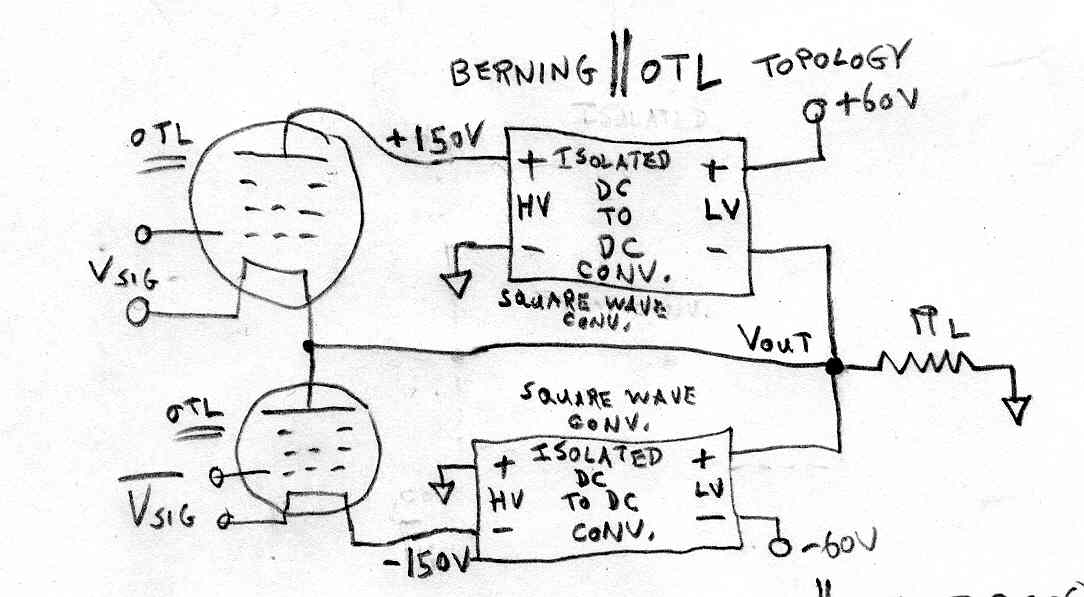

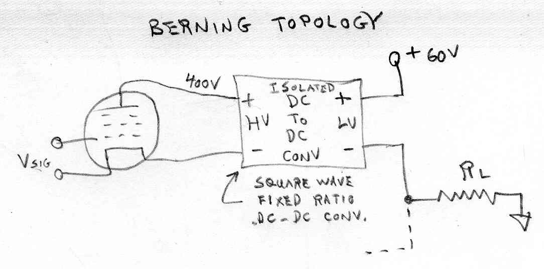

Just to clarify what the scheme is, some pics below of its derivation. First is the "simple" Berning "impedance converter". Just a fixed ratio DC to DC square wave converter. One used for the top P-P tube and another used for the bottom P-P tube (not shown). The load is driven by the converter LV side currents.

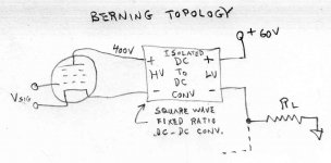

Next pic is the Berning scheme extended to include a parallel OTL setup. Since the tubes can handle direct load current, might as well use both tube and converter currents (they are directly proportional via turns ratio in DC to DC conv.). This is still using a fixed voltage square wave converter. Typical +/- 150 V supplies for full tube range operation. This will still make for a lot of heat, but the converter currents can reduce the # of tubes required by 1/2, so 1/2 the heat.

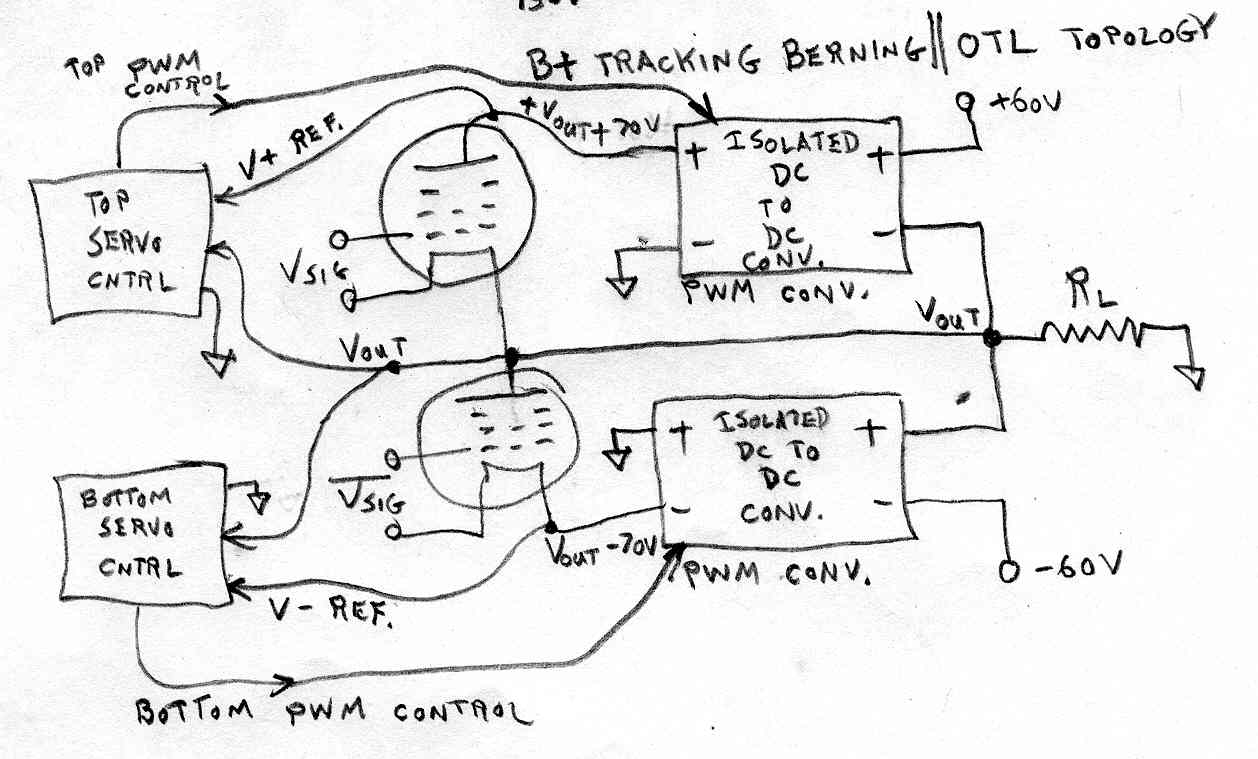

Finally, the tracking B+ Berning converter with parallel OTL setup. This now uses a variable PWM converter(s) instead of square wave type. The servo controls maintain the conversion output voltages at Vout +/- 70V, so the tubes operate with minimum voltage drop at all times. This should significantly reduce tube heat. The converter currents aid the tubes still.
After sleeping on this I realized that the variable tracking converters now also vary the converter current versus tube current as a function of the servo controls, since the DC to DC conversion ratio can change. Fortunately this variable ratio converter current increases the aid to the tubes when max output power is developed. So the tubes can be even fewer now, maybe another 1/2 as many. Heat developed should be quite reasonable now, since they also always have minimal voltage drop across them too. Probably needs to be modeled, but basically it is just making the tubes have a more aggressive "effective" gm curve. Considering that pentodes are already being used, some local N Fdbk is going to be called for, similar to CFB.
But now it is apparent that a simple PFC module won't work for the bottom converter. They have a direct connection from -LV in to -HV out. We need isolation there. So a true ferrite xfmr isolated converter will be needed.
Without the off the shelf PFC modules, this looks rather more complex to design. The PFC modules could still be used for a conventional Berning only type setup however.
Hmmm, late edit:

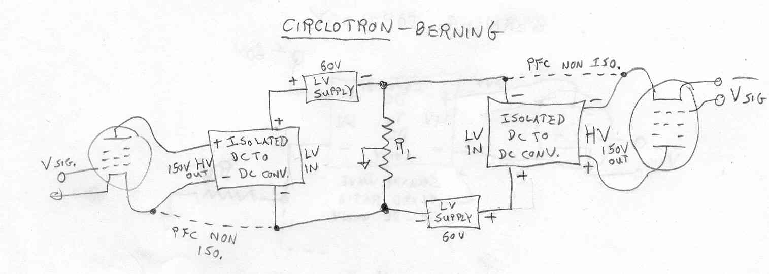

If the LV supplies are floated on Vout (like a Circlotron), the PFC converters should work, and the top one automatically adds 70V to Vout. No servo control needed! Woww! Even a square wave DC to DC conv. would work automatically then.
From impossible to trivial. Not sure about the bottom one yet, but looks like the PFC could be used then. OH, wait..... But then the LV side current doesn't add to the tube current for driving the load. It's isolated from the load then. Some more thinking required on this. Well, that should make the tube only fans happy I guess.
Yeah, just need some off the shelf 60V to 70V, or so, DC to DC converters, using floating (on Vout) +/- LV supplies to drive them. No servo needed, the internal constant V servo in the converters is already doing the job for us. But no LV current assist helping to drive the load then.
Rats,
the typical DC to DC converter regulates with respect to the (-HV out) terminal, not to the (-LV in) terminal. So the servo issue still needs to be addressed. Although hacking into an isolated converter, one could change the Vref tap point I guess.
Need (+LV in) connected to (+HV out) for the bottom side and (-LV in) connected to (-HV out) for the top side. Well, an isolated DC to DC conv. can still do that.
Those PFC modules already connect (-LV in) to (- HV out). Well that works for the top side at least.
A square wave isolated DC to DC conv. needs less filtering caps. Simple enough to design those. Once you have that designed, it works for either top or bottom. However, square wave converters are not generally regulated, just depending on the low resistance of the ferrite xfmr windings.
Argh! The HV to the tubes still need to be connected to output ground for the tubes to drive anything. So the +/- HV supplies really will have to be changing in magnitude. Constant isolated V converters -won't- work. Servos back in again. Back to the 3rd pic (above) again.
More thought needed on this obviously.

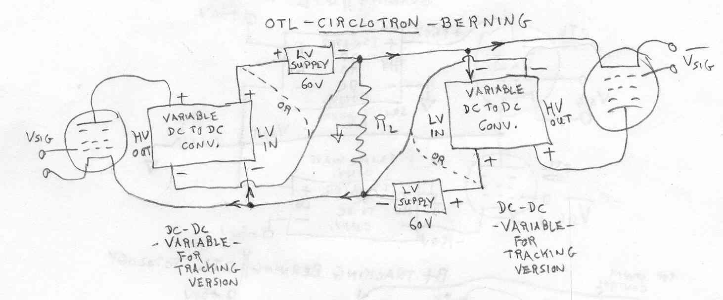

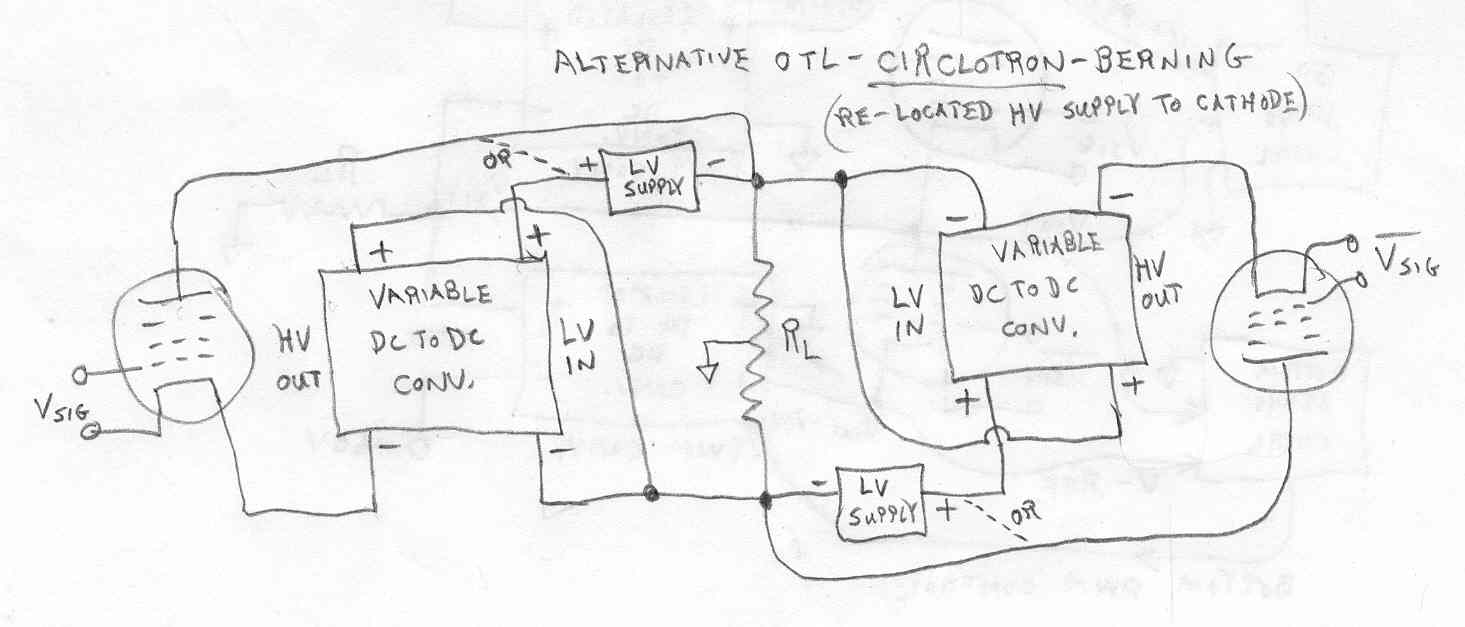

So, I re-thought the idea starting with "Circlotron" in capital letters.
1st pic is the conventional Berning "impedance converter", but using the Circlotron configuration instead of the normal totem pole configuration.
2nd pic is Circlotron Berning and OTL together, both in Circlotron. HV supply in the traditional plate position. (the OR connection variant is possible)
3rd pic is an alternative Berning and OTL combo, just moved the HV supplies to the tube cathodes instead. (the OR connection variant is possible)
What I notice is that pic 2 would allow -HV from the conv. to be connected to +LV of the converter. (the OR connection)
And that pic 3 would allow +HV from the conv. to be connected to the -LV of the converter.
The LV supplies could be moved around to the -LV inputs too, but seems a minor variant.
A converter that allows input side to output side connection, with sign inversion, is just an inverting class converter. (there are chip driven designs for these, using just an inductor) So this could be easily designed. Doesn't look like the PFC modules will work yet though.
There should still be another set of variants using Circlotron for one or the other (Berning or OTL) and totem pole for the other. I'll take a look, soon.
Trying to get -LV connected to -HV acceptable so PFC would work.

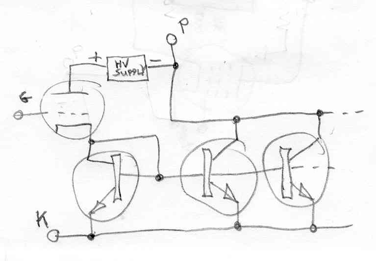

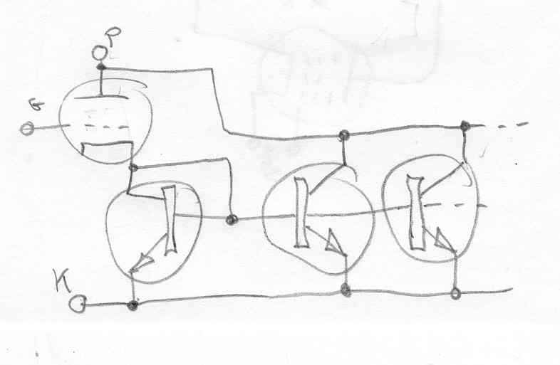

Something to sleep on:
The Tube_Mirror.
Sometimes absurdly simple is just so much better.
No HF, no complexity, no cost (hardly any), no Watts (greatly reduced).
An nX current mirror is attached to a tube. Whatever current the tube draws, the nX mirror multiplies that current by nX. So you can reduce the # of tubes by n.
With a floating +HV supply just above the tube plate (in series), the operating voltage of the apparent mirror assembly can be reduced down to a practical 60V for driving a speaker efficiently.

That is intriguing.
Would you still run it in a Circlotron config?
Which devices are you thinking?
Simple is nice...... PET240
The Tube Mirror scheme could be used in either a Circlotron or Totem Pole design. (or even for a P-P OT) It is a three terminal device, just like a tube.
Maybe use something like MJL3201A, lots of possibilities. Probably transistors with near constant Beta would be good. The IC circuit type current mirrors need matched devices, but for discrete devices one can roughly match them up and then put some 1 Ohm or similar emitter resistors under the transistors to match them up near exactly. Like when Roman Emperor Anatoliy... I mean, when Wavebourn used this in 2010. :D
One can also use just two transistors, with different emitter resistors, to get a current ratio mirror that is nearly as good. (uses up a little more B+ window)
MJL1302A is the PNP complement to MJL3201A if anyone is thinking of carrying this mirror scheme further.
Some smaller bipolars for use with non jumbo OTL type tubes are MJE15032G (NPN) and MJE15033G (PNP). There may be be newer variants out by now too. Other voltage ranges too.
(MJ... were Motorola part #s, probably similar parts from other vendors.)
And if done in a Circlotron one would not need complementary devices true?
Right
