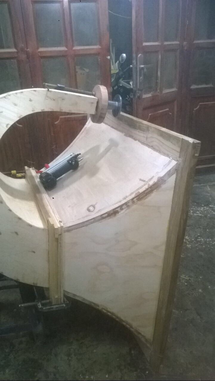

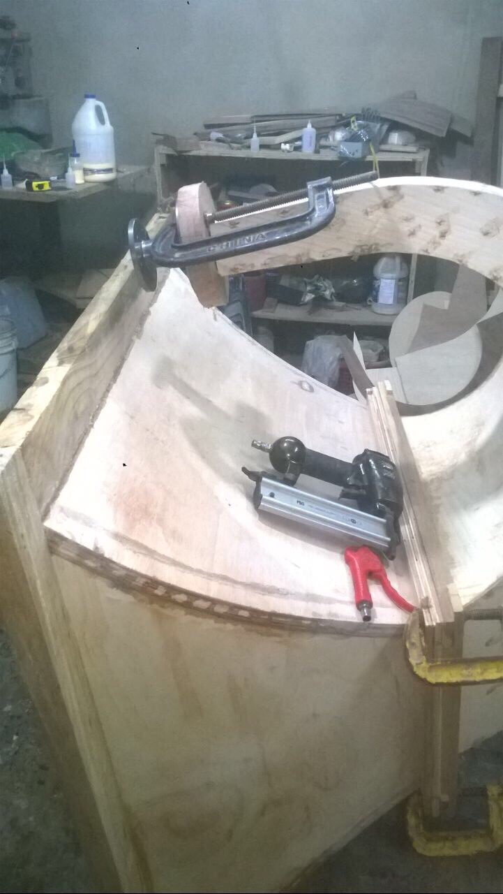

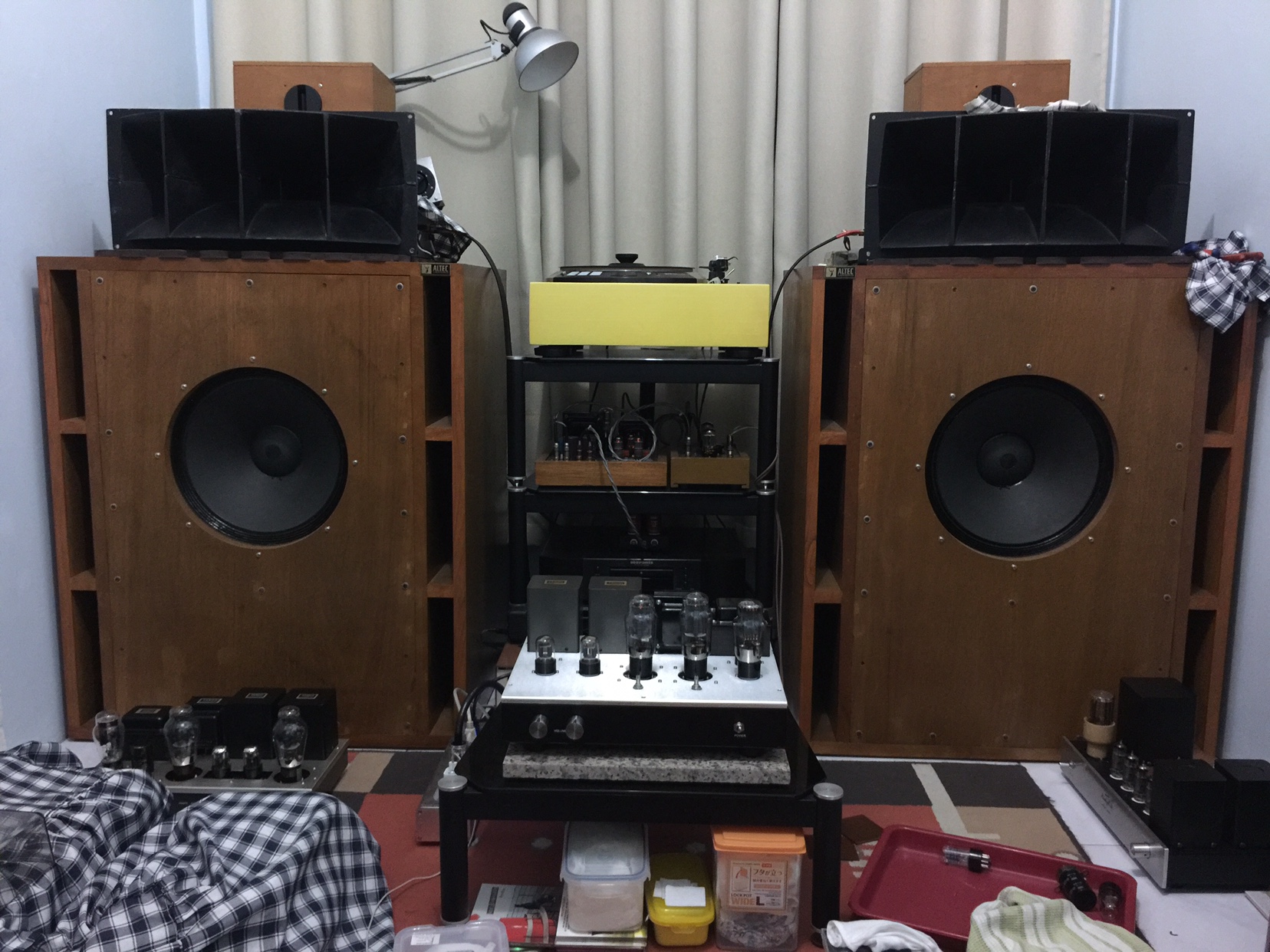

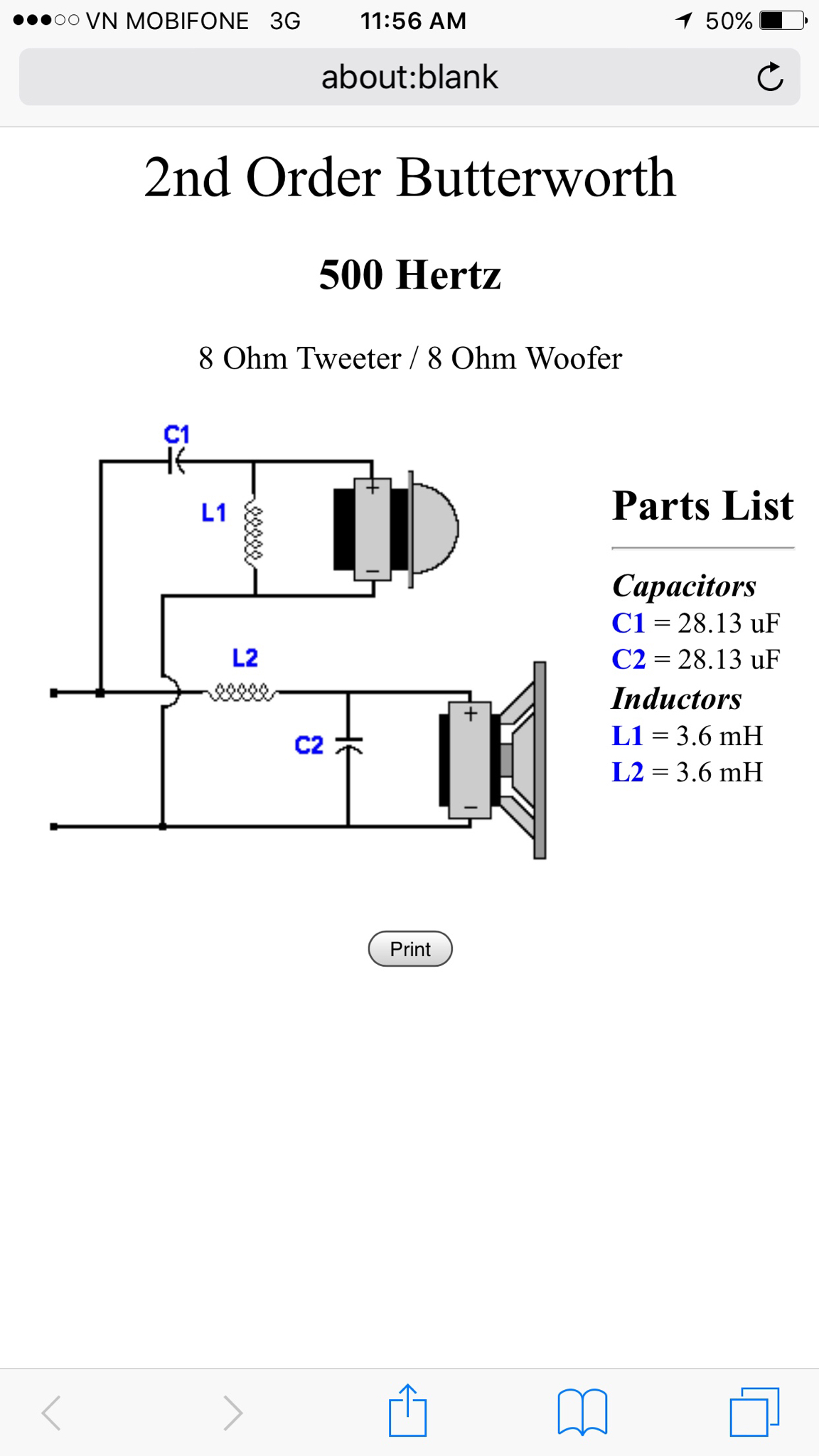

Ok, sorry for the confusion. because now i'm also dreaming to own 1 (sato horn) to replace my Altec 511B with 808 8B on top of my Onken 360L with Altec 416 8B crossed at 500hz.
The plan is just to replace the 511B horn with Small Sato horn and I'm going to use the Altec 808 8B with the same crossover.
Are you going to build the horn? There are drawings to get dimensions on line. I built a pair of Bill Fitzmaurice sub base horns, the mids sitting on top of the sub's are Klipsch LaScala's, the modified horns are from the LaScala's. This system is BiAmped through a crossover.
It will be interesting to know your thoughts when you replace the 511 horns. They are OK with a proper crossover, but I actually like the 811 better. That seems to be a rare opinion here on this forum. . There was a huge upgrade fro me when I went from the 511 or 811 to the multi-cell horn. Just so much more open and life-like there was no going back. But that was a different driver and different crossover.
When you go to the Sato horn with the same driver and same crossover, your tonal balance will shift, for sure. That may be good or bad, but it's a starting point. To get the most out of the combo, you'll need a new crossover. It will be interesting to know your impressions.
Hi Pano, I'm here again posting for some new experience on how far the Altec 808 8B can bring us. I already requested my friend who will build my sato horn to make the flange inter changeable to small & large format (1" & 1 1/4") as part of my contingency plan to try which CD compression driver will sound better with the Sato Horn.. I will let you know once I'm done with this project.
My current crossover
Yeah, not me. But i requested somebody to build it for me. [emoji3][emoji3]

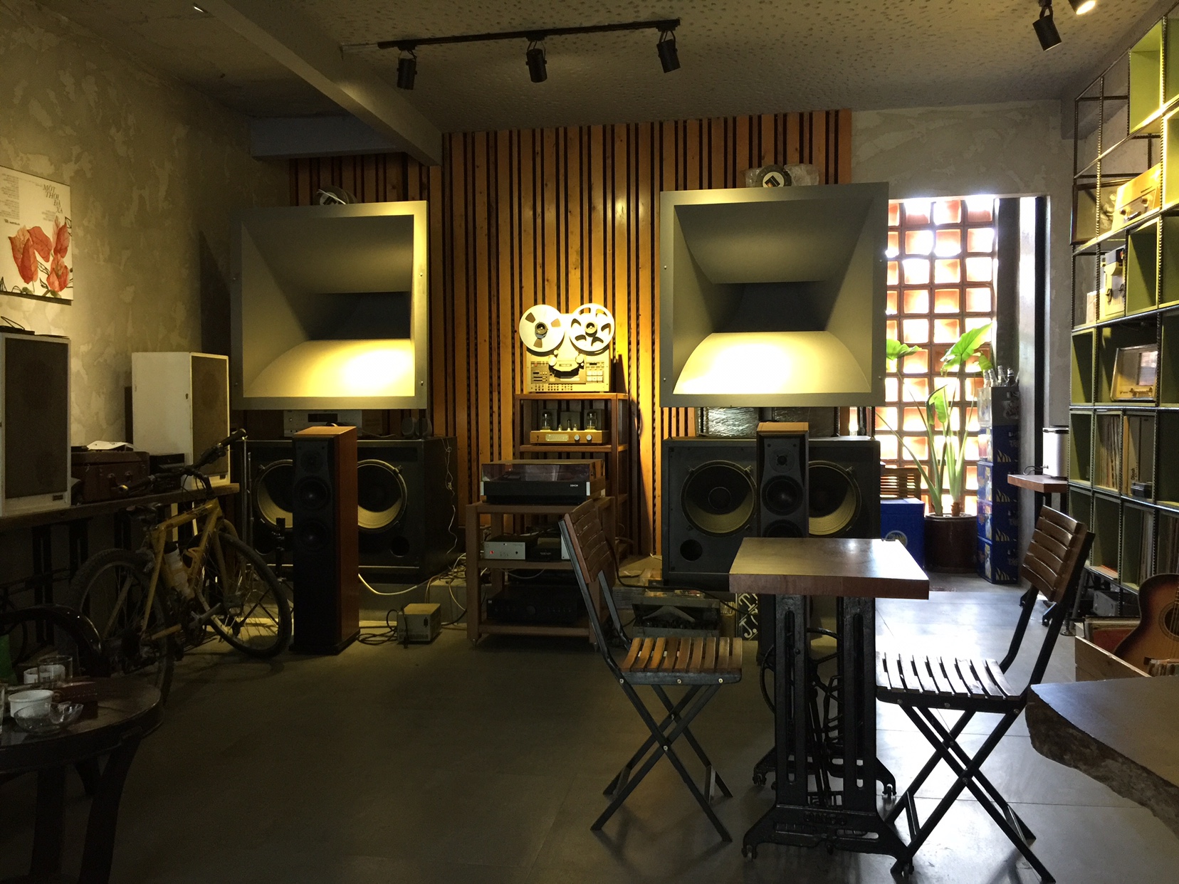

Yes you are right, that is an acoustic panel made from wood. That's how serious we set up our system here in asia[emoji16][emoji16]
Hey, nice photos! And there is a room that looks like it could have good acoustics.
